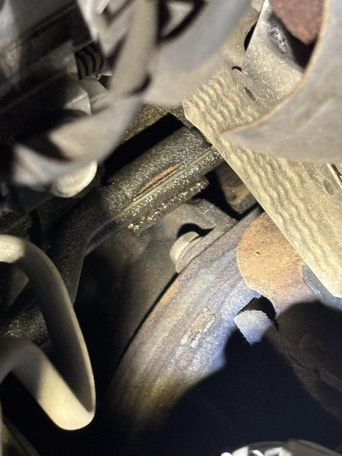

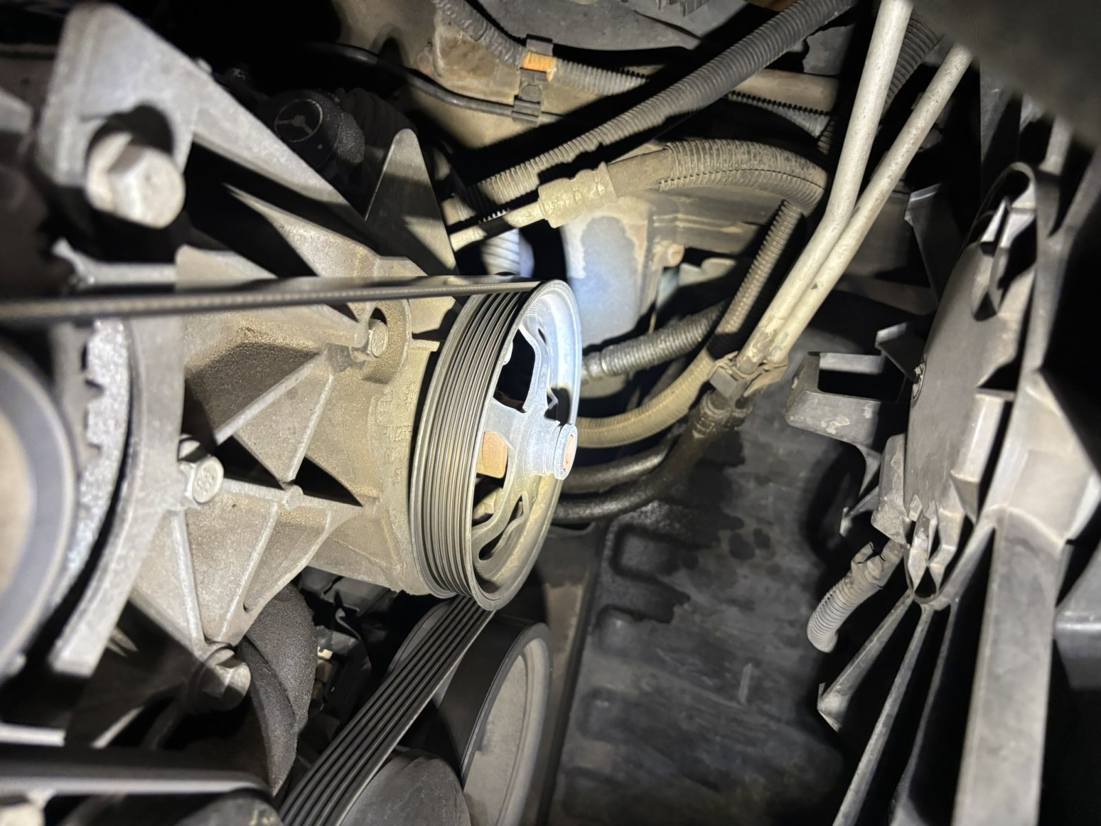

2014 Yukon has been dripping off and on for the last few months. I am pretty sure it's oil. Sometimes it doesn't drip, and it's a very small amount when it does. Here are a few pictures down into the engine but I don't really know what I'm looking at.

Looks like a power steering pressure line.

Or Oil Cooler Lines. both ps and cooler lines on the driver's side

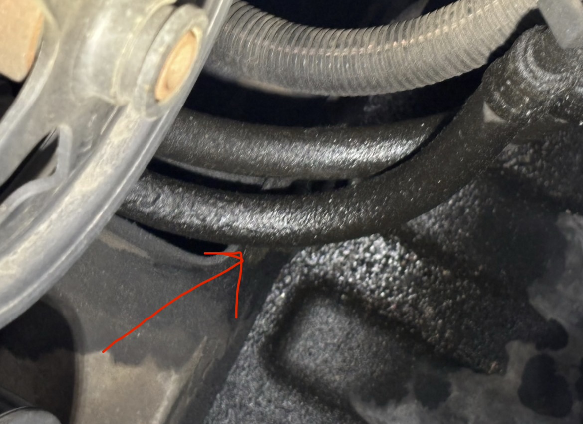

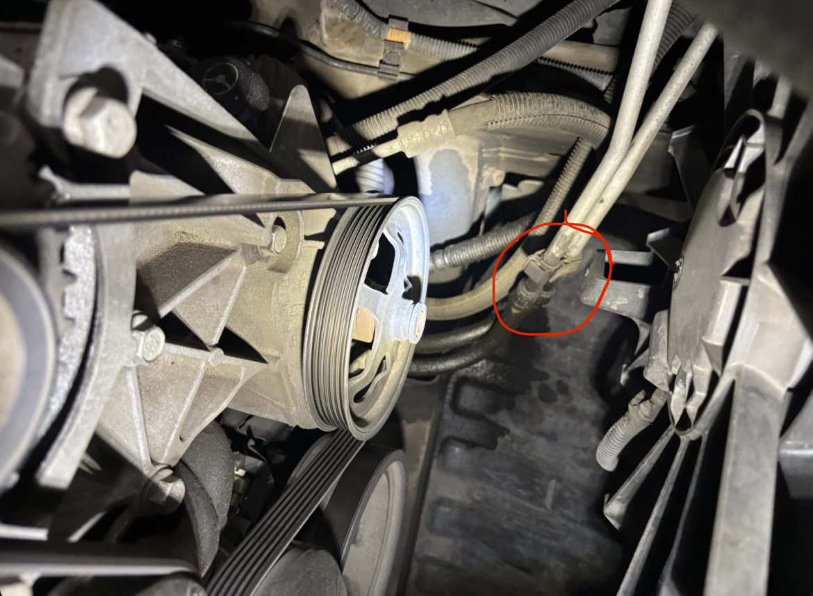

Definitely looks like the engine oil cooler lines just as @Foggy said.
The stock lines are known to fail right at the connections circled here:
You can see the oil seeping down the lines coating the rubber flex lines and dropping onto the black plastic skid plate.
