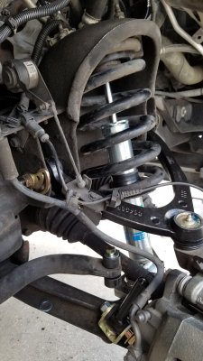

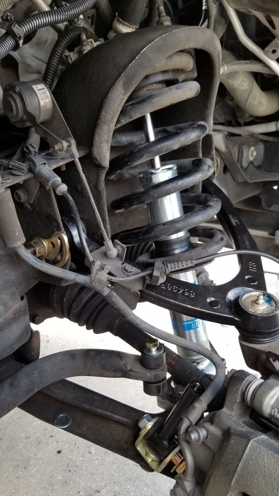

Sorry to dig up a thread, not sure if you figured out your situation, but i used the factory spring seat from my DXL. Dont know why they think you need the other one. I used the 5100 adjustable strut on the lowest ring and put in a 1.5 spacer. My truck is looking awesome. Should have it all buttoned up soon.
TXSpeed418DXL
Jul 10, 2020
Through a set of moog uca's at her. Budget didnt allow for anything fancier. Seats slid right off my factory strut and slipped on the billy with no problem at all.

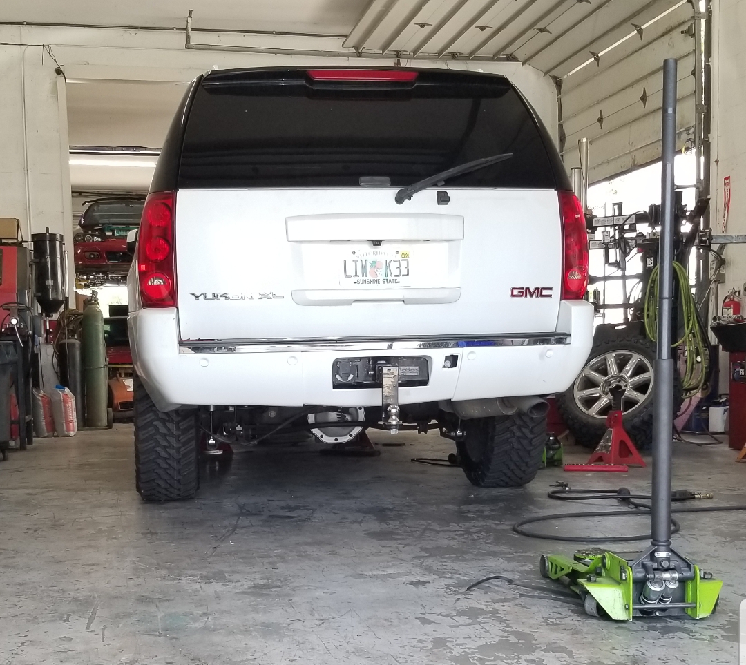

Sorry to dig up a thread, not sure if you figured out your situation, but i used the factory spring seat from my DXL. Dont know why they think you need the other one. I used the 5100 adjustable strut on the lowest ring and put in a 1.5 spacer....
Curious about this issue as well; my shop had no problem installing new 5100s and HD Moog rear coils on a 2011 Suburban LTZ as a direct replacement for the Z55 setup. Front perches are set on the first ring from bottom, no spacers. Truck is lifted 1.5-ish inches all around. Looks good as does yours. Will post pix after I get rid of the 20" rims and put my new Grabber AT-X 275/65-18s on it. I found a set of 2017 Silverado Z71 18" takeoffs for wheels. Waiting on the shop to clear a few minutes in the next couple of days to get them mounted and balanced.
Ride is much better than the blown out Z55 stuff and it pulls an 18' Winnebago like a champ.
