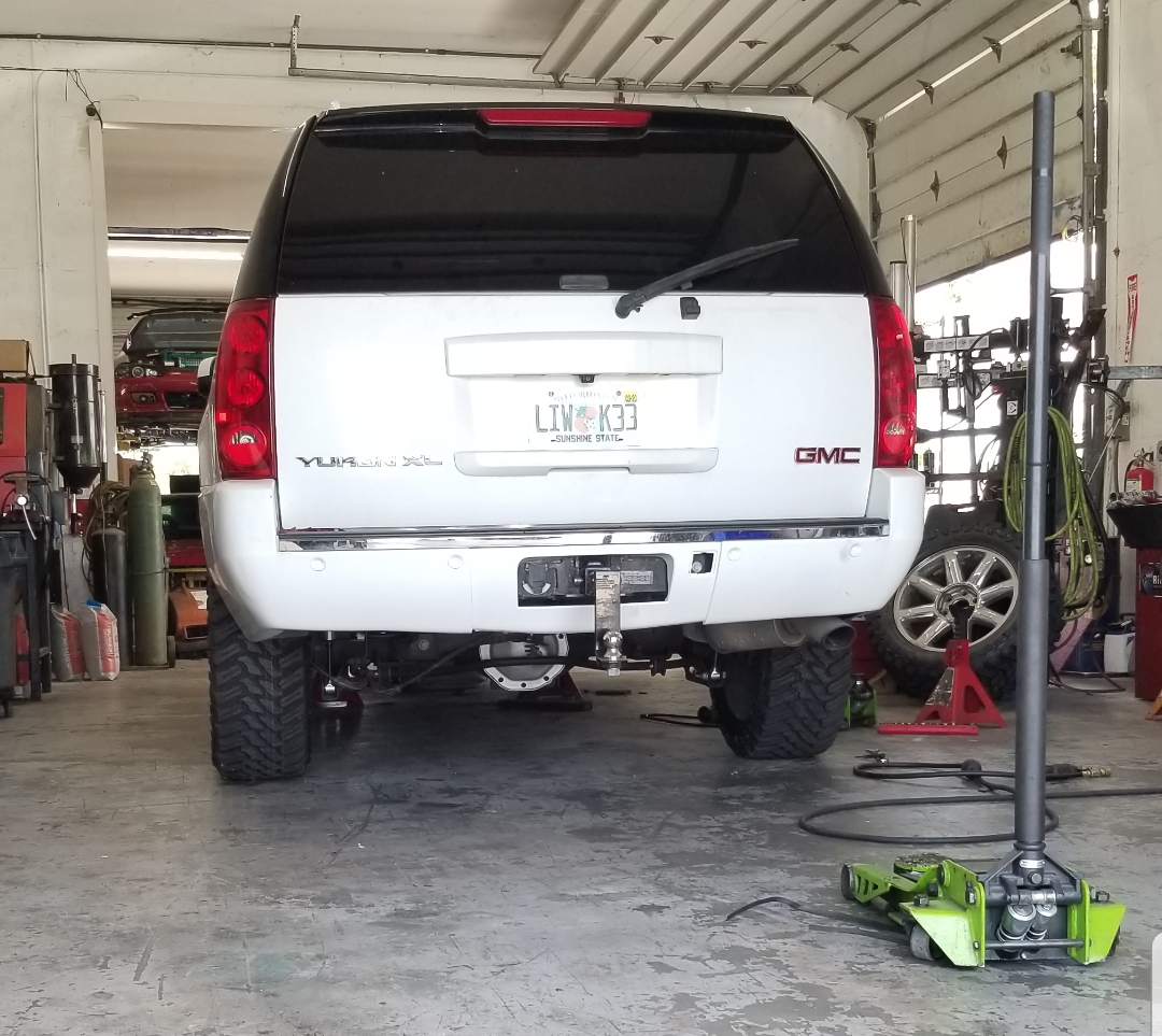

Sorry to dig up a thread, not sure if you figured out your situation, but i used the factory spring seat from my DXL. Dont know why they think you need the other one. I used the 5100 adjustable strut on the lowest ring and put in a 1.5 spacer. My truck is looking awesome. Should have it all buttoned up soon.View attachment 252126
I’m asking only to confirm, you did NOT have to use non auto ride spring seats or hardware? Just used the original springs and hardware?

@usdlawstudent this is with bilstein 5100s and moog HD springs
