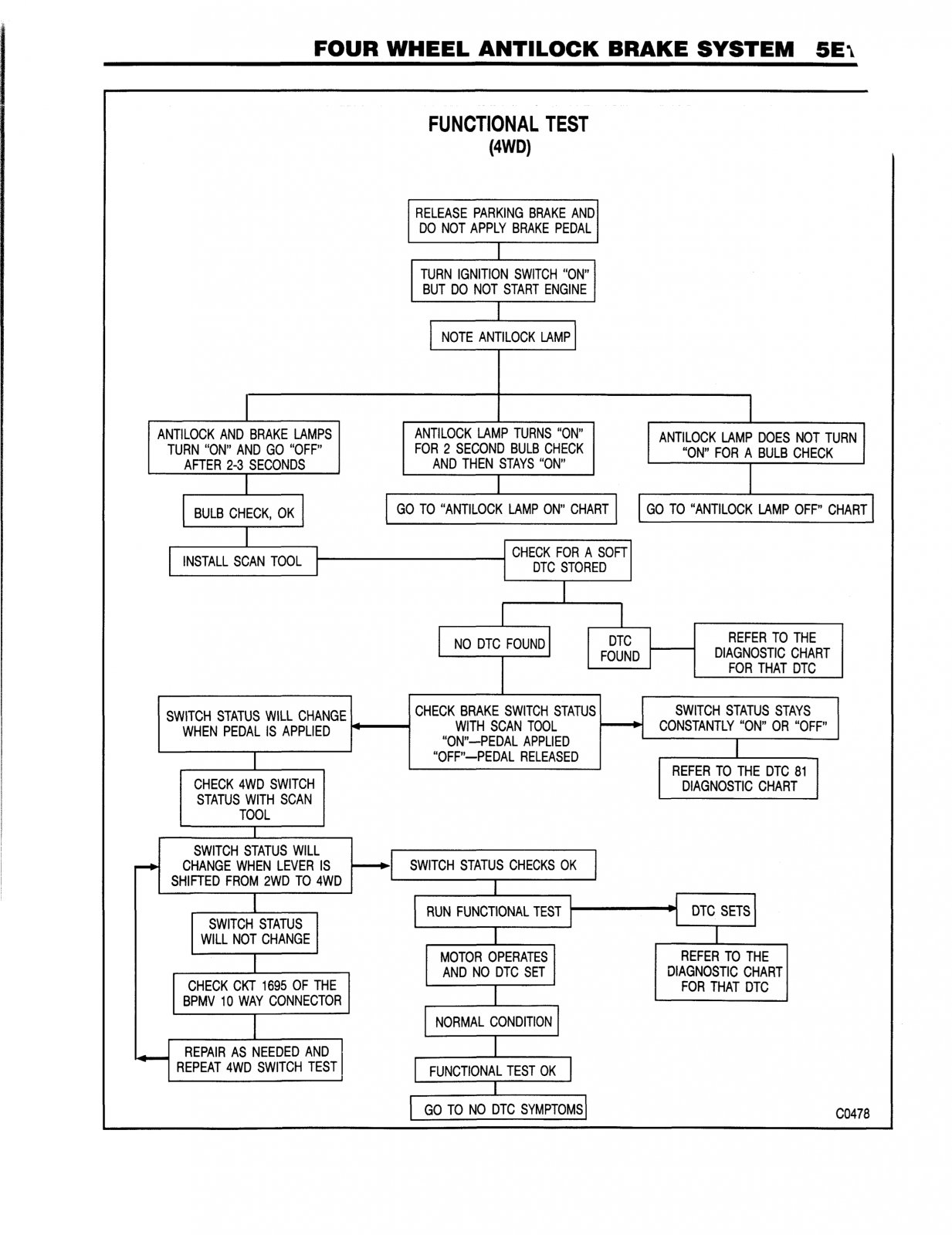

Here are the pages from the 1995 manual. It sounds like they have a basic scan tool function that activates the system as part of a function test. On my 98, there is a specific menu in a tech2 for ABS bleed.

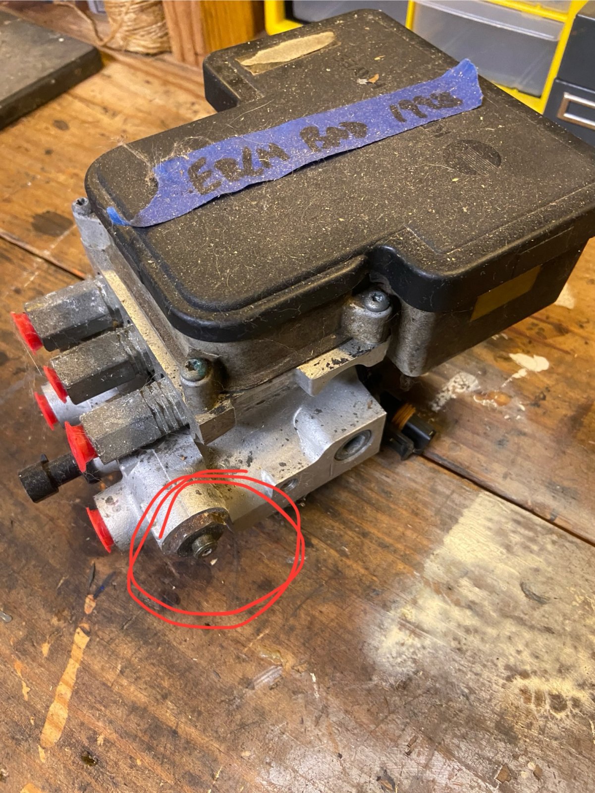

In the pressure brake bleed procedure, note that GM calls for the two pins at the end of the combination valve to be held down. They’ll have black rubber caps on them. Here’s one from a 96-98 Kelsey Hayes unit. I’m not sure if the TBI used the same one or not, but the combination valve is probably similar. There’s another pin at the opposite end.
When the brake is pressed, these pins will extend maybe 1/8” or so. Kent Moore sells a tool for holding it down - it looks like a money clip - but I’d bet the same results could be had by holding a screwdriver against them to keep them down.
It’s worth a shot. The manual continues with requiring an ABS function test which sounds like an automated brake bleed.

I have not really checked but with that said I would be leaking break fluid if there were a leak and I am not. Per the internet it stated that the slaves could suck air so I changed them but I am not really buying that. Everything I am honing in on points to the abs which I do not have the scan too to activate. There is a bleeder on the side which I believe is really used when one changes a master cylinder to purge the air. It has crossed my mind that the ABS in some way is sucking air into the system yet it does not seem possible as it should leak when pressure is applied.
I am convinced if there were no abs I would have solid breaks and supported by guys who have removed them.
