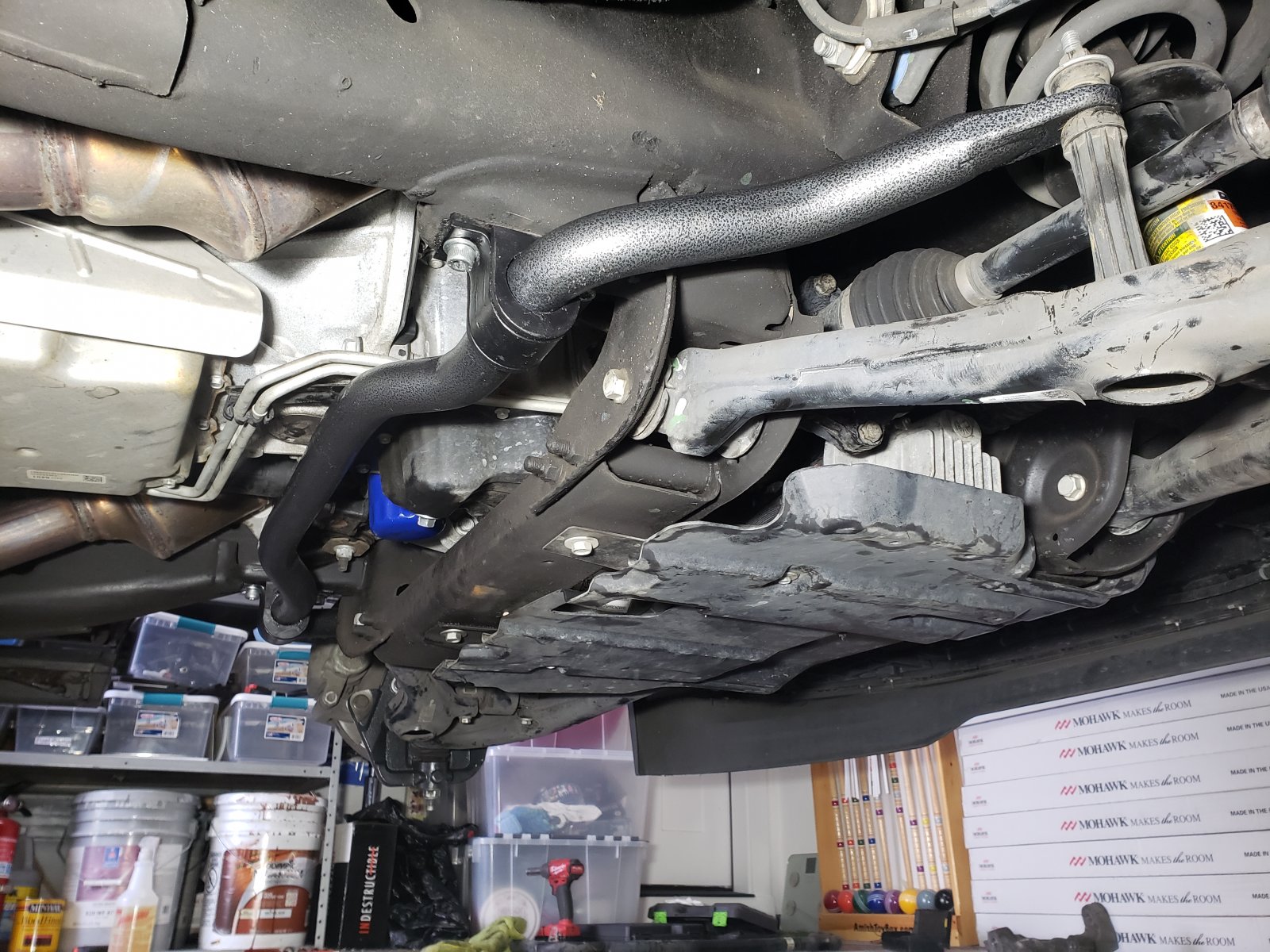

Ok then. I’m lowered and have aftermarket sway bars by Hotchkis and no modifications were needed to the front. Especially no cutting of anything. Got my Hellwig replacements about to be installed next week. I don’t need anything. Not saying you’re wrong. But I didn’t. And before doing my research on lowering i’ve never seen people talk about doing front sway bar modifications. Only the rear needing shorter or adjustable endlinks. So to the OP I guess it’s up to you. The following picture is not from my ride but another member online lowered with Hellwigs. No modifications were done. Again not saying you’re wrong but I didn’t need to do any modifications to the front for them to fit.

I may be wrong, but looking at the photo with the truck on the lift, it would appear to me that the sway bars are not going to be even close to level/horizontal with the floor, when lowered to the floor. The overall effectiveness of sway bars diminish quickly, when they are not horizontal to the floor.
