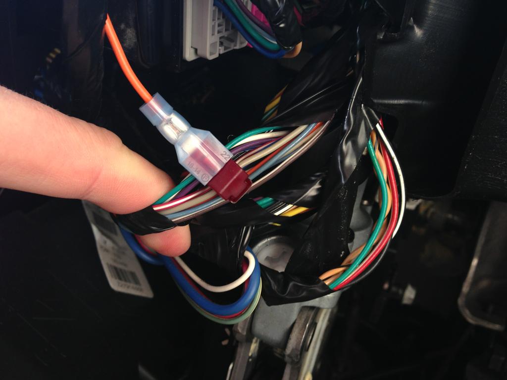

need help wiring led strips on my side steps. i want to wire them in so when the doors open they go on. what do i wire them to? i was thinking mirror lights since the dome lights are to far away

i think there is a grey wire you want to tap into . I found another forum with pics but can't paste the url here for some reason.

You want to get the dome light wire underneath the dash.
Underneath the drivers side dash, directly behind he parking brake is a computer box with 5-6 different color plugs coming off it. Grab the set of wires that come off the white plug towards the top. In the harness will be a solid grey wire, that's your interior lights, T in to it and that wire is the wire you want.
