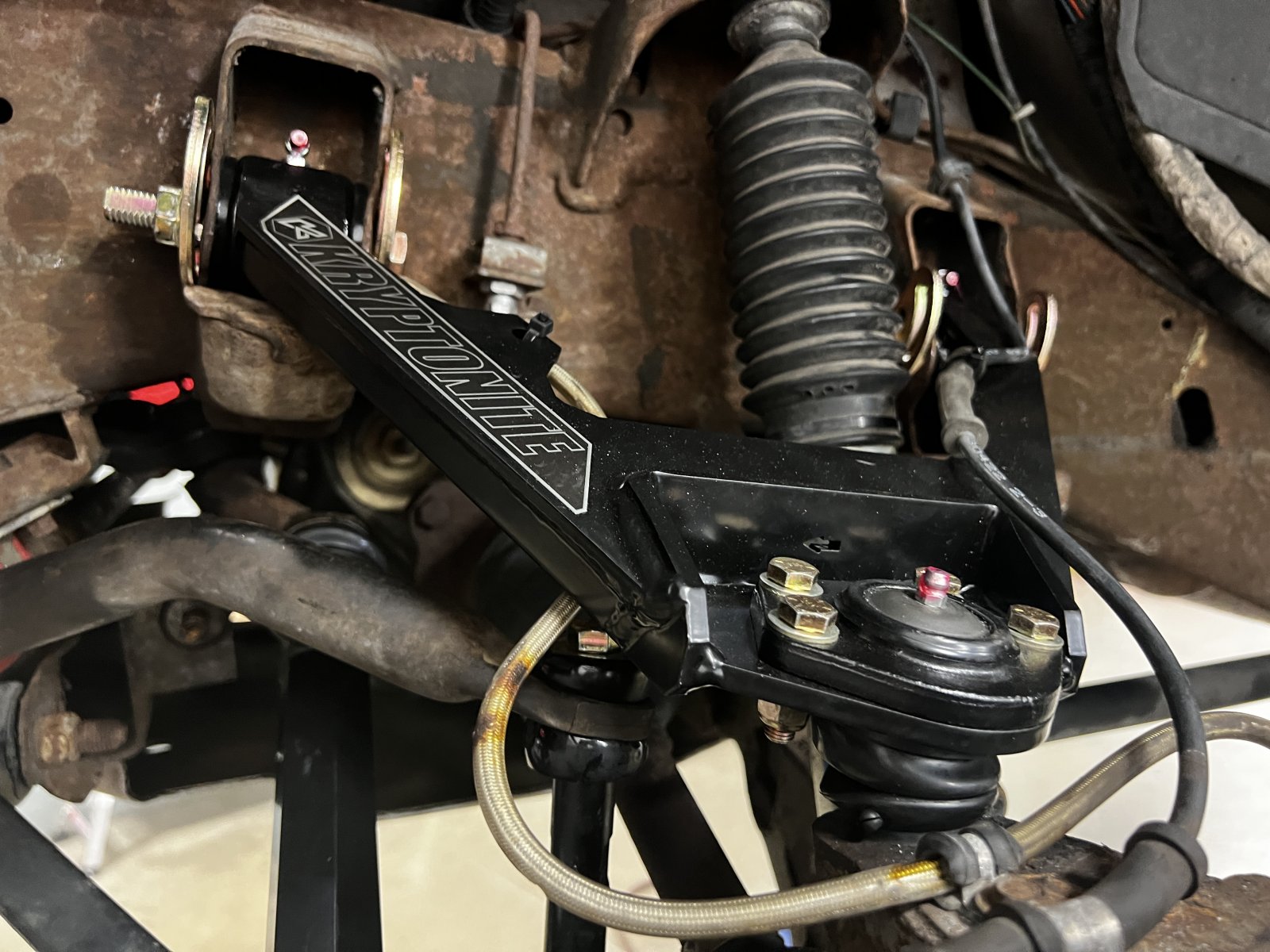

Bit reluctant to add the center link regardless as it changes interface for inner tie rod (if I break something I cannot go to parts store to fix).
KRYPTONITE UCA, tie rod ends, and sway bar links on my 2003 Z71..

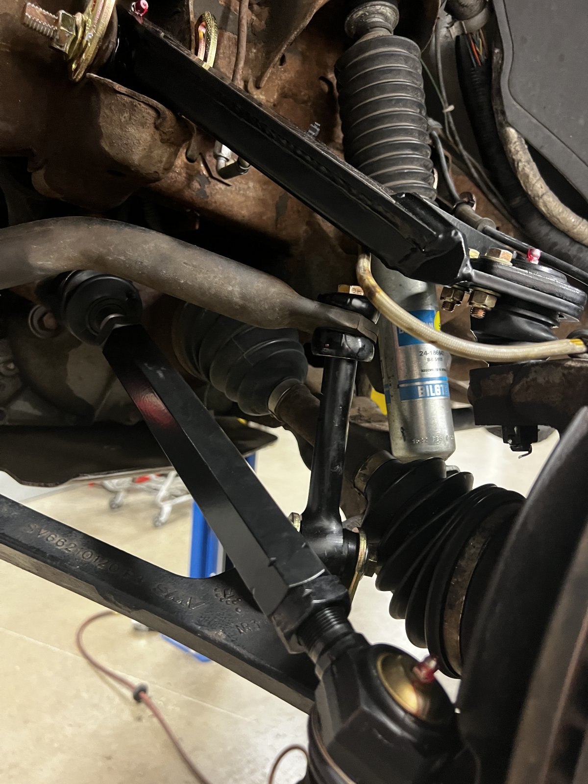

Kryptonite Tie Rod Sleeves
Moog Problem Solver inner tie rods
Mevotech TTX outer tie rods
Above is a picture of the setup with about 50,000 miles on it. It has worked VERY well for factory fitment upgrade. When these go bad I may spring for the Kryptonite tie rods.
