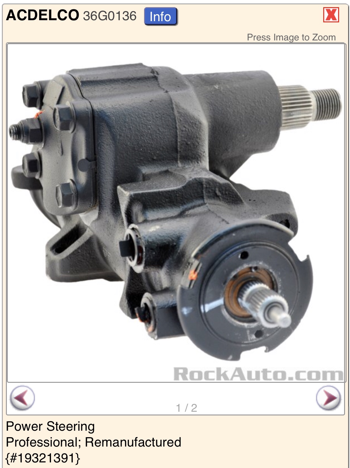

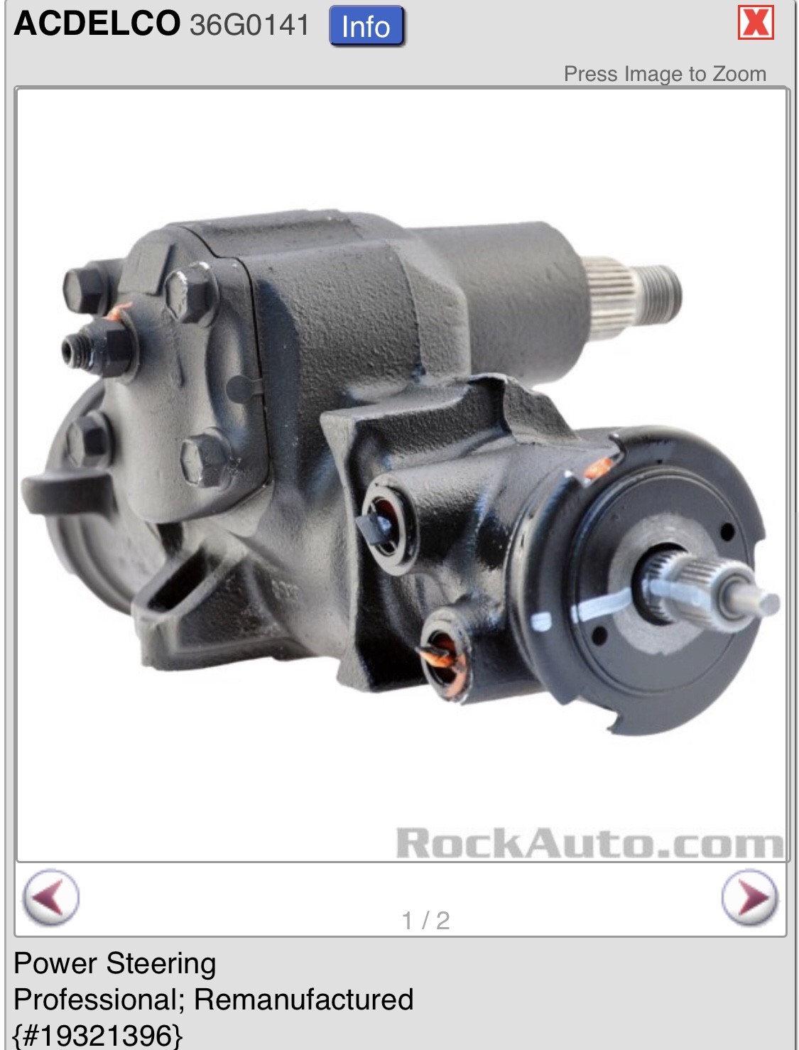

I’m not familiar with the Cunningham steering shaft, but did it include a new rag joint? They’re riveted in at the factory but can be replaced. Check YouTube for videos, but a worn one can impact steering.
I’d tend to agree that the gearbox is worth another look. They did use a different box for EVO and non-EVO.
I have a non-EVO box (Bluetop) in my 98 two-door. It is noticeably heavier steering than the stock one. Subsequently deleting the EVO made no difference in steering feel.
I have a stock gearbox in a 98 Z71 truck. Deleting EVO in that one made no difference in steering feel.
Neither of them wander, require excessive correction or have an annoying dead spot at center. I have had reman aftermarket boxes (Napa house brand and a Delco) that drove like that. Properly adjusted, both should be satisfactory.
The external difference in the EVO and earlier boxes seems to be at the steering shaft connection. The earlier ones have a c-clip and larger opening.
1992-96 K1500: GM part number 26052912
1997-99 K1500: GM #26100345
