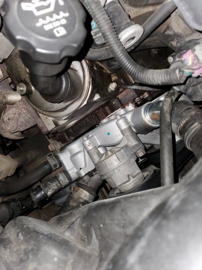

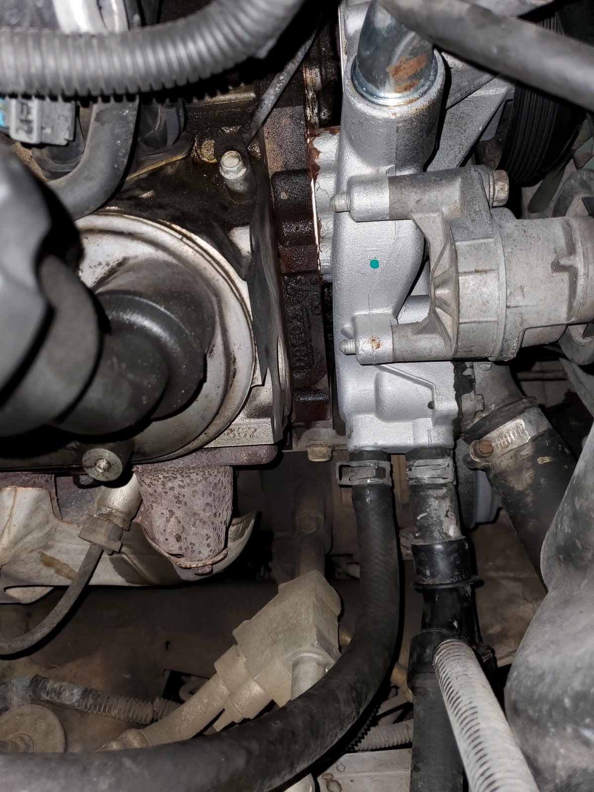

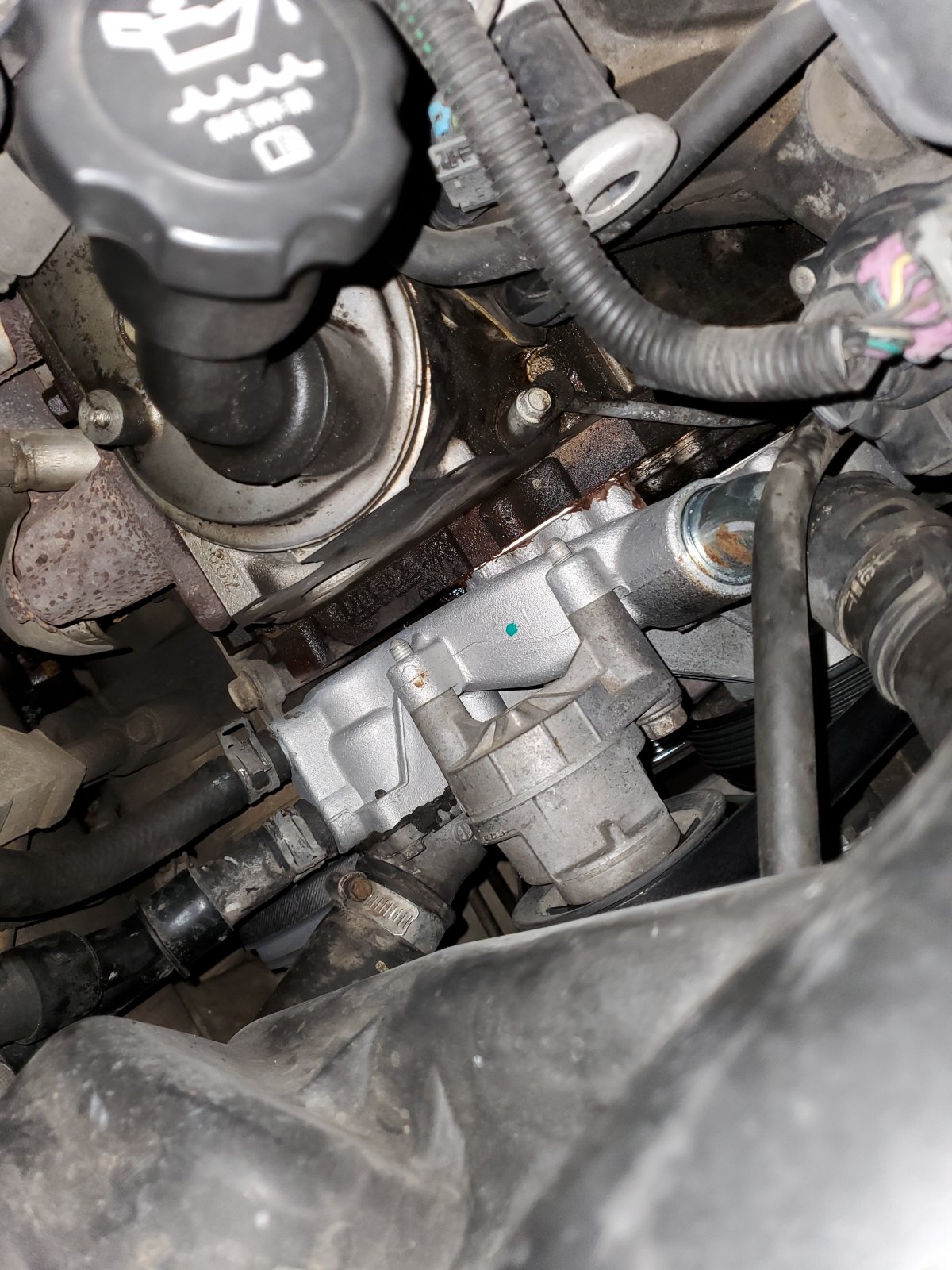

Well both heater hoses are hot as hell! I didn't did it by touch and damn it feels to hot on both. Doing a temp gun test today. I haven't bought a tech 2 yet but plan to this week. To busy finishing up some house projects while I'm off work. Didn't find a part number on the radiator but looks to be a newer one versus what would come on it. May just pinch the line for a restriction and see what they does. Luckily it blows just enough warm-ish air right now.
Think this is a head gasket leak?..oil build up right behind the thermostat housing upfront of the head.

Look under the oil fill cap and see if shows a milky buildup and check oil dipstick for same. Doubt it is head gasket related but may be. The other possibilities are more likely. Did the thermostat get done yet and let us know what happens after that. Maybe you already did but have not back tracked thru thread.
