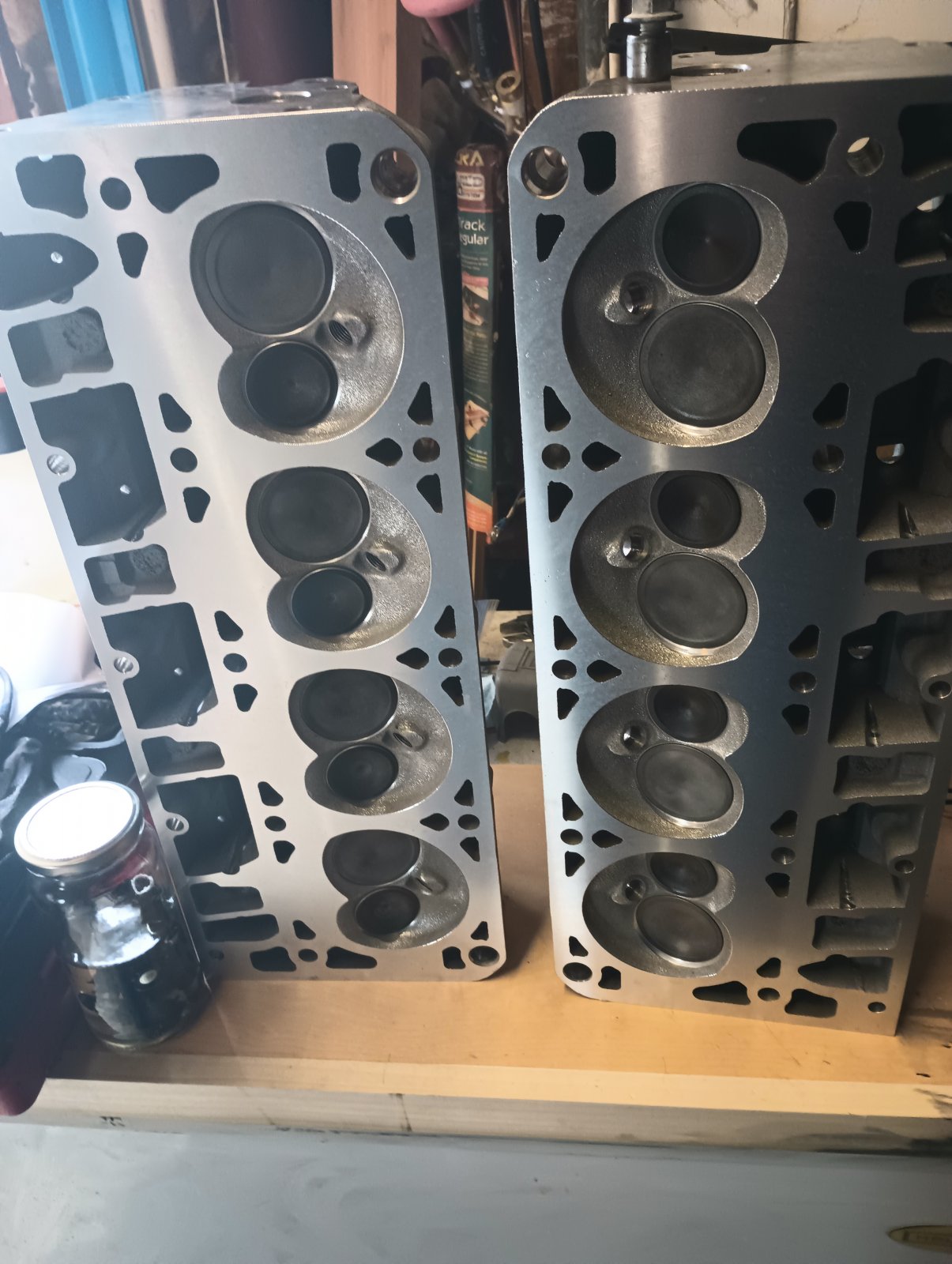

I recently took some grimey 317 to my local machine shop I'd bought for $75 for an engine I'm building. They cleaned, inspected, milled them, did a valve job and replaced the stem seals for $350. They are basically like new now. It took like a week to do the work.
I think they will go on my 06 Suburban LQ4 engine though. I've got what I suspect is an intermittent sticking lifter. I did the rear main seal and oil pan last year (dropped the transmission: 4L80e 2wd FWIW). I'm thinking replacing lifters, cam, front main cover and installing these heads. Engine has 260k and oil pressure seems good and runs strong, so I see no reason to pull it and mess with more than I need to.
