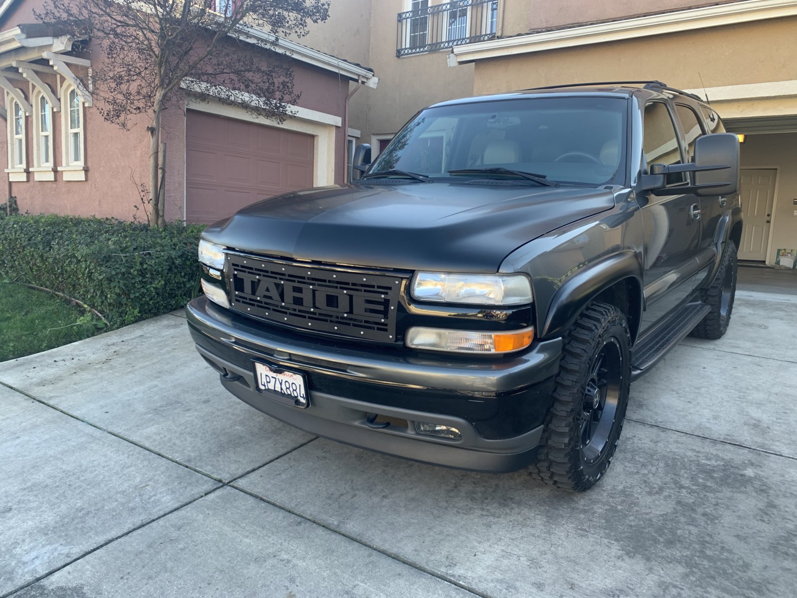

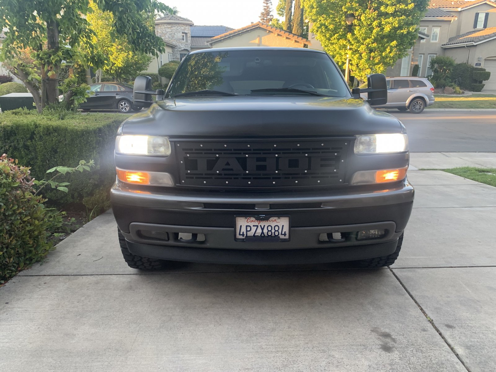

I was questioning the HD look at first But after putting it on I have no I have no regrets

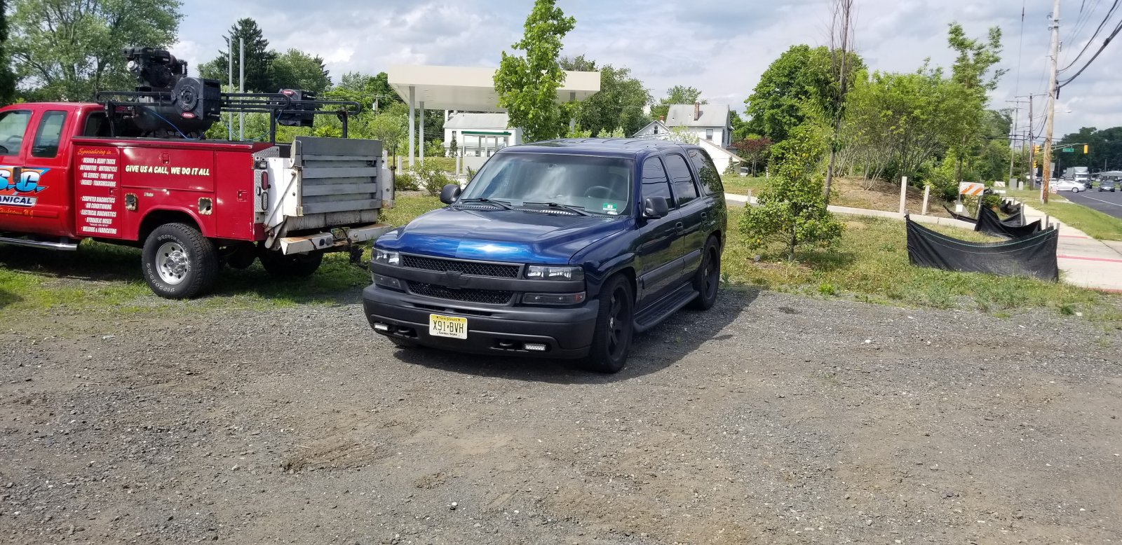

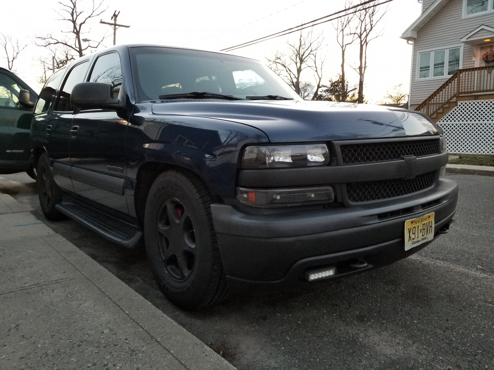

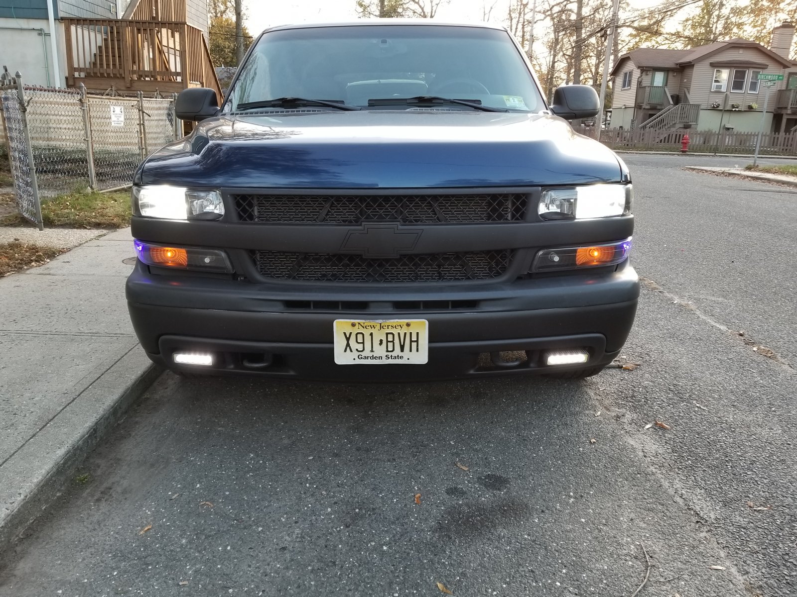

I think I'm the only one who doesn't really like the appearance of the HD hood swap. It looks ok on a couple of trucks, mostly ones that are slightly beefed up - like larger tires, maybe a slight lift. Mine would qualify, but in looking at lots of others with stock height and tires and lowered, I just don't care for it.
Maybe it will grow on me.
33,174
51,371
Not recently, but a few years ago.
