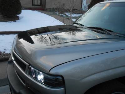

A lot of questions get asked about this swap. Lets get this all settled here.
What you need. 00-02 CHEVY Silverado HD hood.(IE 2500/3500) Notice the big, bold, underlined, red word. A GMC 2500/3500 hood is different, not the same do not waste your time with looking/pricing them.
The hood swap IS a direct bolt on for a TAHOE & SUBURBAN (NBS - 00-06) nothing else is required.
The hood swap IS a direct bolt on for the Yukon & Yukon XL (Denali included). By that i mean it does bolt on BUT you do have to trim around the headlights to make it fit correctly. Some have even mentioned slotting the hood hinge where it bolts to the truck. This pulls the hood forward giving it better alignment around the lights.
I would recommend having a shop do this kind of mod if you are not 100% on it. It is very tedious and a time consuming mod. In the end it is worth it.
This mod is only for NBS Tahoes/Suburbans/Yukons/Yukon XLs.
The Verified GM Part Number for the Chevy HD Hood: 15745931
GMC Seirra 2500HD - The crap hood.
The hood you want. The hood you need. The sexiness that is the Chevy Silverado 2500HD
