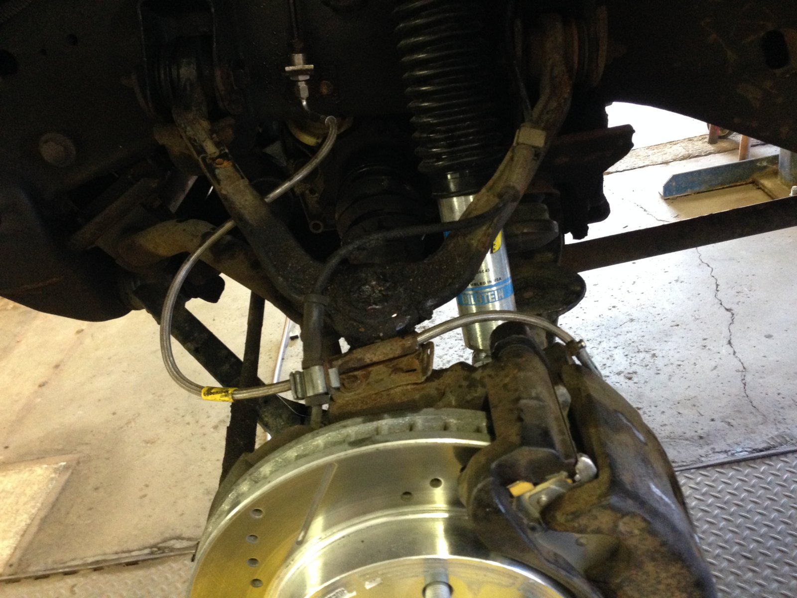

Brakes have been bleed and new fluid-all 4 new rotors and tried 2 different pads.Same result pedal feels mushy like their is cardboard between the pad and rotor.No the pedal is not hard as a rock not at all.I dont care how much this thing ways it should stop alot faster than what it does.I have done brakes for 20 yrs this is the worst factory brakes i have felt.I am wanting to change calipers to the newer yrs 07 and up with the bigger rotors.If that doesnt work im smashing it into a wall.

Just to ask the obvious, but are all of your bleed screws facing up? Sounds like air in the system or caliper issues.. my brakes felt like that before the hydroboost. I'd recommend bleeding the hydroboost as well.
