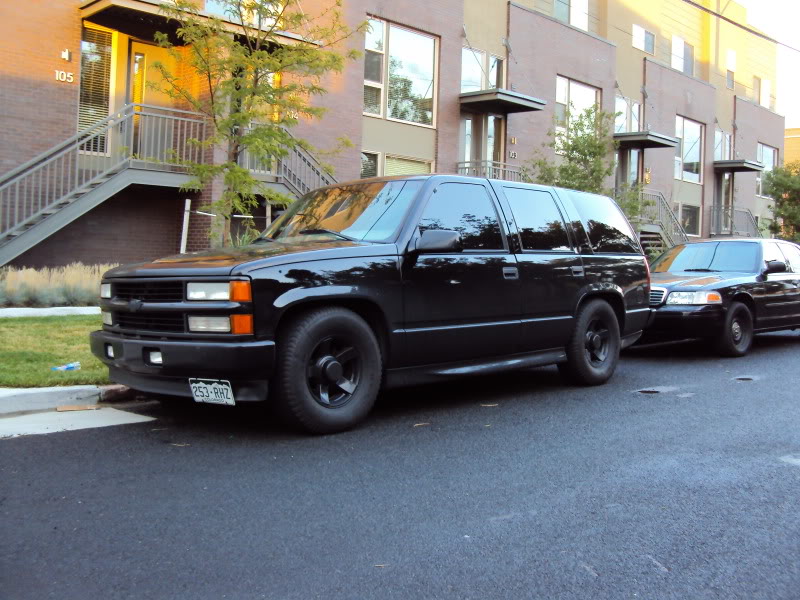

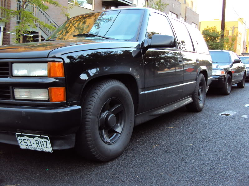

You may have better luck in the 92-99 forum as you truck is essentially a 99 body style. Bilstein makes damn good shocks for those trucks and belltech, as well as others, make larger anti-sway bars that should dramatically improve handling. Here is my old limited after I dropped it 2" for my buddy, the current owner:
The front has since settled another 1/2" truck drives really nice and handles much better.

How did you drop it? I like your trucks stance - what size rims are those? Thanks again and sorry for the late reply.

2" belltech springs up front and 2" belltech shackles in the rear. Bilstein shocks, new steering, bunch of little stuff I did before selling it to my friend. The wheels are stock limited ronals powdercoated gloss black.
