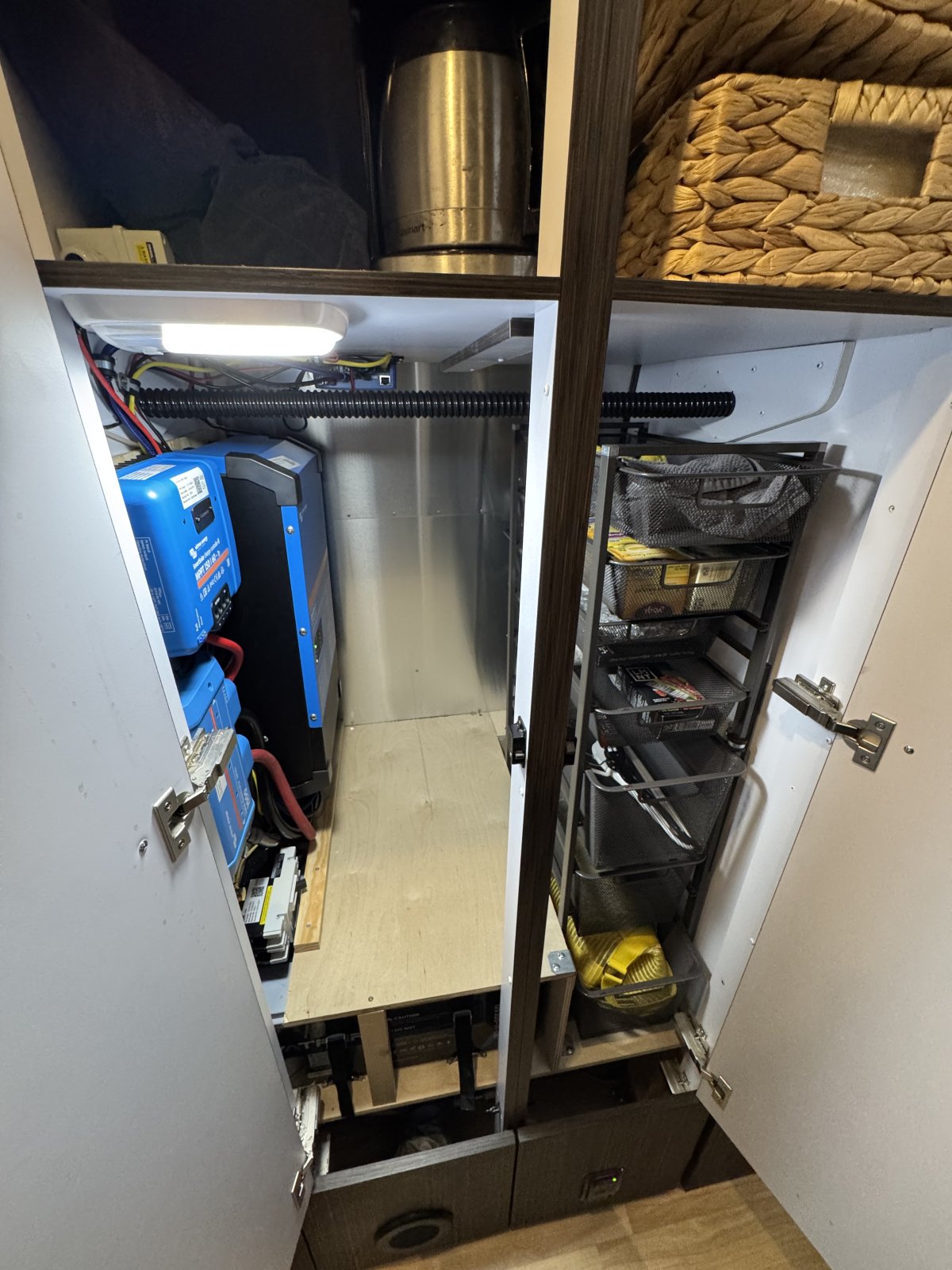

Spent the last 10 days working on the inside, drawing up designs, throwing them away, settling on a final design, and then making up the cables, pulling them through chases, rebuilding the wardrobe floor to hold the weight of the batteries, programming the devices, and putting it all together. Originally I was going to put the Quattro in the front baggage compartment under the bed, but that would've meant some long cable runs through inaccessible places. So I landed on putting it in the wardrobe and recalculating everything. The benefits are short cable runs and the added 200 lbs will sit right over the wheels, instead of just behind the tongue.
This beast can draw 350+ amps from the batteries to run the A/Cs, make coffee, whatever. Every outlet in the Airstream will have power, even when we're not hooked up to shore power. If we don't need A/C for more than a few hours, then the solar on the roof will produce enough power for us to be off-grid indefinitely.

Finished up the install last week and wired in the solar panels over the weekend. Everything works and we still get to use most of the closet, but my feet are killing me from standing on that ladder for 4 hours on Saturday, lol.

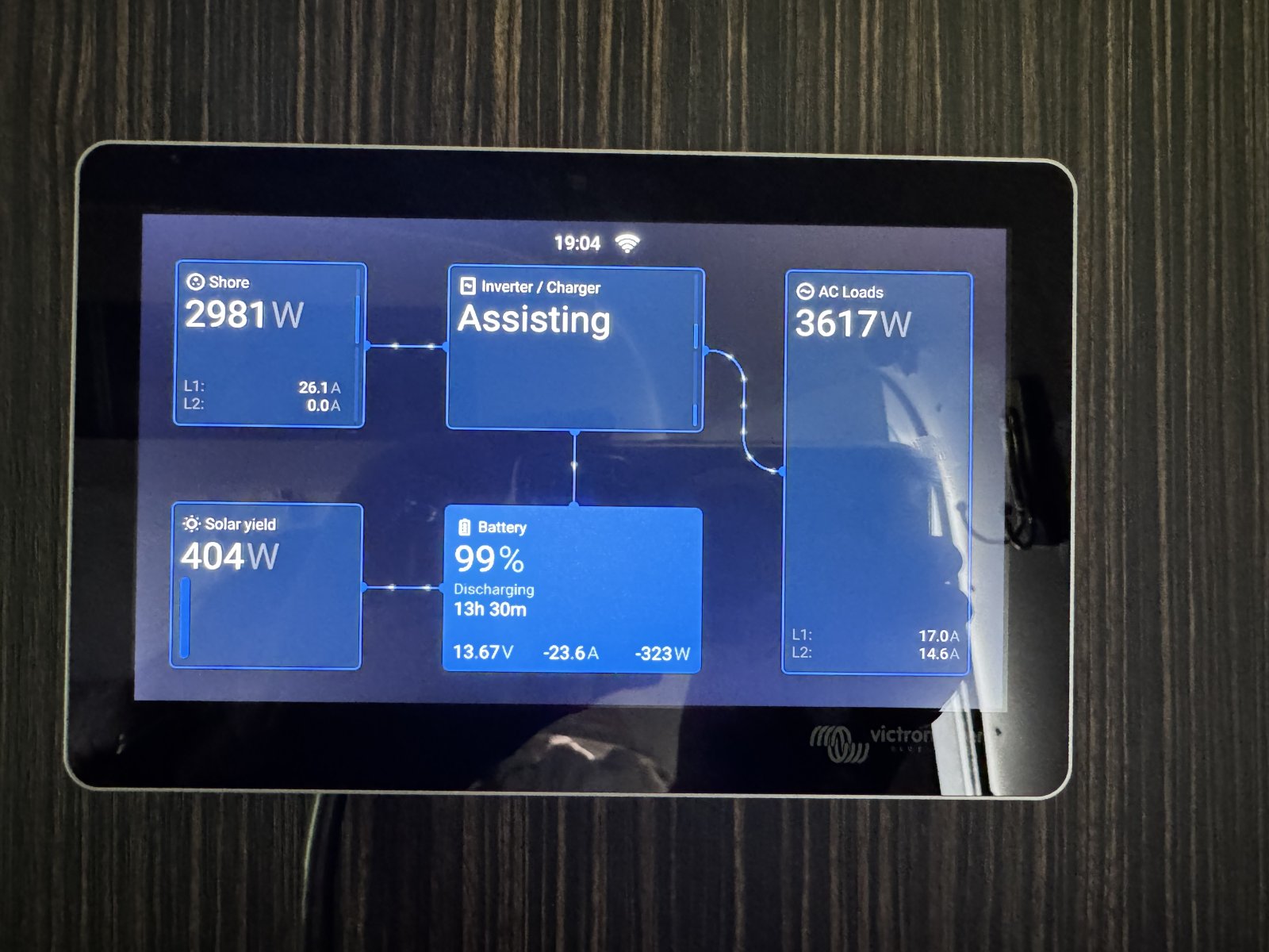

It's pretty satisfying to watch the power assist feature work. I was connected to a 30A 120v RV outlet at our house, which isn't normally enough to run both A/C units, plus the fridge, water heater and everything else in the camper at the same time. But the Victron Quattro inverter/charger pulls power from the batteries to run heavy loads.
The panels on the roof are rated for a total of 720w, and it was a hazy March day yesterday so I didn't expect much, but I saw an average of 400w with a few 530w+ peaks. When we're not running any A/C, that's enough to meet our 24x7 electricity needs indefinitely, with the fridge and water heater running on propane.

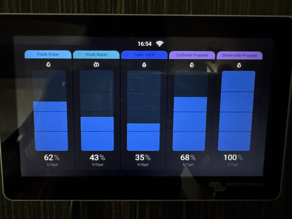

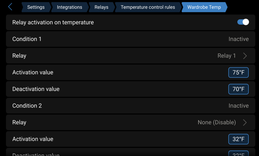

Because I can't seem to leave well enough alone when it comes to technical projects, I've gotten a few more things done as the opportunities arose. First, I upgraded the factory SeeLevel II tank monitor to the BPT7 bluetooth-enabled version, and got it working with the Victron Cerbo GX and Touch 70 display. I got to use my long-dormant Unix/Linux admin skills because it required some Python scripting and bash command line sorcery.
Victron did a great job with the Cerbo GX because it's basically a tiny computer running a custom version of Linux, which makes it wonderfully extensible. And there are a few nerdy Airstream owners out there building useful stuff that they share with the whole Victron community. So I didn't have to start from zero and was able to build on an existing project in Github.
Anyway, now I can see all of my holding tank (SeeLevel II sensors) and propane (Mopeka sensors) on the screen at a glance, and also remotely:

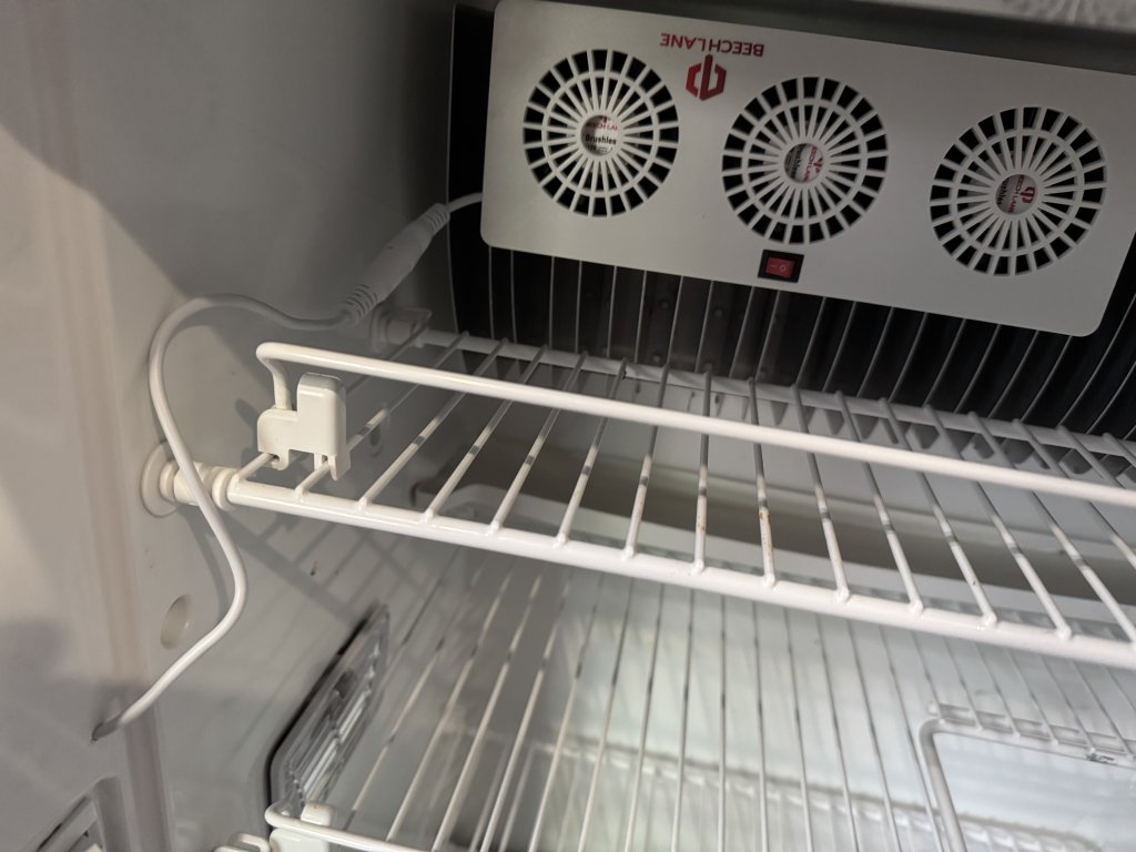

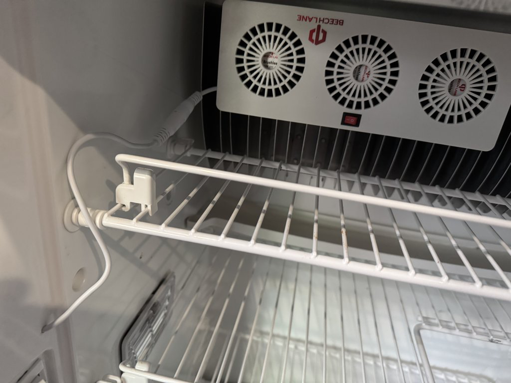

After that, I installed Beech Lane fans on the interior coils of the Dometic absorption fridge, in anticipation of hot summer weather, to hopefully keep it working effectively. They're notorious for poor performance in hot weather, and for icing up the coils. I wired the fans into the door switch so that they're on when the door is closed, and turn off when the door is open, to keep it quieter. Easy peasy.

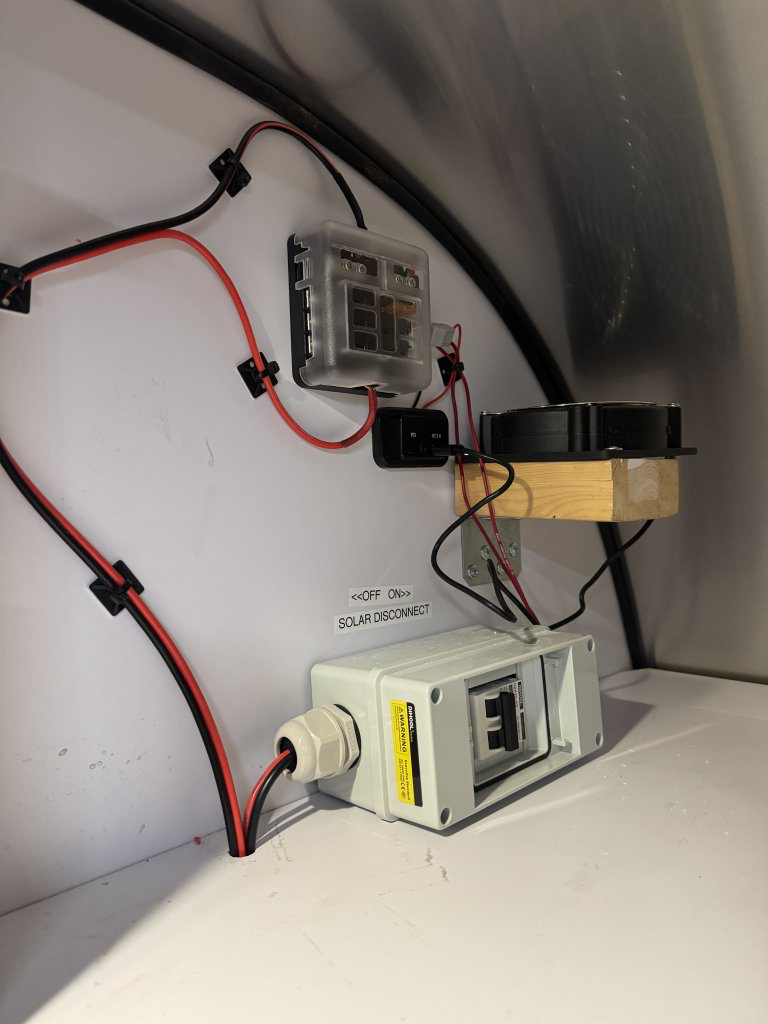

Then, I installed a fuse block and a surface-mount USB-A 3.0/USB-C PD port on the upper wardrobe wall so I could control the wardrobe USB exhaust fan from a temperature probe mounted below the upper wardrobe shelf. To keep it simple, I used the temp probe that came with the Quattro inverter/charger, and ran the power for the USB port through the Relay1 block on the Cerbo. Works perfectly.
I have it set to activate at 75ºF but have since raised it to 85ºF to minimize noise and power usage. On high, the USB fan I installed consumes about 10w - not enough to sink the batteries on cloudy days, but enough to want to minimize its use to only when truly needed. The wiring ain't pretty, but it works and is correctly fused, and safe. I also deleted the inline USB fan speed control that came with the fan because it gets hot enough to melt its case on medium. So the fan runs at full speed when it's on and is a tad noisy, but it will do a better job of cooling, so it's fine.
