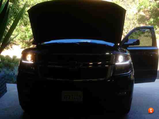

All lights on. Headlights look dingy in comparison to VLED 5000k LED fogs.

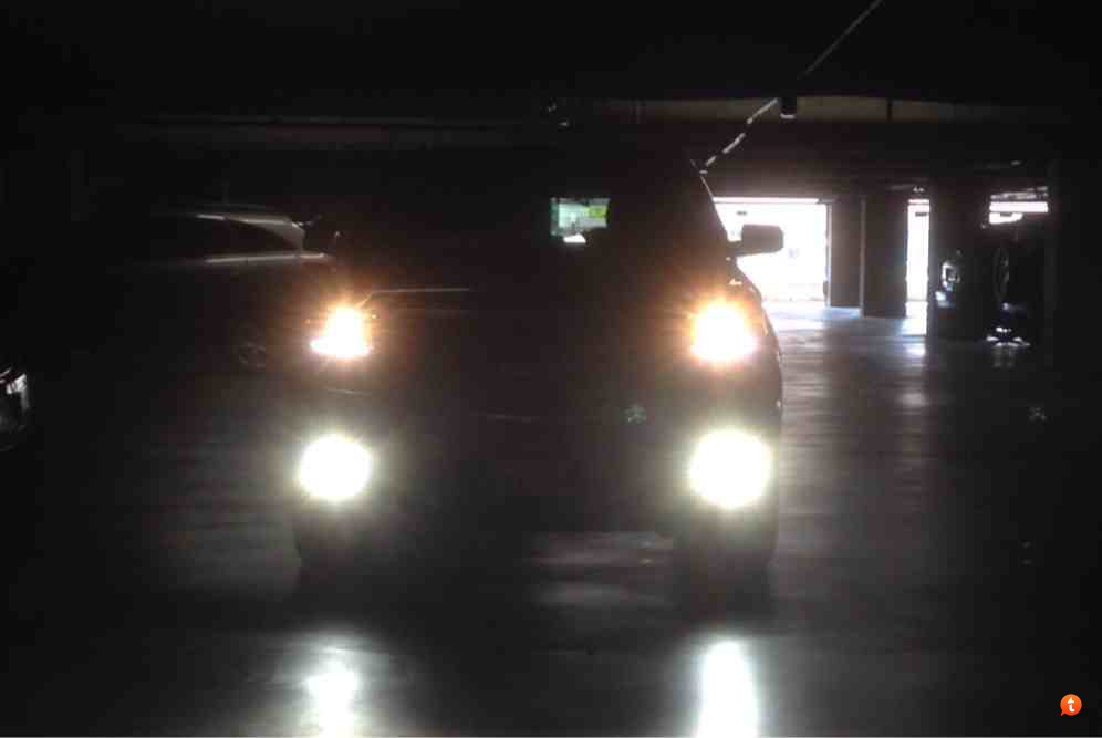

I would think any upgrade halogen would work fine. I have the OSRAM "cool blue" 9005 bulbs in my high beams and they match really well with the HIDs and vLED fogs.
They make the same bulb in an H11 which is the low beam for the yukon (double check your owners manual for the tahoe).
They are $25... Not sure if they are any better than silver stars or Phillips...
http://www.theretrofitsource.com/co...alogen-h11-replacement-bulb.html#.U4LOm4m9LCQ
Picture of my high beams and HIDs

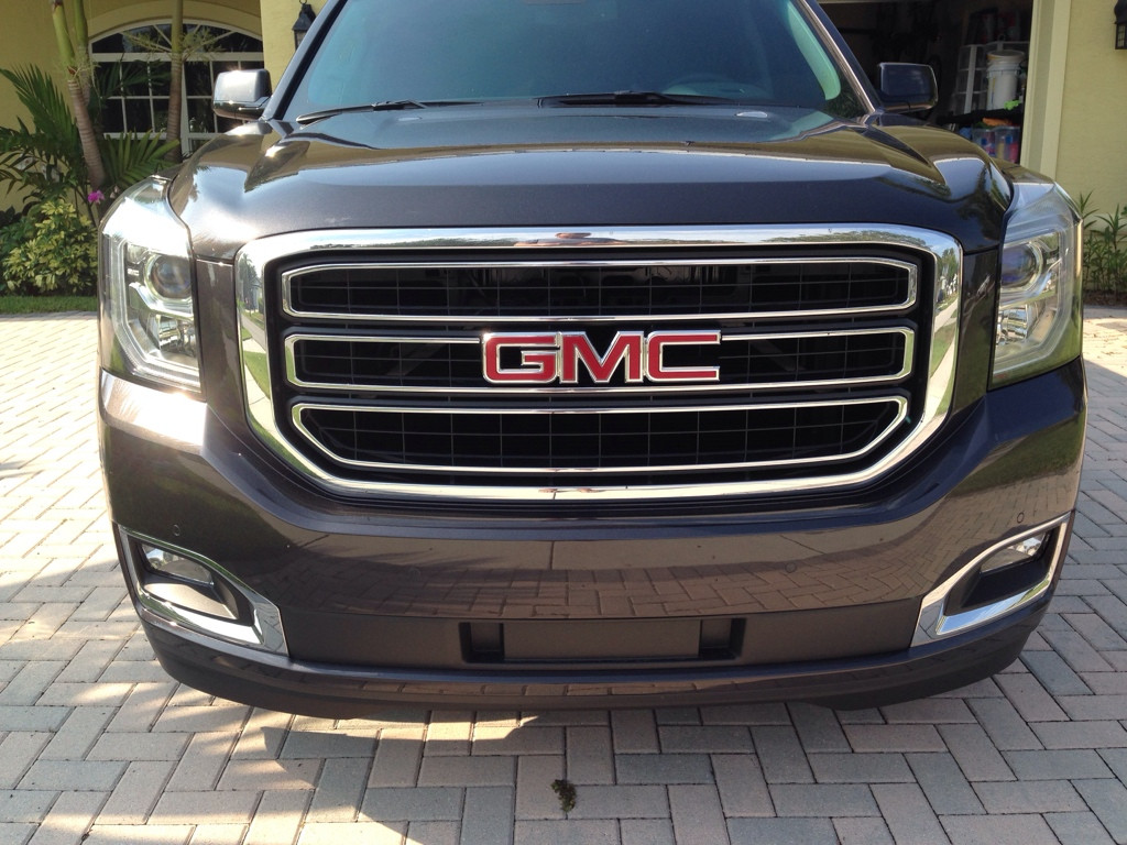

BEFORE

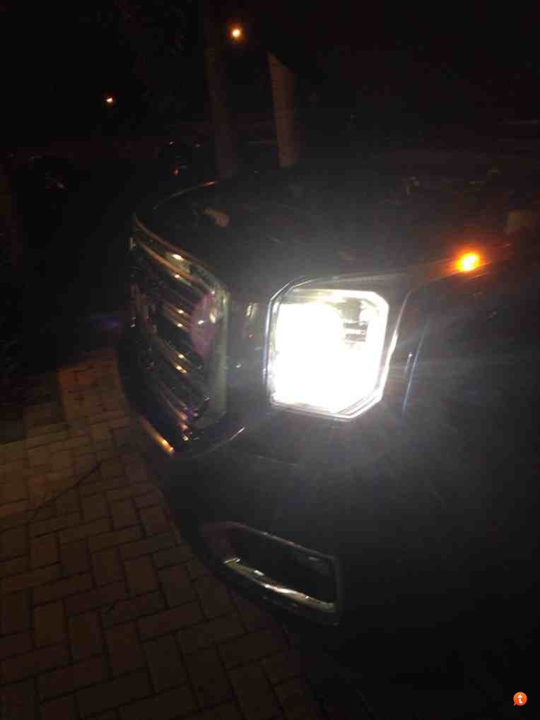

AFTER
Stock on left (passenger), Osram on right, (taken at a slight angle to avoid direct beam and just show color difference)

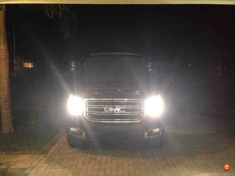

Picture of my high beams...

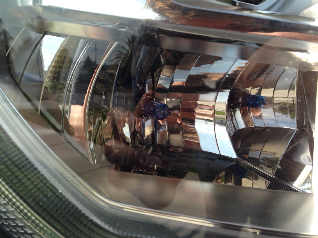

Thinking about doing the high beams as well now. Can you post a pic of what the Osram highbeam bulbs look like in daytime (unlit, of course)? I'm wondering if the blue tint on the bulbs stands out or looks cheesy through the lenses. Thx!
Steve1081
Mar 31, 2014
376
36
You can see the blue... I don't think it is really noticeable or looks bad; but, you can see it. I will try to snap a picture tomorrow.
Steve1081
Mar 31, 2014
376
36
Excuse the bugs...
You really don't notice the blue unless you are in the path of the headlight... Then you can see the blue reflecting off all the reflectors in the headlight. These last pictures are taken at the exact angle to capture the blue reflecting off the headlight it doesn't look like this unless you bend down to the exact angle.
