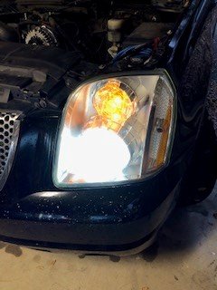

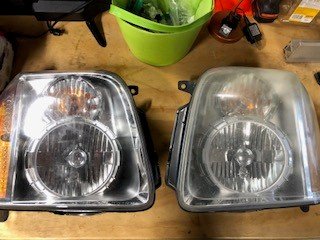

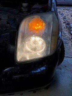

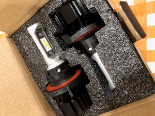

Had a low beam go out and decided to upgrade to LED on the headlights. My lenses were oxidized really bad and took care of that as well. What a huge improvement in visibility and looks!
Bulbs:
Headlight restore:
Here are the before and after pics!

Understood @topaq, so far the beam pattern is very similar to stock, the light is much better and I am not blinding oncoming drivers. If I run into trouble I will relay the story here.

@2Seven there is no need to reseal as the bulbs were plug-n-play, but now that the lenses are clear I can see I have condensation build up in my driver assembly. Will need to reseal.

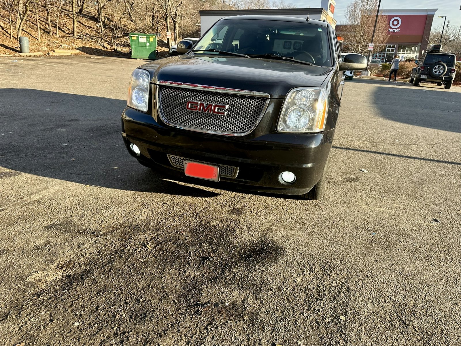

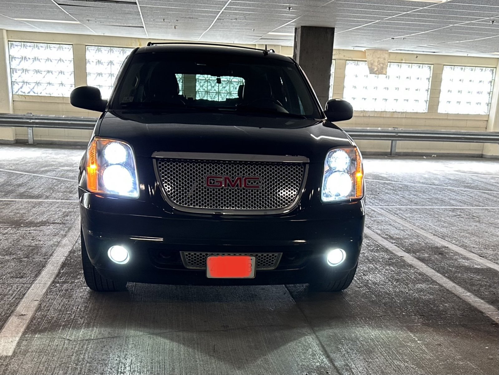

I just upgraded mine as well. I tried to restore the passenger side headlamp since it was pretty cloudy. Didn’t come out as nice as I wanted but I plan on replacing it anyways since the tabs are broken. I also installed switchbacks in the turn signals and upgraded the fogs.
