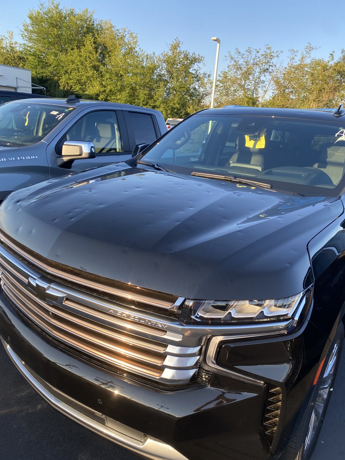

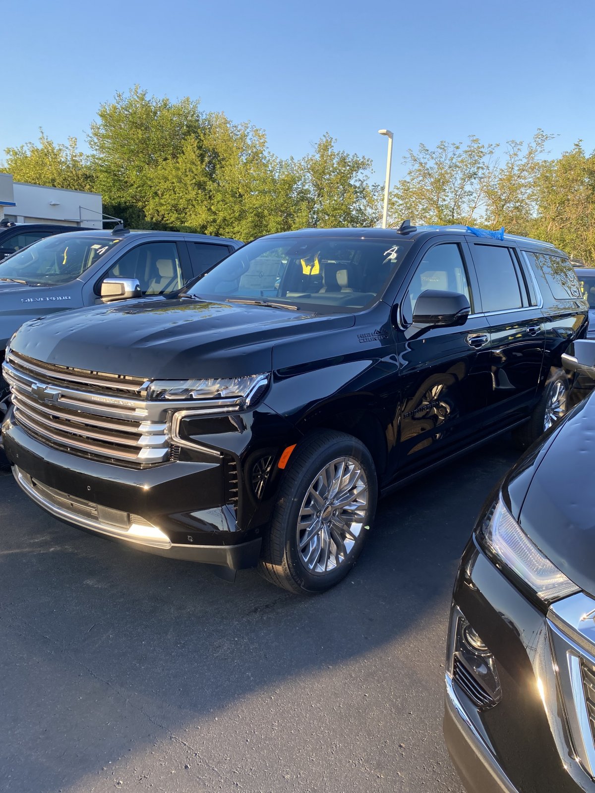

We live in michigan and there was a hail storm came thru the area over a week ago, golf ball size hail. We wanted to go look at a couple suburbans nearby and wow was this dealer wrecked! $92k suburban check out the hood! Heard they were giving some big discounts for people that wanted the damaged ones and can fix on their own.

Their asking price will be determined on what the insurance pay off is. They can just get a new hood and bolt on and paint if not already painted. They will factor in the roof insurance as well and any other sides/front/back damage and price it for sale. So many people will buy and never fix the roof.

They will get an insurance payout most likely and not fix them. I talked with a guy who bought 5 F450 trucks with hail damage for a steep discount. Also, invest in a good black light and look for spider cracks in the clear coat. It will prove more damage than meets the eye.

See what one of those guys that pull the dents out will do it for. It likely has roof damage as well. We had one of our trucks get hit with hail much worse than those. Had a guy local to the worker go by, did it all for a little over $4k, and the CarFax is clean. Can't tell anything ever happened.

Like some have mentioned, I would see what kind of a discount you get and factor in a how much a dent guy would charge. Could be a steal

Expect $10-12k in PDR fix plus replace the chrome trim that is damaged. It all can be fixed. Some dealers even use PDR shops to fix their hail dented cars after insurance has paid out.

I believe the sheet metal might be thinner these days for gas mileage efficiency but worse hail damage resistance.?

On the 21+ generation the hood, doors and tailgate are aluminum. Roof and fenders are steel.
I still see dents on the steel roof of these rigs, but you're right they are all optimizing body panel thicknesses for both weight and cost.
