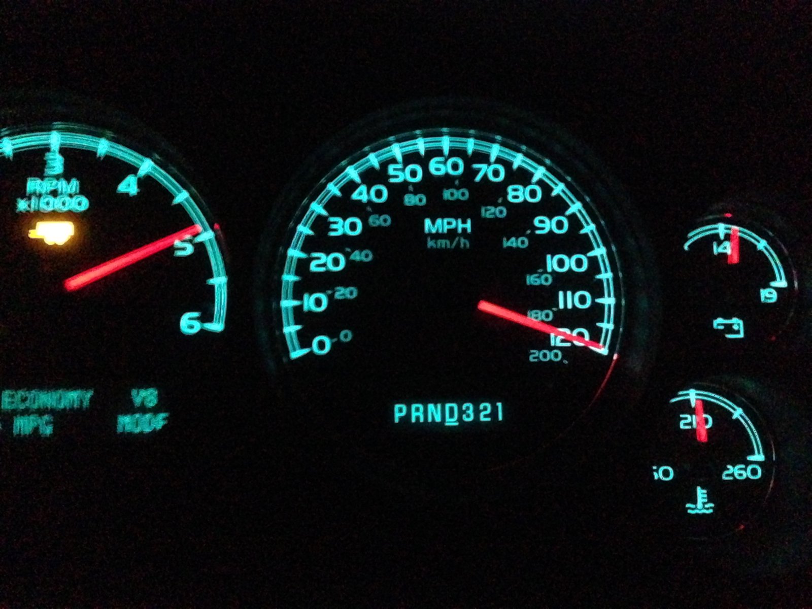

I made some sort of progress so I guess I should use it to update my thread. A few weeks ago I had it tuned by Futral Motorsports mainly just to disable AFM and the rear O2 sensors. Included in the package were a few other small tweaks such as trans line pressure, reduction of Torque Management and removed speed limiter. It wasn't a full-on power tune where they tweak the fuel and timing tables, datalog, tweak, etc. which costs $400+. This was just a $150 tune to kill AFM and allow me to run long tube headers with catless Y-pipe. I'll worry about a full tune when I have something worth tuning, something other than the current 182K-mile 5.3.
Since having AFM disabled, the low-RPM rattle in V4 mode is gone and my fuel mileage is averaging .5 MPG lower than before. At $2.40 per gallon, my original 16.2 MPG calculates to 14.8 cents per mile. Without AFM, a mile now costs me 15.3 cents. That's an increase of half a cent per mile and ten cents per average 20-gallon fill-up (I don't run the tank bone dry between fill-ups).
I can afford the extra $1.00 a month to possibly prevent me from having to spend thousands of dollars to repair or replace the engine. Also, if disabling AFM reduces the ~1 quart per month oil consumption even a fraction of a quart, then the savings in the oil costs alone would make up for the drop in MPG in multiples.
Pertinent pic for mildly dramatic effect:

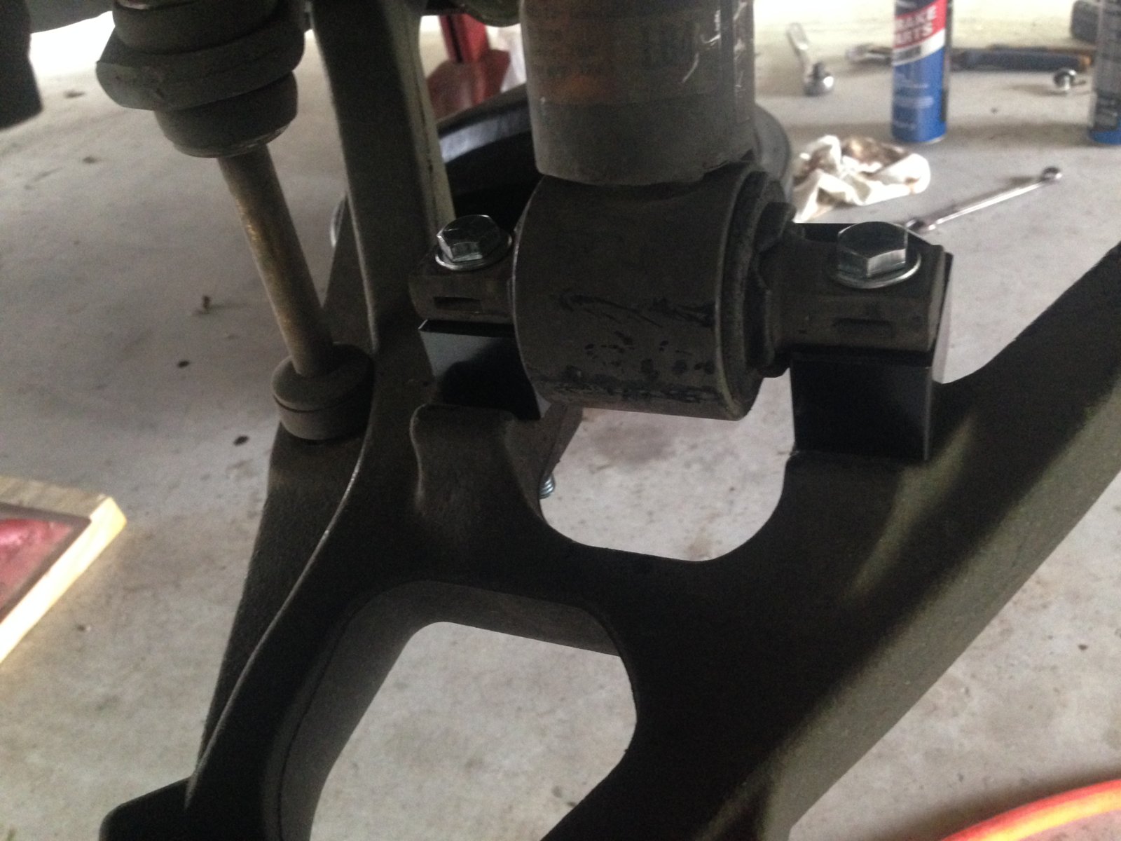

Got Jenn a car last weekend so the Tahoe's mine again. It was due for it's 5,000-mile service so I had it on jack stands in the shop with the wheels off. Since I no longer have to rush to get it back together for kid transit service, I took my time and decided to see how difficult it would be to install those 2" front lift spacers I've had for a few months. Completing one side prompted me to finish it out with the other side, which prompted me to install the 1.5" wheel spacers (studs needed to be trimmed about 5/16"-3/8"), which prompted me to install the 1" rear spacers. It rolled in the shop for an oil change and tire rotation and rolled out with a 2/1 lift and 3" wider stance. Time to get those all-terrains on now.
No before and after pics cuz it was a spur-of-the-moment idea
Quick and easy 2" front lift. I don't care much for the Grade5 hardware, but I'll be headed to a hardware store soon and Grade8 stuff is on that shopping list:

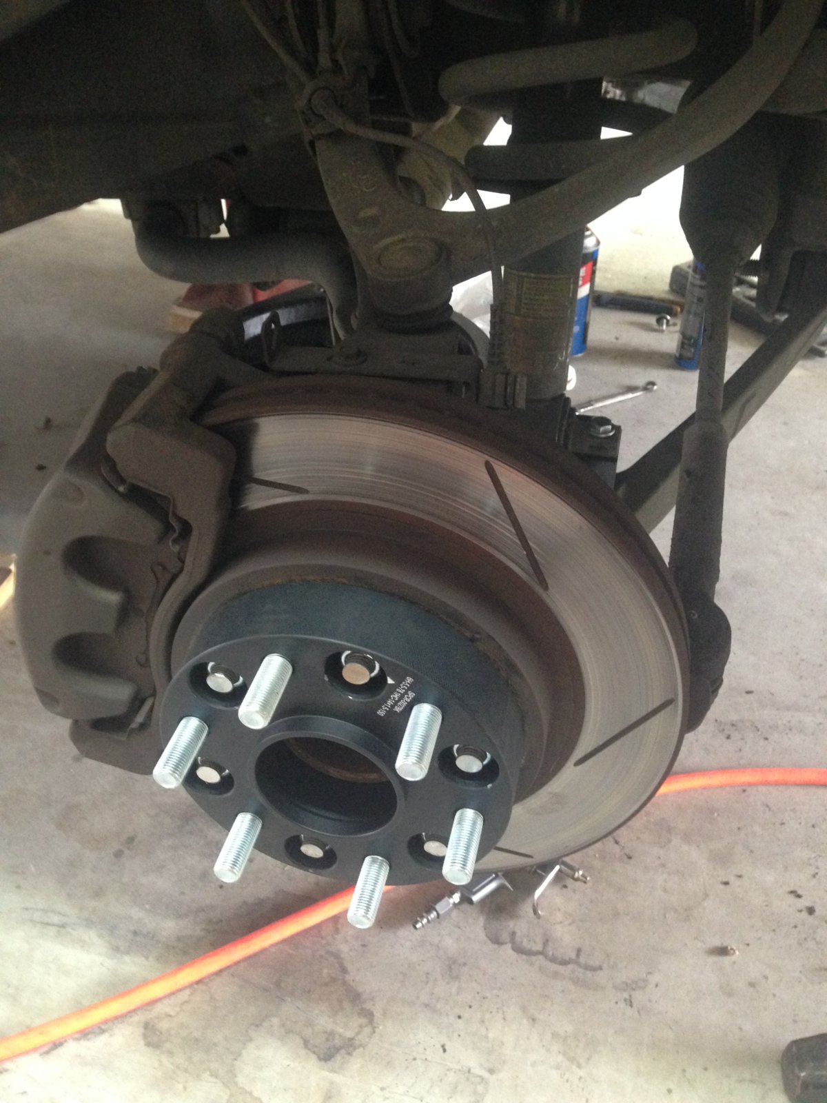

Tahoe's been in my possession again for less than 24 hours at this point and I've already taken my scalpel to it. I'll round off/dress up and cold-galvanize the stud tips later:
Hubcentric wheel spacer installed:

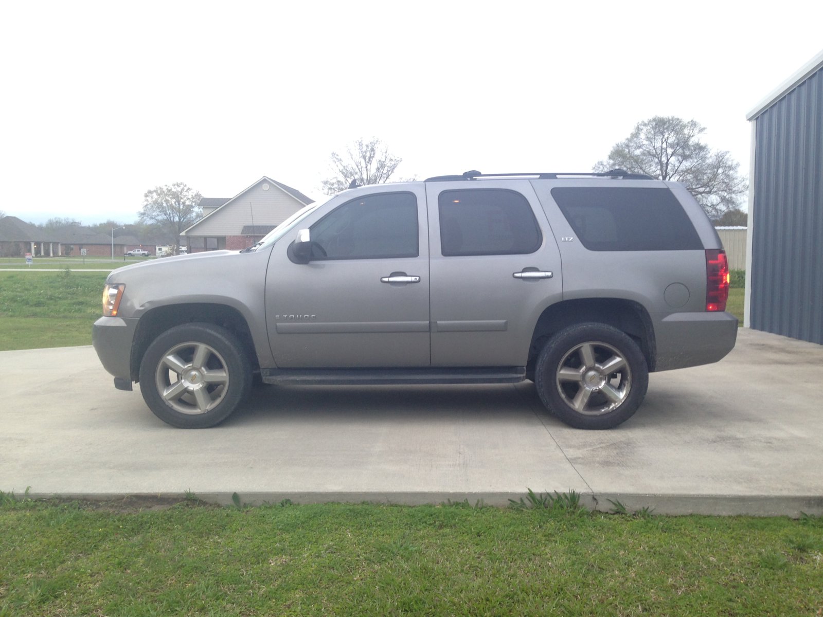

Quick-and-dirty, half-assed cell pic:

Looks good [emoji106]
Sent from my iPhone X using Tapatalk Pro
21,321
30,318
Looks great! Yours, in my eyes because of its color, also looks great slightly lowered. Our RC 2 inch level came in Saturday, just need time now. Don't forget the alignment.
