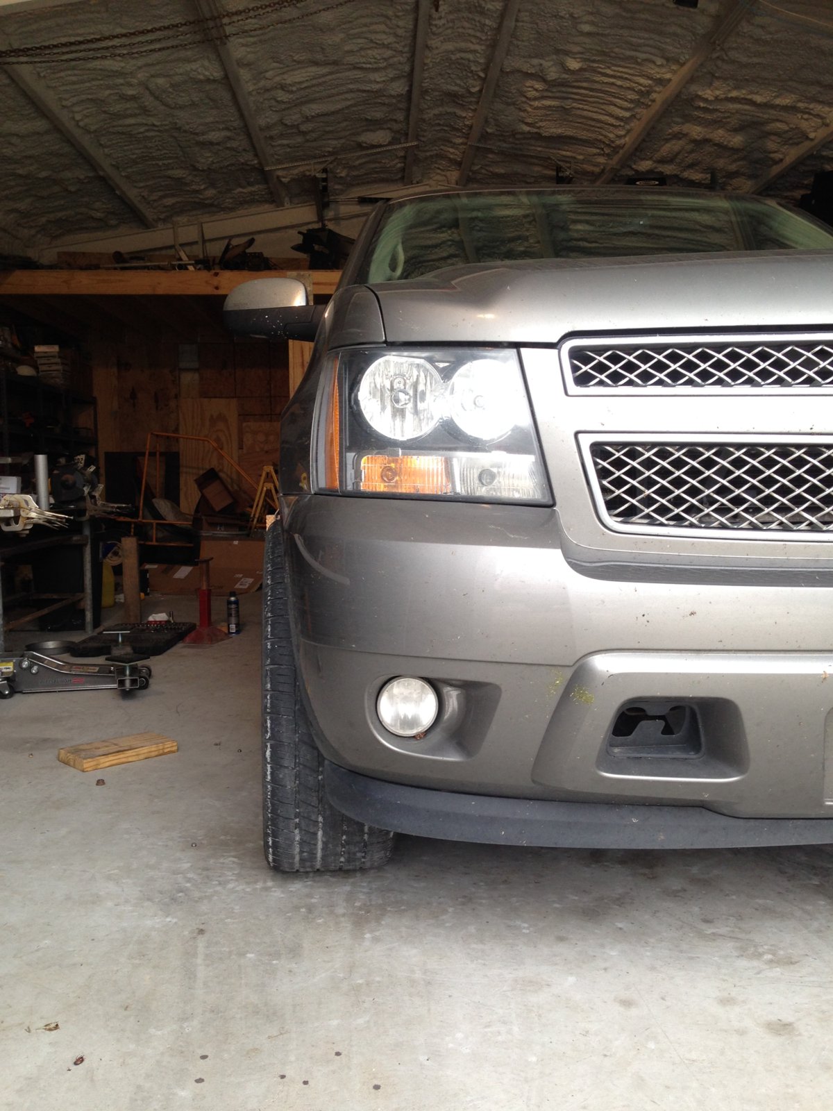

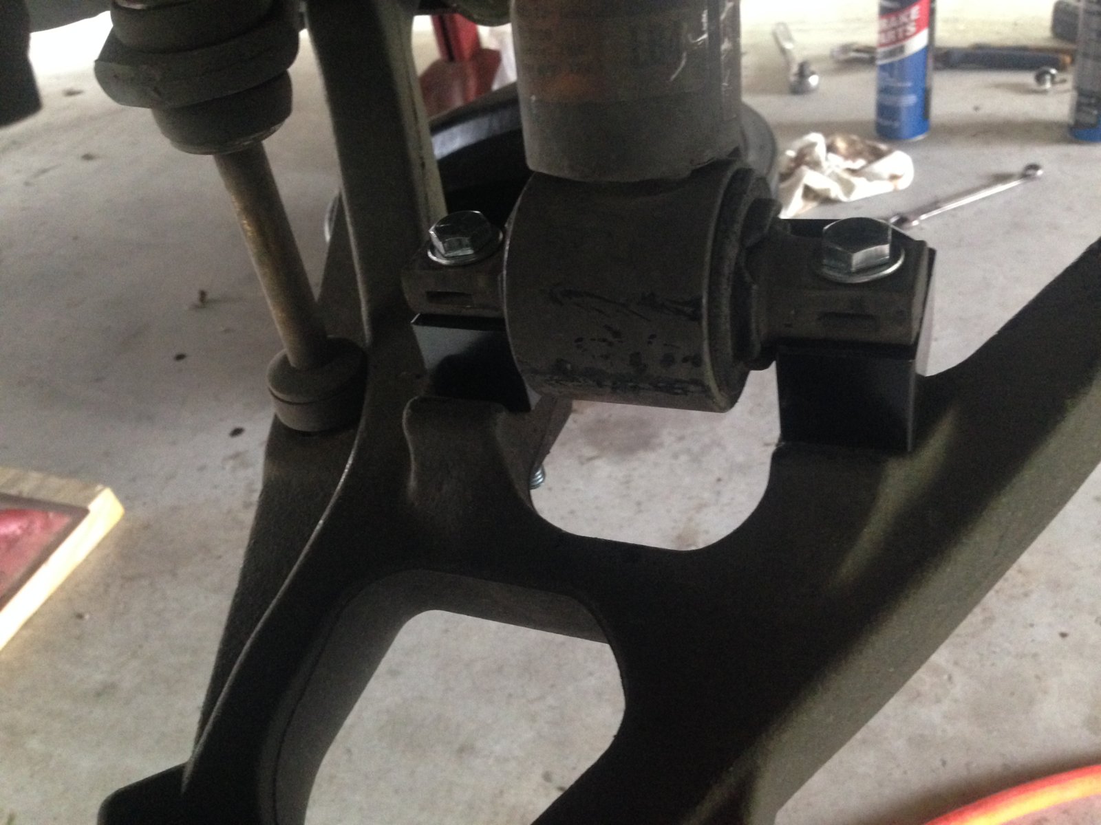

Got Jenn a car last weekend so the Tahoe's mine again. It was due for it's 5,000-mile service so I had it on jack stands in the shop with the wheels off. Since I no longer have to rush to get it back together for kid transit service, I took my time and decided to see how difficult it would be to install those 2" front lift spacers I've had for a few months. Completing one side prompted me to finish it out with the other side, which prompted me to install the 1.5" wheel spacers (studs needed to be trimmed about 5/16"-3/8"), which prompted me to install the 1" rear spacers. It rolled in the shop for an oil change and tire rotation and rolled out with a 2/1 lift and 3" wider stance. Time to get those all-terrains on now.
No before and after pics cuz it was a spur-of-the-moment idea
Quick and easy 2" front lift. I don't care much for the Grade5 hardware, but I'll be headed to a hardware store soon and Grade8 stuff is on that shopping list:

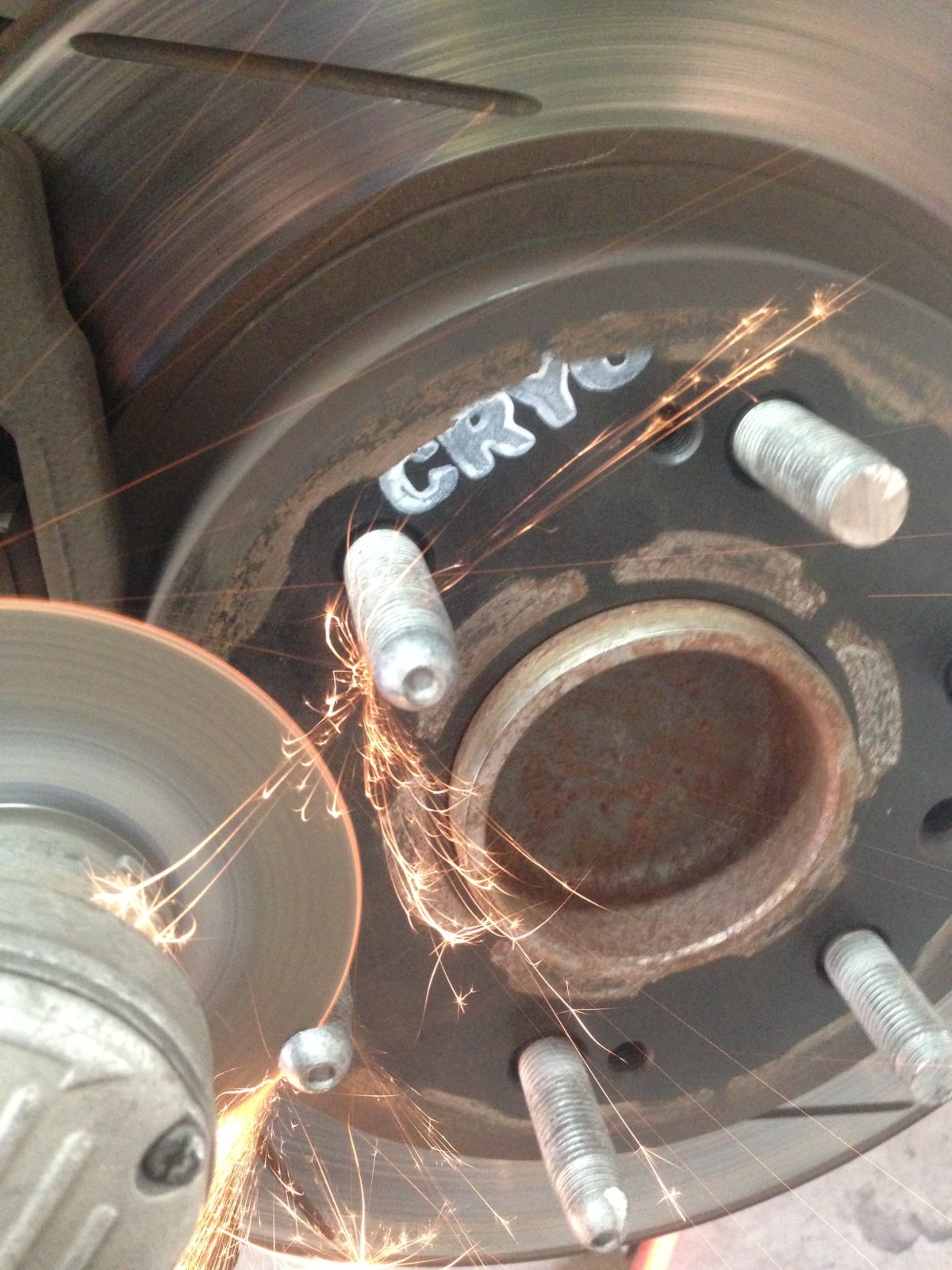

Tahoe's been in my possession again for less than 24 hours at this point and I've already taken my scalpel to it. I'll round off/dress up and cold-galvanize the stud tips later:
Hubcentric wheel spacer installed:
Quick-and-dirty, half-assed cell pic:
Side profile jackasss, need to see how far them there tyrs stick out...

Just read the install instructions on their site and they were basically the same as for mine. I didn't undo any balljoints or steering links. Actually, I didn't read the instructions (packing materials :p) until I was cleaning up. Just ran the sway bar link nut almost all the way off to give the arms more travel and removed the two bolts holding the bottom of the strut. Used a long pry bar to push the arms down enough to slip the spacer into place and a homemade podger spike to align the holes. Yours being a 4WD may require the extra work, though.

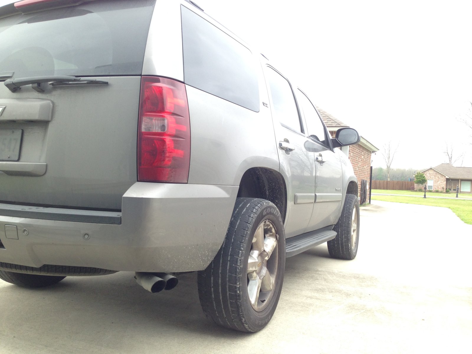

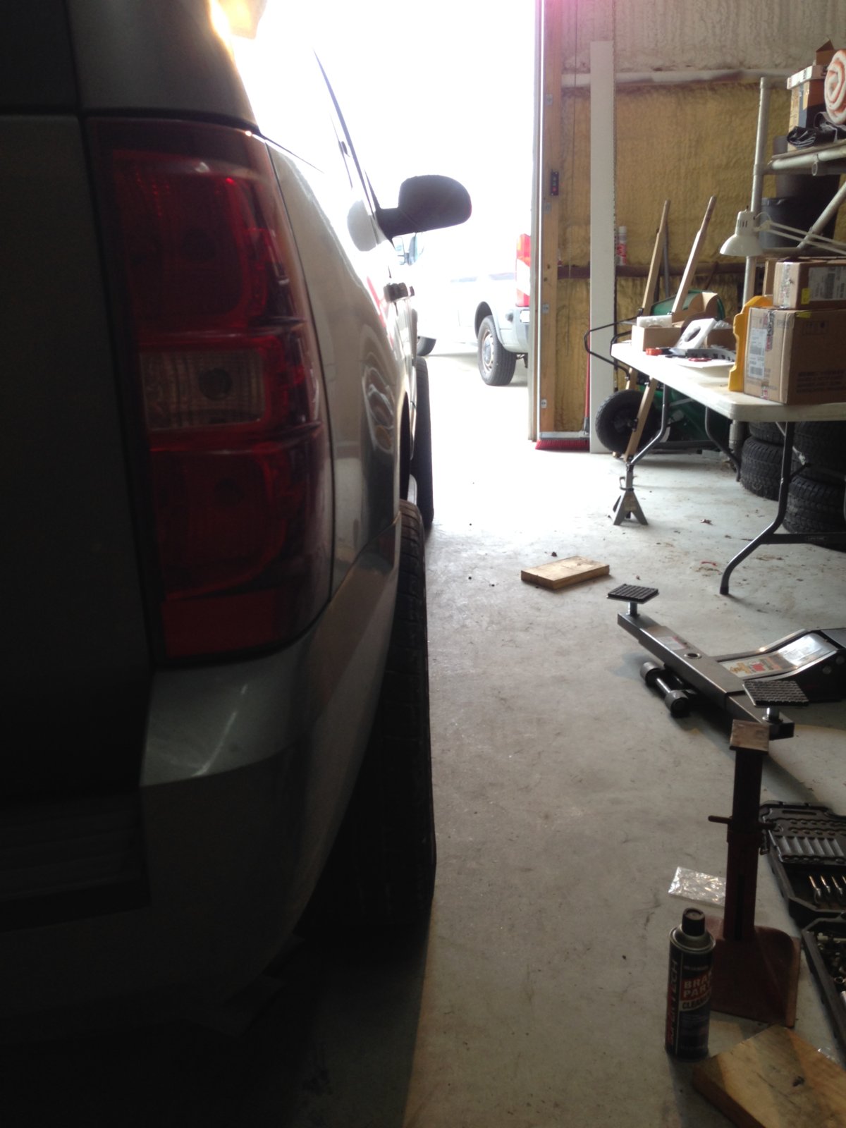

Tire stickage outage pics. I know it's filthy, I'll wash it when it quits raining. It's hard to get the feel for it in the pics, but that back 3/4 view is about the best angle for showing it's new "tougher" stance. More aggressive tires (visible at bottom right of second pic) would compliment and complement the look.

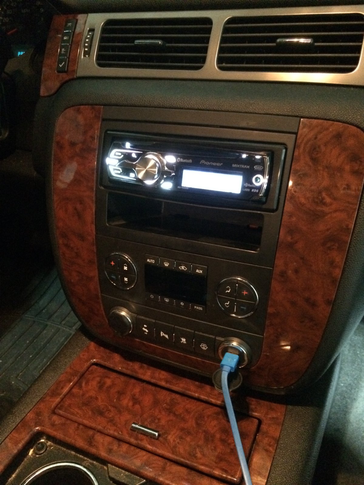

I've always wanted to be able to stream music via Bluetooth so I pulled the factory nav HU to sell to fund a new HU. In the meantime, I was gonna put the original "standard" HU back in. On the shelf next to the original HU was the Pioneer single DIN, dash kit with cubby and interface and antenna adapters I bought for my old Express 2500 work van. The interface is an Axxess GMOS-LAN-01 and Axxess's site says I need the GMOS-LAN-02 for my Tahoe since it has the factory Bose-amplified system. I did a quick twist-n-tape job to test it since I'm considering bypassing the Bose amp and running aftermarket amps. When I plugged it in, everything worked! Volume, fade, balance... everything that should work does. Only the rear seat controls and steering wheel controls don't work, as expected.
Went from this:
To this:
Not only is it louder than the Bose HU, I was able to get better sound from it since it has more EQ controls. It working was a pleasant surprise and I finally had Bluetooth. As a bonus, with a data cable from an old Garmin sat nav, I was able to keep the factory dash USB port functional.

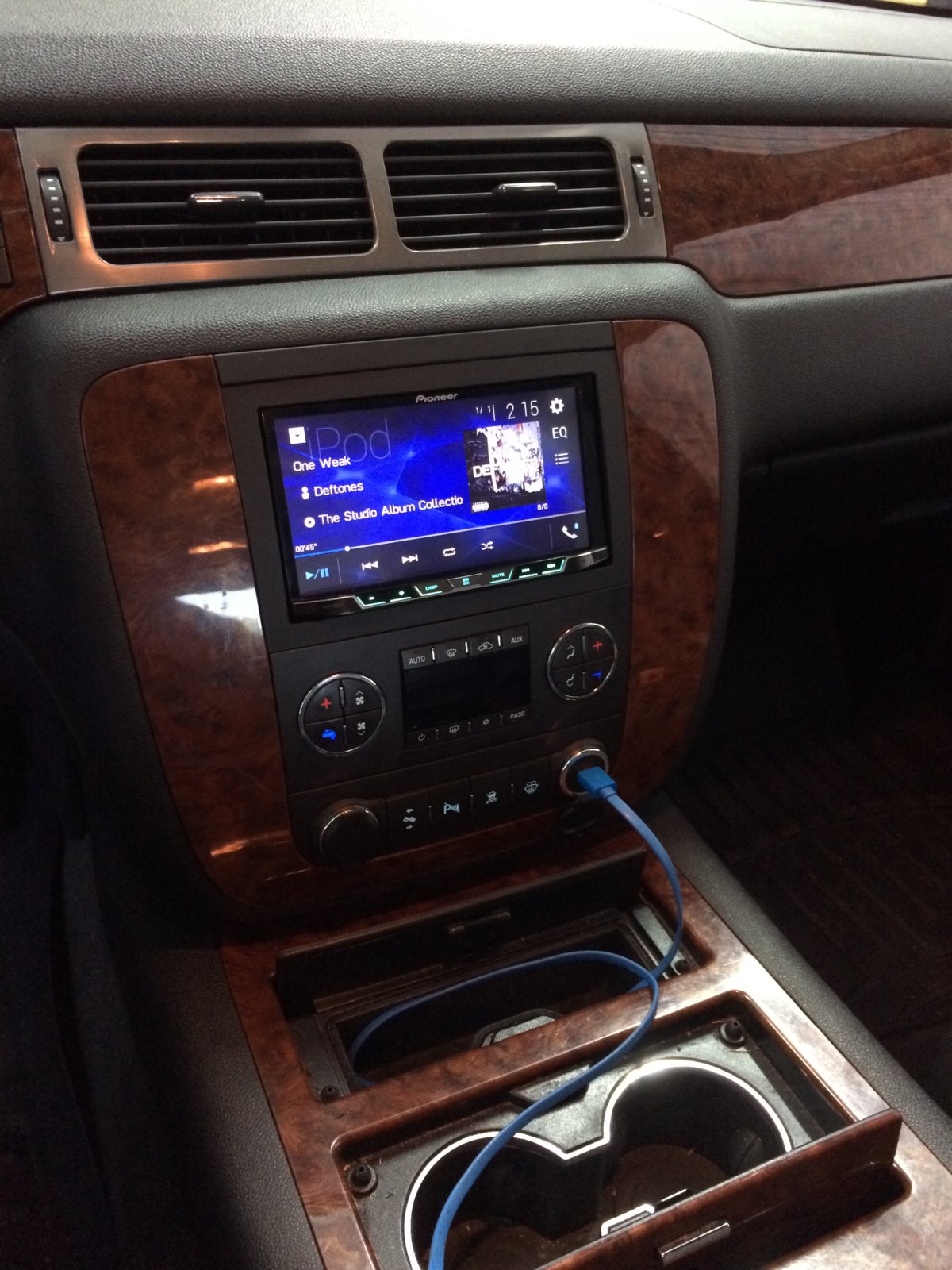

New HU is in! It's a Pioneer MVH-300EX. It's what they call a "multimedia receiver". It has just the things I want and nothing else: Big screen, fine-tunable button illumination color, radio, Bluetooth, aux input, USB, F/R/Sub RCA outputs, video RCA output, phone mic, 13-band EQ, backup cam capability, video capability from USB, etc. No CD/DVD, no nav, etc. I got the Axxess ASWC-1 steering wheel control adapter but I can't get it to work other than powering up and the LEDs flashing.
The Metra kit matches the dash plastic perfectly and is a really nice fit. It needed only minor tweaking. I still need to work on the top corners cuz the factory burlwood trim piece isn't sitting in all the way. Probably just need to do some minor clearancing with the Dremel.

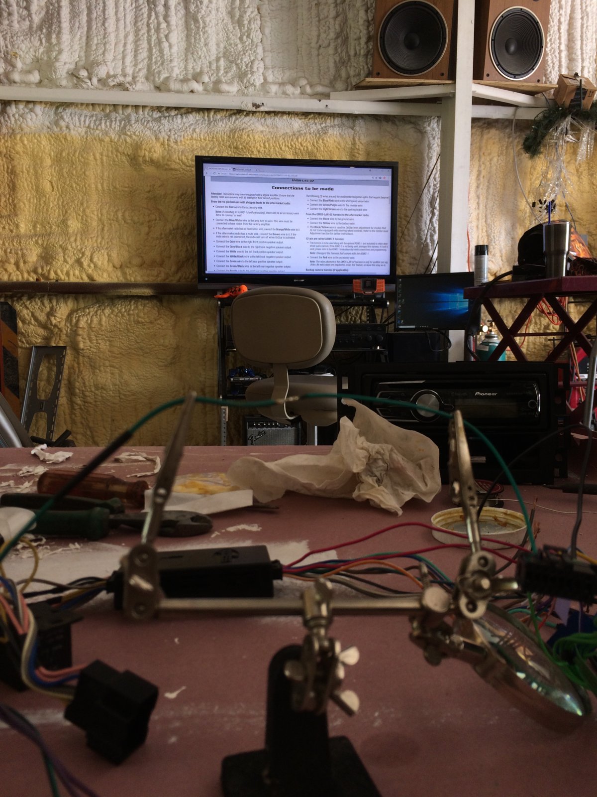

Started by setting up a work area on a table I already had out for another project and pulled up the wiring diagram on the big screen:

Aaaaand the money shot. I like how clean and simple it looks with minimal buttons. I still need to tweak EQ as well as the button color and brightness to perfectly match the mint green OEM color scheme:
