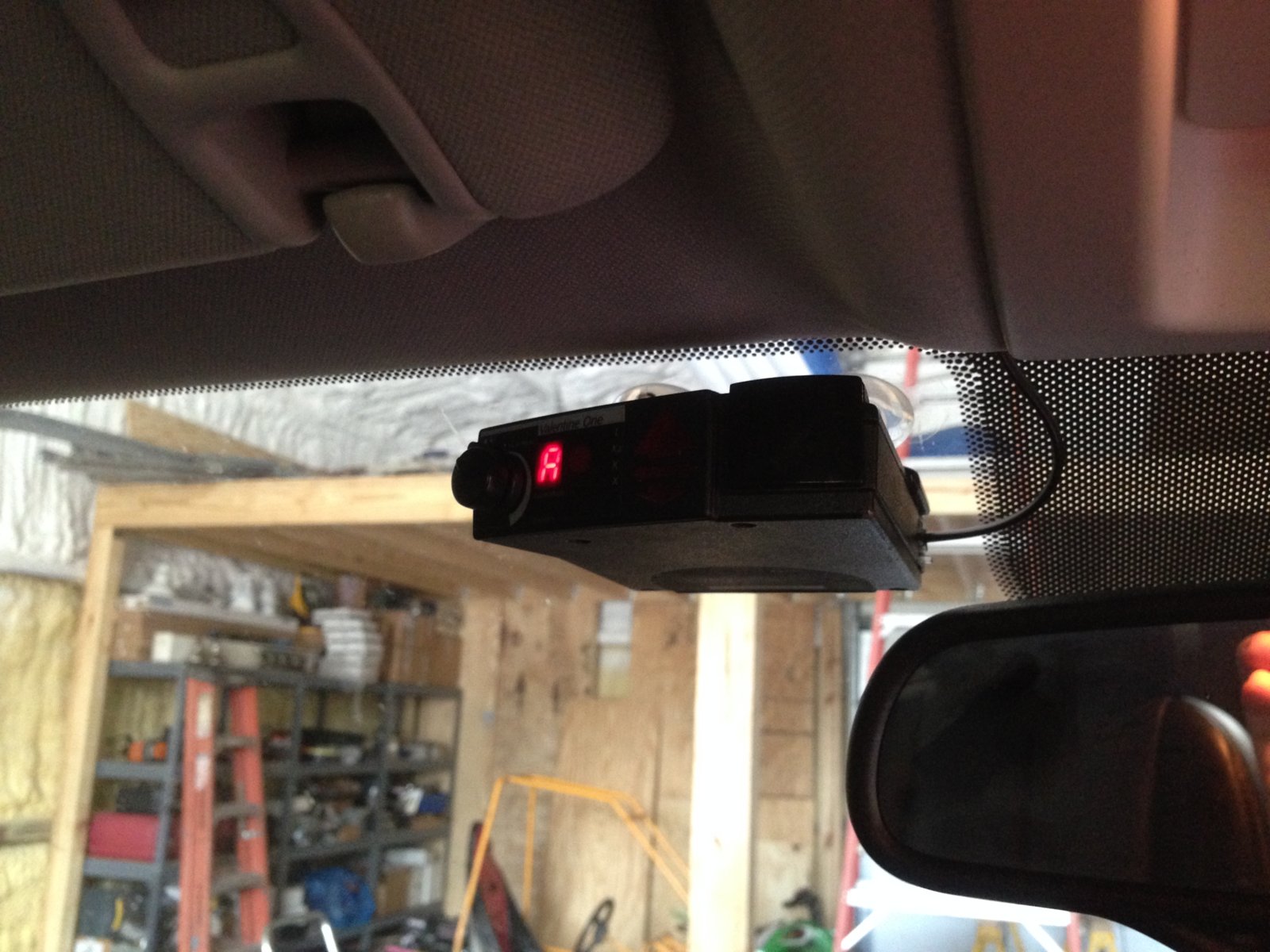

I finally did this. I found a switched 12-volt wire on the passenger side of the dash and ran a spare phone cord to it. Sure, there may be a switched source in the mirror harness, but probing the connectors on the side of the dash with my meter to find what I needed and tucking a flat phone cord in the headliner was way easier. I spent less time actually doing this start-to-finish than I did researching where I MAY find a switched source.

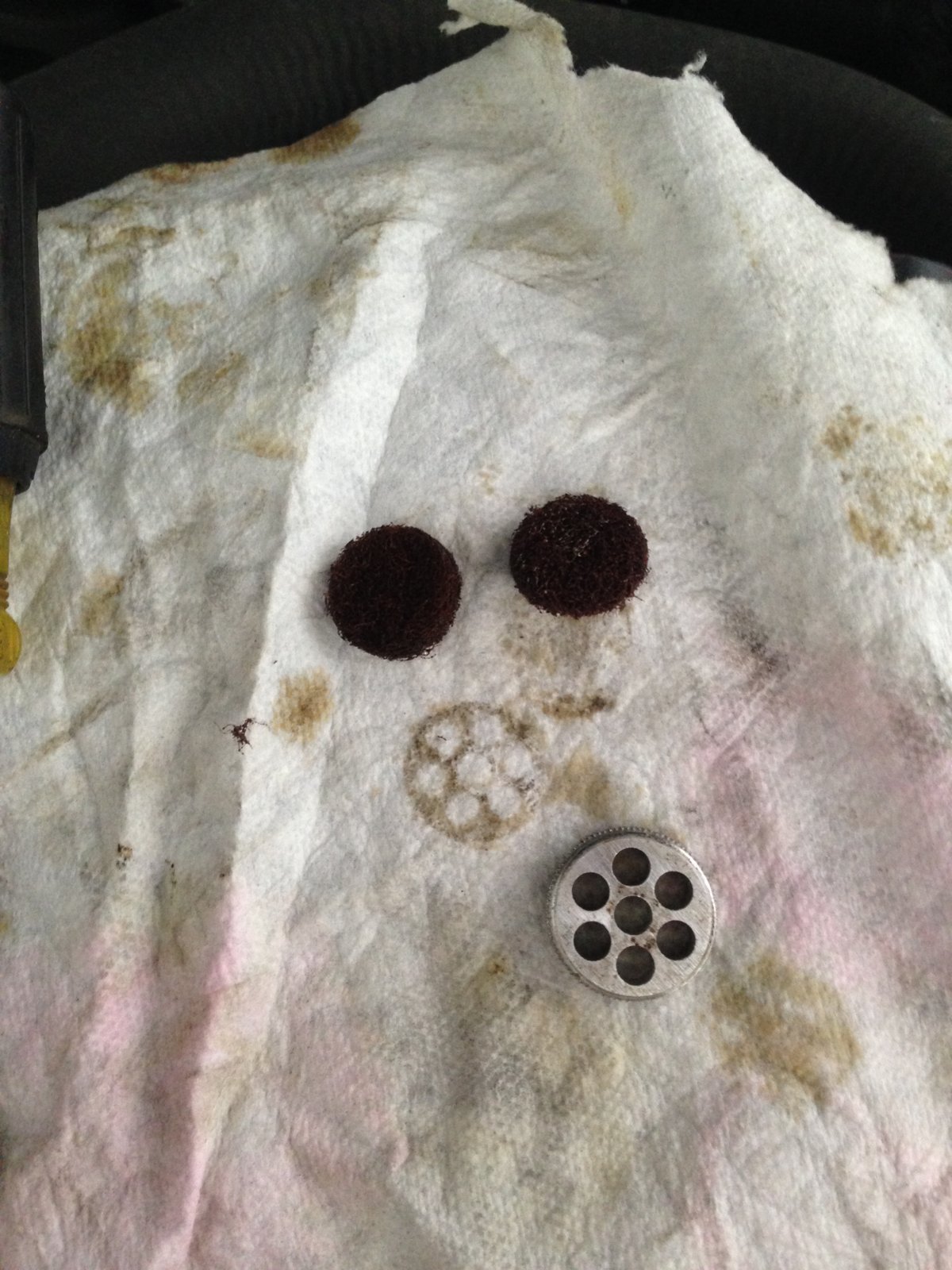

I think I can see why they would have the air come in to the top and through the filters first, then out through the body and into the intake.
img_2539-jpg.183201
The oily air comes in and is "stalled" by the filters. The oil coalesces in the filters then runs down through the seven holes in the round aluminum piece to drip to the bottom of the can. At this point, it is too heavy to ride the air stream and can't be drawn up into the tube in the side of the body to be pulled into the intake manifold. If this happened in the reverse order with the inlet coming into the side of the can, the oil mist would still be in the air inside the can and it would have to pass through those seven holes then get caught in the filters. But, it relies on gravity to let it fall back down into the can. This is kinda hard to do when you have a vacuum pulling on it, trying to hold it up. At least with the flow going in the direction as intended, gravity is helping because the collected oil falls to the bottom and can't be picked back up into the air stream. Also, if the oil collected in the filters is dense enough, it can restrict the flow, raising the vacuum acting on it. This will make it hold in the top even more and be pulled into the outlet hose and ultimately into the intake manifold, defeating the purpose of the can. The body of the can would basically just be like a larger diameter inlet hose.
So, I'm fine with the flow going as the designers say. Maybe it's just that this design is not as efficient/effective as it possibly could be. Maybe the current design isn't "bad", it may just be "insufficient" for the amount of scrubbing that needs to take place My simple test for now is to add a second stage of coalescing filtration- just add another filter to filter the filtered air.

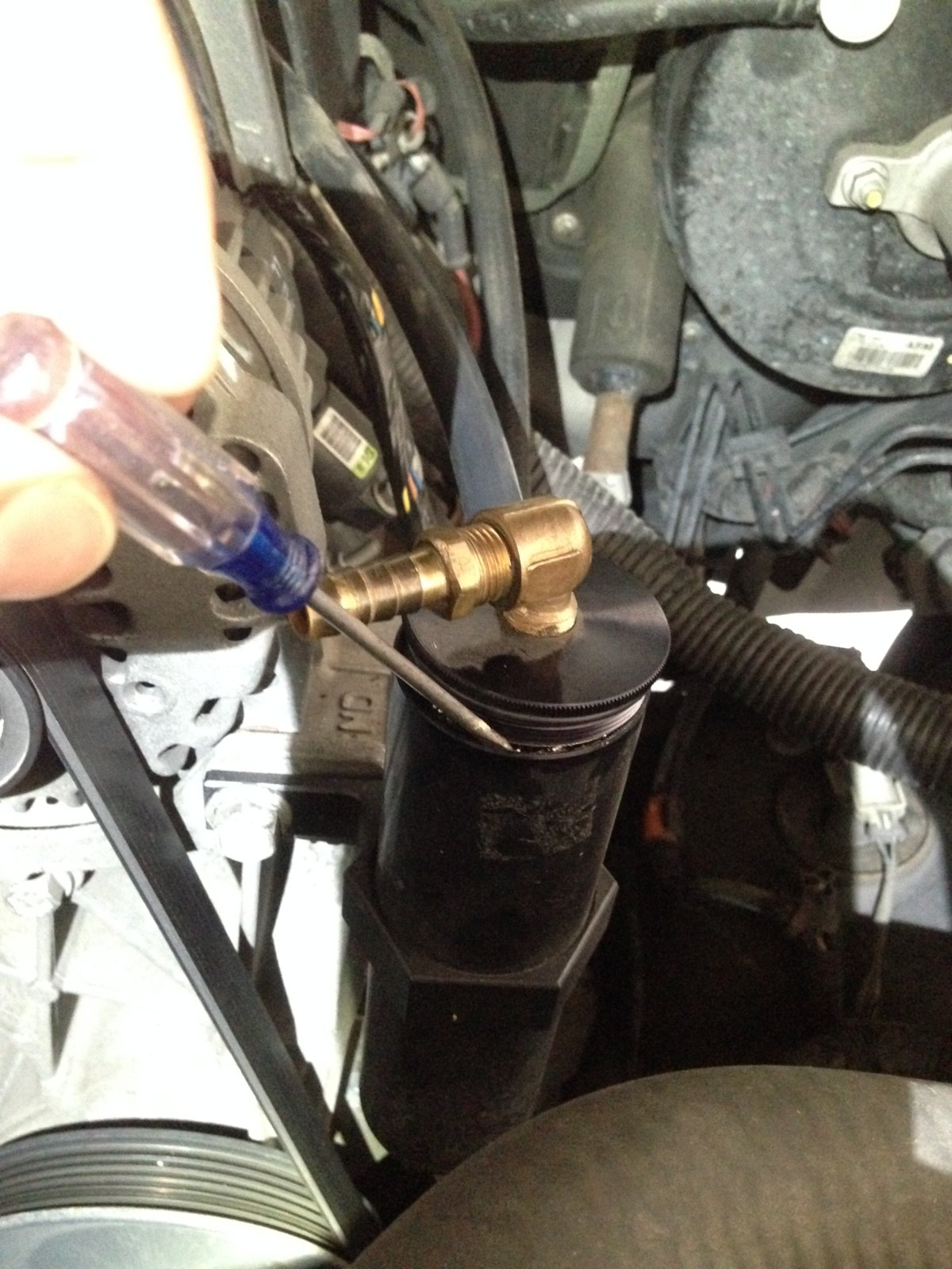

It's simple. Just slip a stainless steel scrubber around the filter tube:
img_2541-jpg.183204
It looks like a mess in that pic, but the center is still open so the oil draining out of those seven holes can drip straight to the bottom. I thought about using some thick aluminum or stainless wire to make a support to hold the scrubber up in position so it wouldn't fall down into the bottom of the can. But, when slipping it into the can, I had to use a small flat blade screwdriver to help it clear the threads and feed it into the can:
img_2542-jpg.183205
Between this friction and the exposed threads of the outlet fitting protruding into the can "snagging" the scrubber, I don't think it'll fall down.
On the flip side of all this, I really don't have a way to test the effectiveness. I did pop off my intake tube (Airaid MIT) to (1) inspect the inside to see how well the AEM filter was doing and (2) to look into the manifold to see if there was still any puddled oil.
I'm very pleased with the cleanliness of the inside of the intake tube. I was a little disappointed, but not surprised to see the light glimmering off the puddled oil at the back of the manifold. I'll address this when the motor's torn down for a cam swap/AFM delete. At that time, I'll see if there are additional components I can add to the PCV system to improve the filtration as much as physically possible. Maybe it just needs progressively finer methods of filtering the air, ending with something like a fuel filter like this:

I don't recall, but I can easily check if someone wanted to know. I was reluctant for so long to even probe around because all I read about was how there are no switched 12V sources or maybe there's only one hard-to-find one and everything else was data circuits. Well, I quickly found a ground and then probed the larger wires. My second try had 12.xx with key on and 14.xx with engine running so it definitely wasn't a data circuit. Just one of those things that I should've tried for myself before diving down the research wormhole.

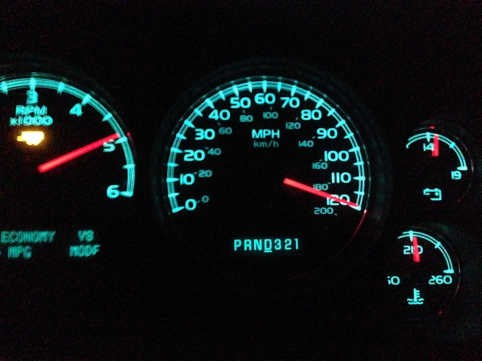

I made some sort of progress so I guess I should use it to update my thread. A few weeks ago I had it tuned by Futral Motorsports mainly just to disable AFM and the rear O2 sensors. Included in the package were a few other small tweaks such as trans line pressure, reduction of Torque Management and removed speed limiter. It wasn't a full-on power tune where they tweak the fuel and timing tables, datalog, tweak, etc. which costs $400+. This was just a $150 tune to kill AFM and allow me to run long tube headers with catless Y-pipe. I'll worry about a full tune when I have something worth tuning, something other than the current 182K-mile 5.3.
Since having AFM disabled, the low-RPM rattle in V4 mode is gone and my fuel mileage is averaging .5 MPG lower than before. At $2.40 per gallon, my original 16.2 MPG calculates to 14.8 cents per mile. Without AFM, a mile now costs me 15.3 cents. That's an increase of half a cent per mile and ten cents per average 20-gallon fill-up (I don't run the tank bone dry between fill-ups).
I can afford the extra $1.00 a month to possibly prevent me from having to spend thousands of dollars to repair or replace the engine. Also, if disabling AFM reduces the ~1 quart per month oil consumption even a fraction of a quart, then the savings in the oil costs alone would make up for the drop in MPG in multiples.

It got there surprisingly quickly. I live in the far suburbs and it was kinda late in the evening on a moslty empty 4-lane highway. I was the only one for a couple of miles. I turned onto the highway and rolled into it. Didn't wanna jab it to the floor cuz I don't know the condition of the trans and I wasn't sure how much they reduced the TM. It pulled satisfactorily until I let off. Funny enough, I was passing State Capitol Raceway around the time I snapped the pic. I'm not one for super high speeds, especially in this brick. I prefer quick acceleration over top speed. So I probably won't be doing this again.
