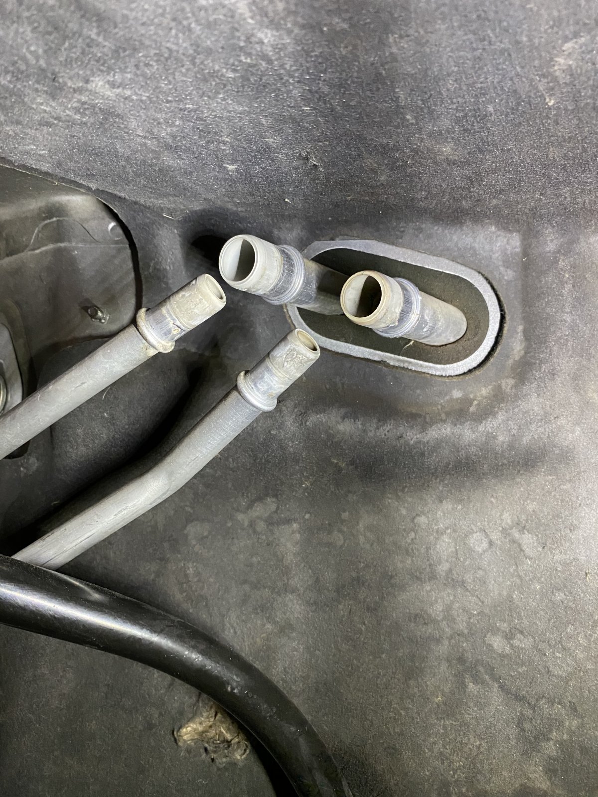

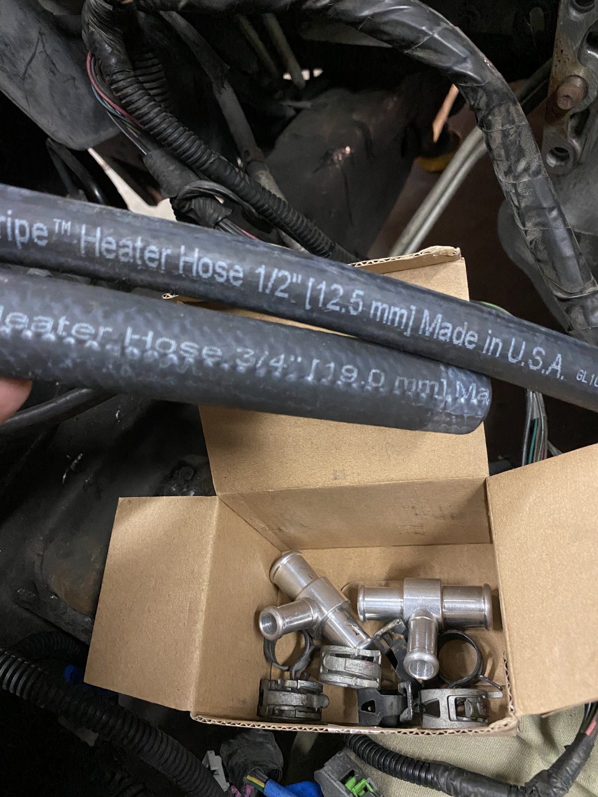

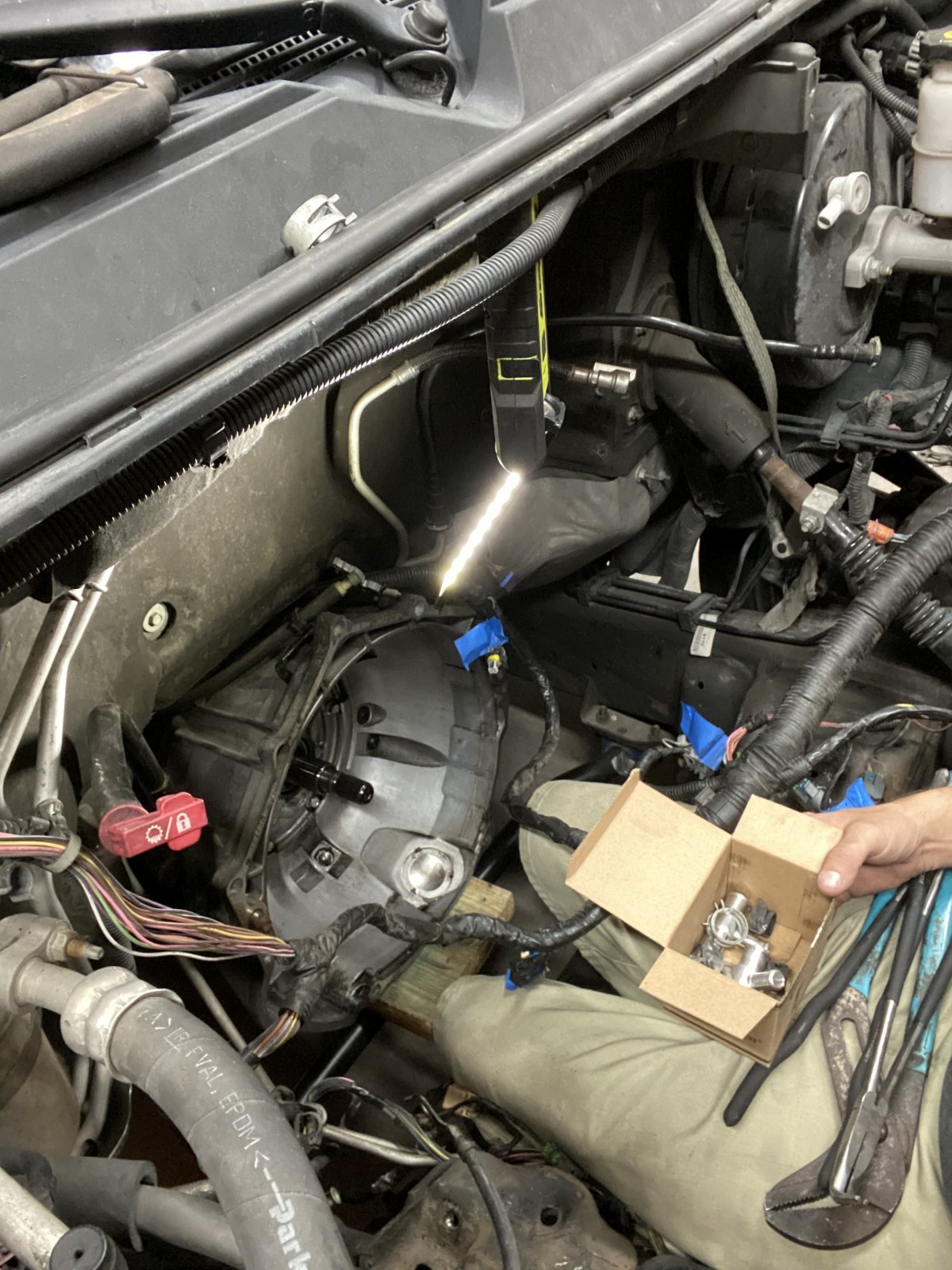

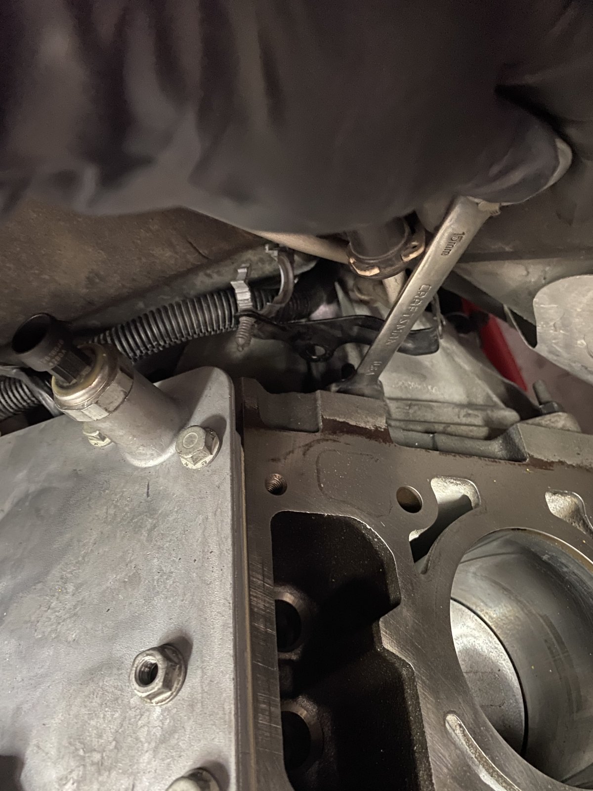

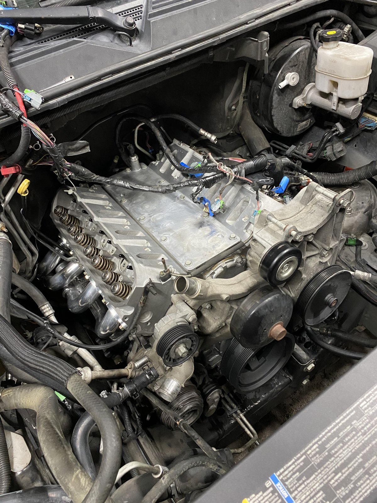

Since I finally got the all hose clamps I needed from the salvage yard, I was able to install the heater hose connectors. I definitely wanted this to be done before the engine was back in.
3/4" heater core connectors and 1/2" rear heater core connectors. The hoses to the two nipples on the water pump are 5/8":
About 12" each of 3/4" and 1/2" heater hoses and box of 3-way Ts and factory hose clamps (factory from GM, Ford and Honda :D)
Semi-comfy seat on cross member in engine bay:

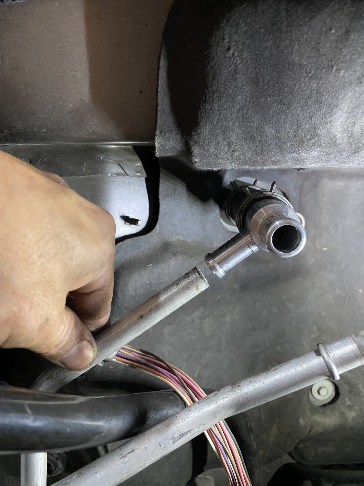

The 1/2" tubes were too close, so I trimmed them down:
Minimal, but adequate gap and perfect alignment:

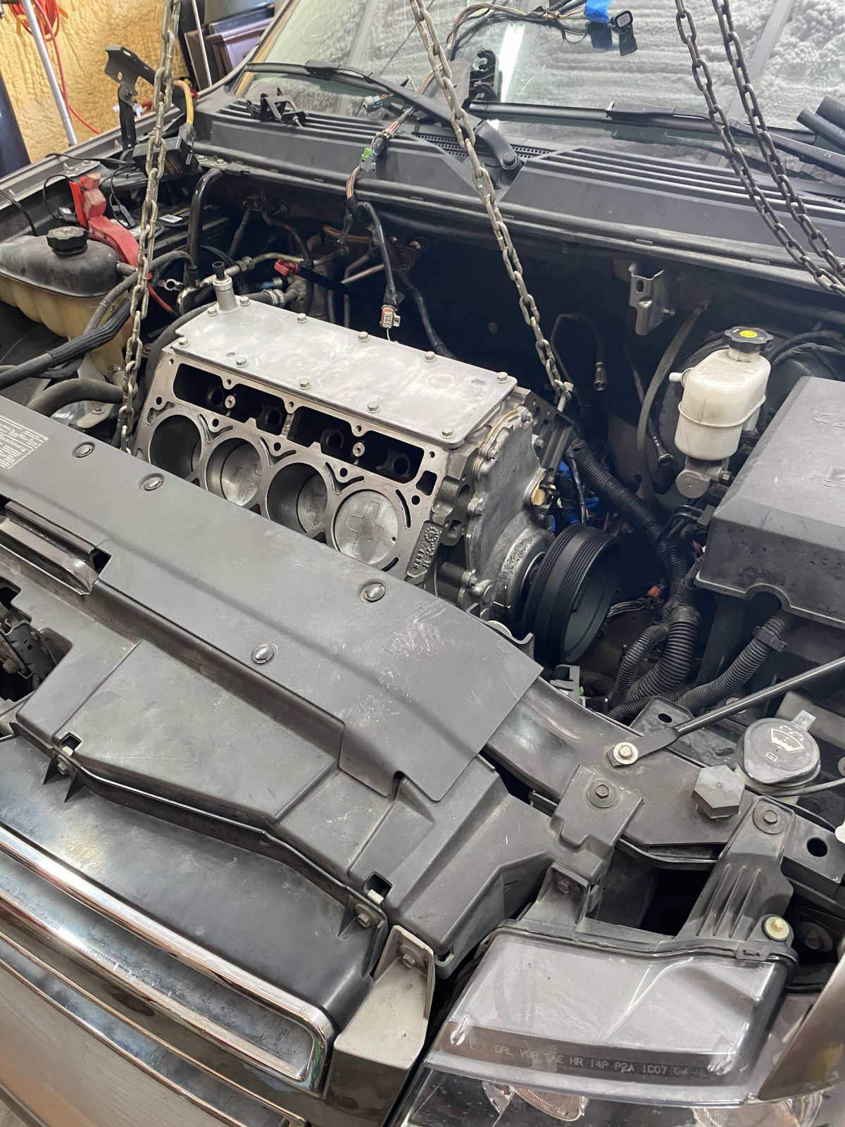

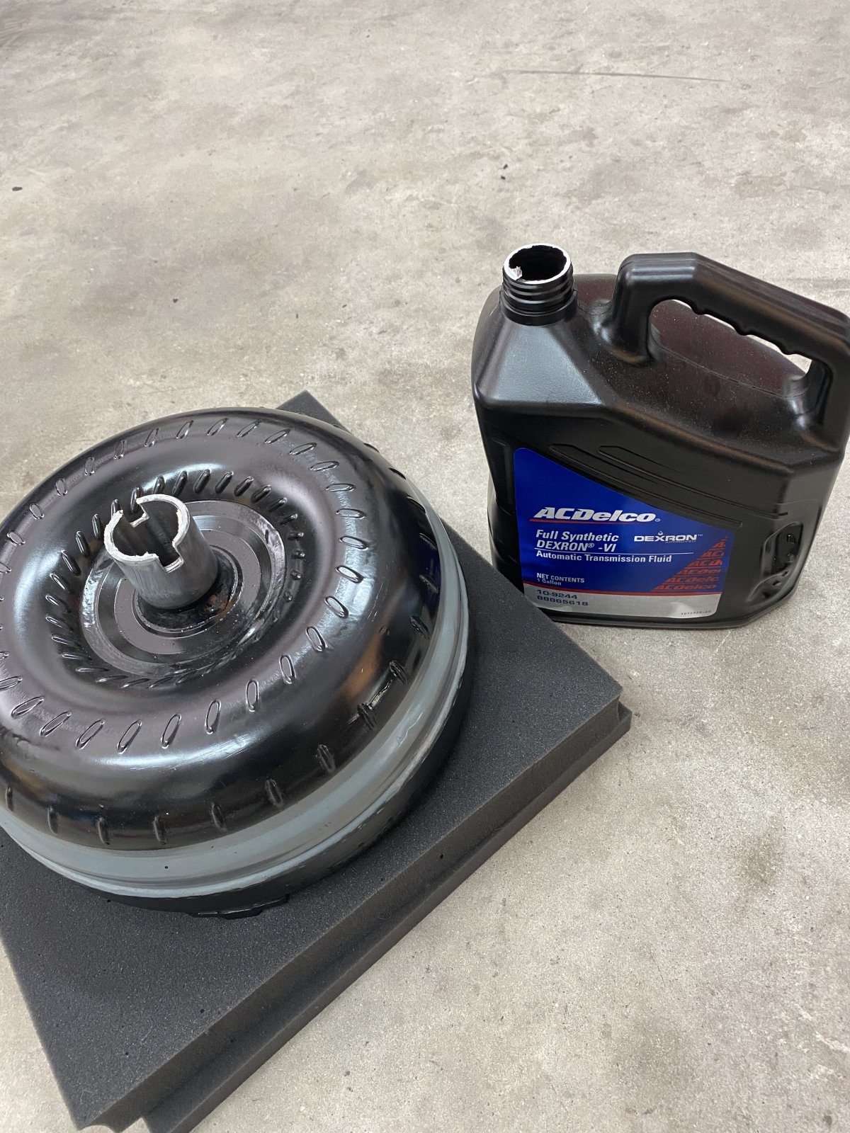

Going back to last weekend, I hit the shop around 10AM Saturday morning starting with an empty engine bay. I installed the LS3 valley cover with new gasket then hung the engine on the chainfall so I could get the engine stand outta my way. Then I installed the torque converter-
Filled it with a little over a quart of Dexron VI full synthetic:

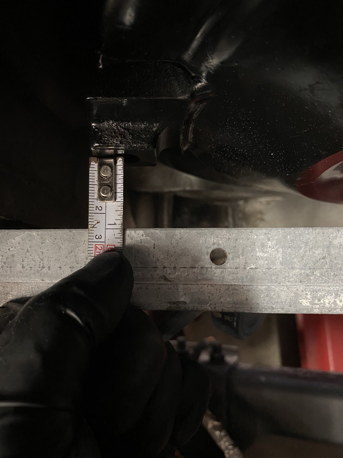

All the specs I read online called for 1.125" +/- .125" recess. After sliding it on, turning, removing and repeating a couple times, I came up with 1" every time. I expected it to be closer to the 1.25" max spec. But, it clicked/clunked as it should every time and was at least in spec, so I moved on.
Up close:

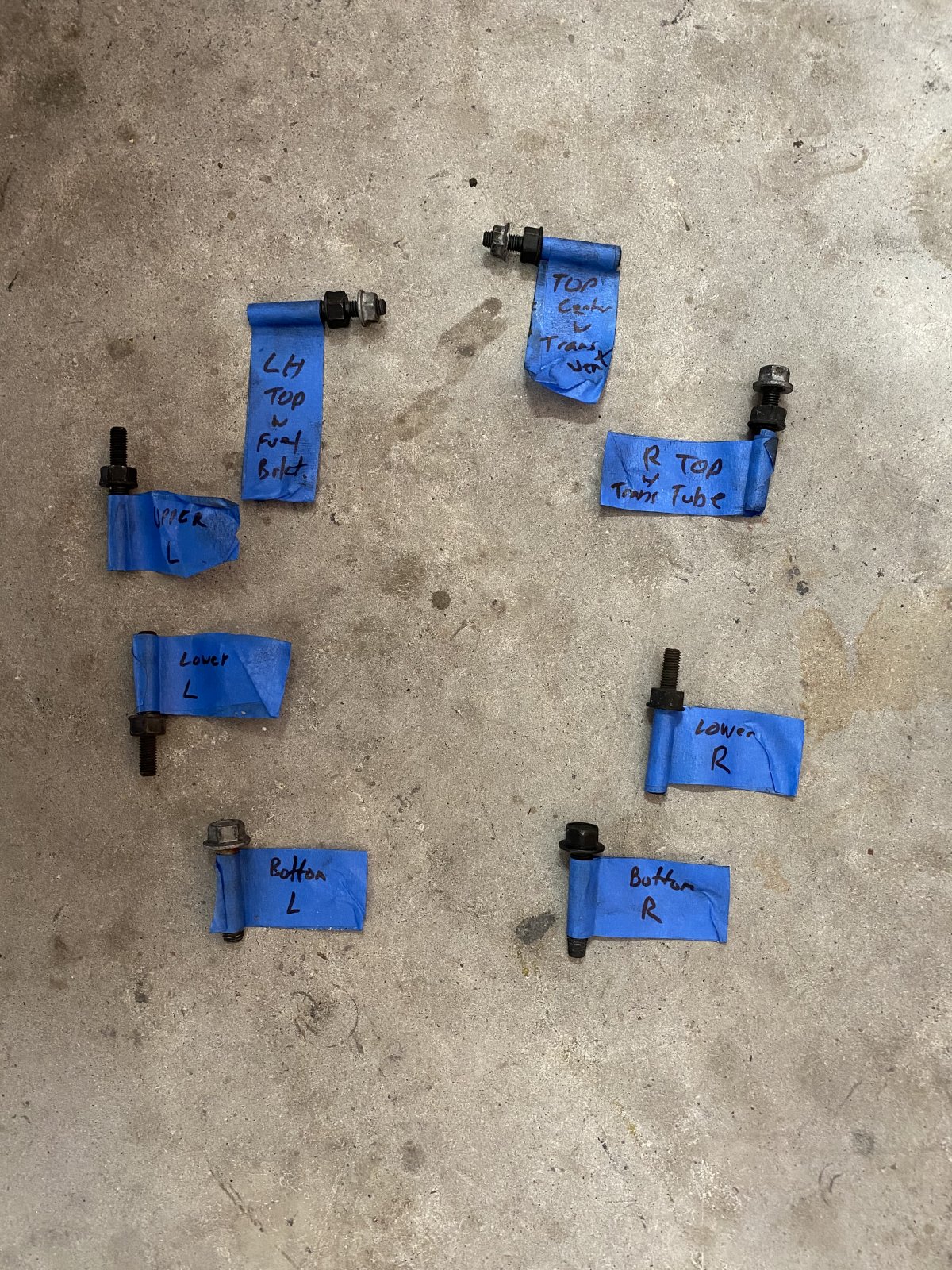

EVERY bolt has it's own place @tgui:
This is why I install the heads after I have the block bolted up. Super easy access to the top four bellhousing bolts and the nuts that hold the various brackets:

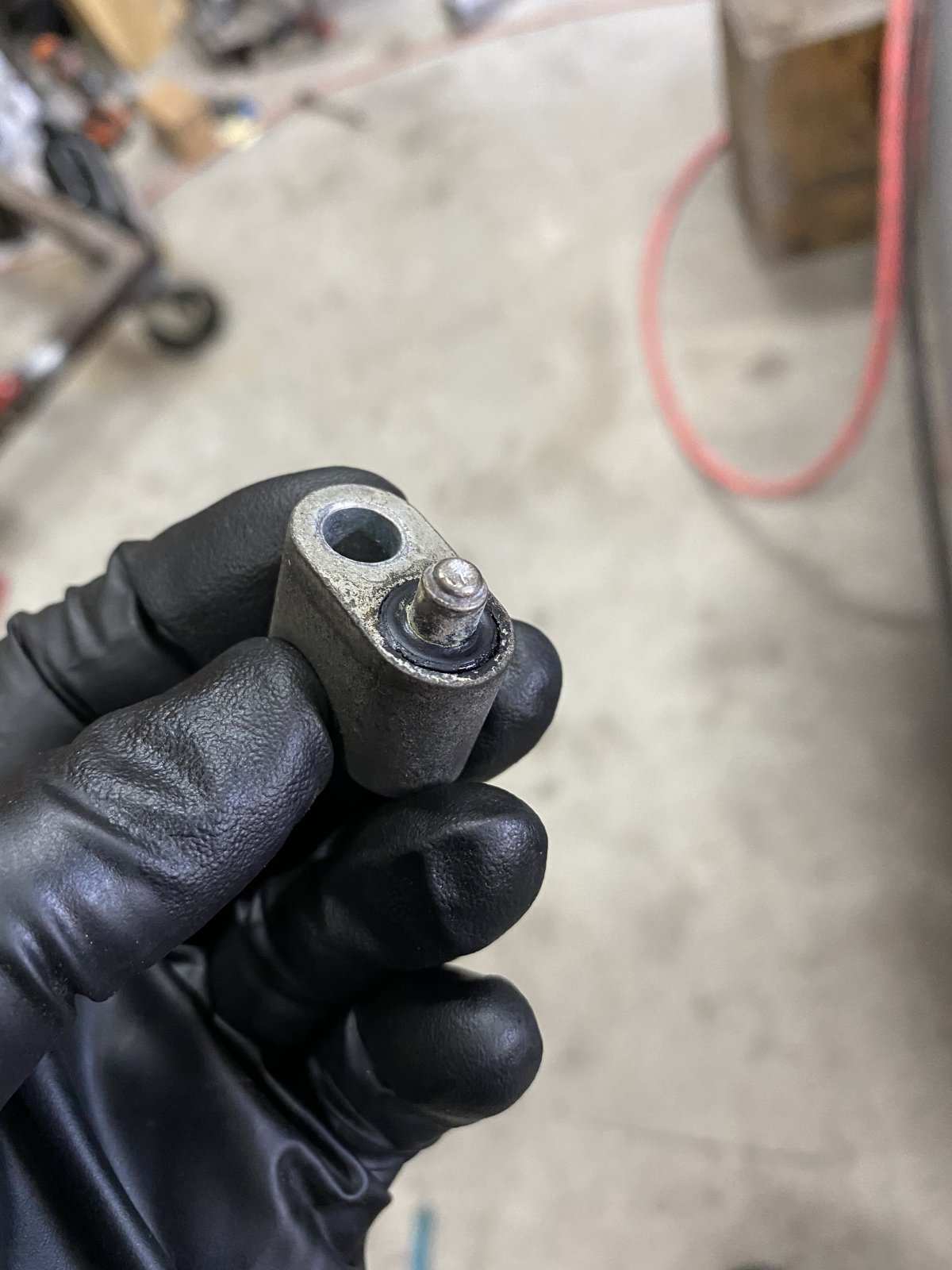

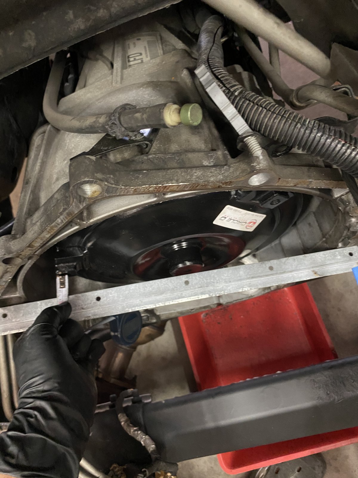

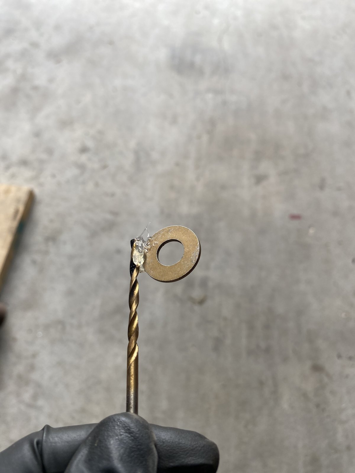

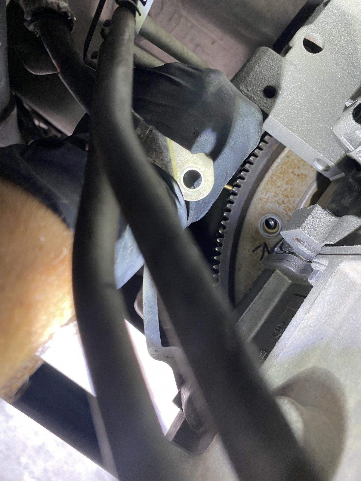

After using a set of drill bits to measure the gap between the flex plate and converter pads, I determined that the thinner shims provided by Circle D would net me right at the spec'ed .125" gap. I hot-glue the shims to a drill bit to hold it in place while I get the bolt started:
...Works like a champ!

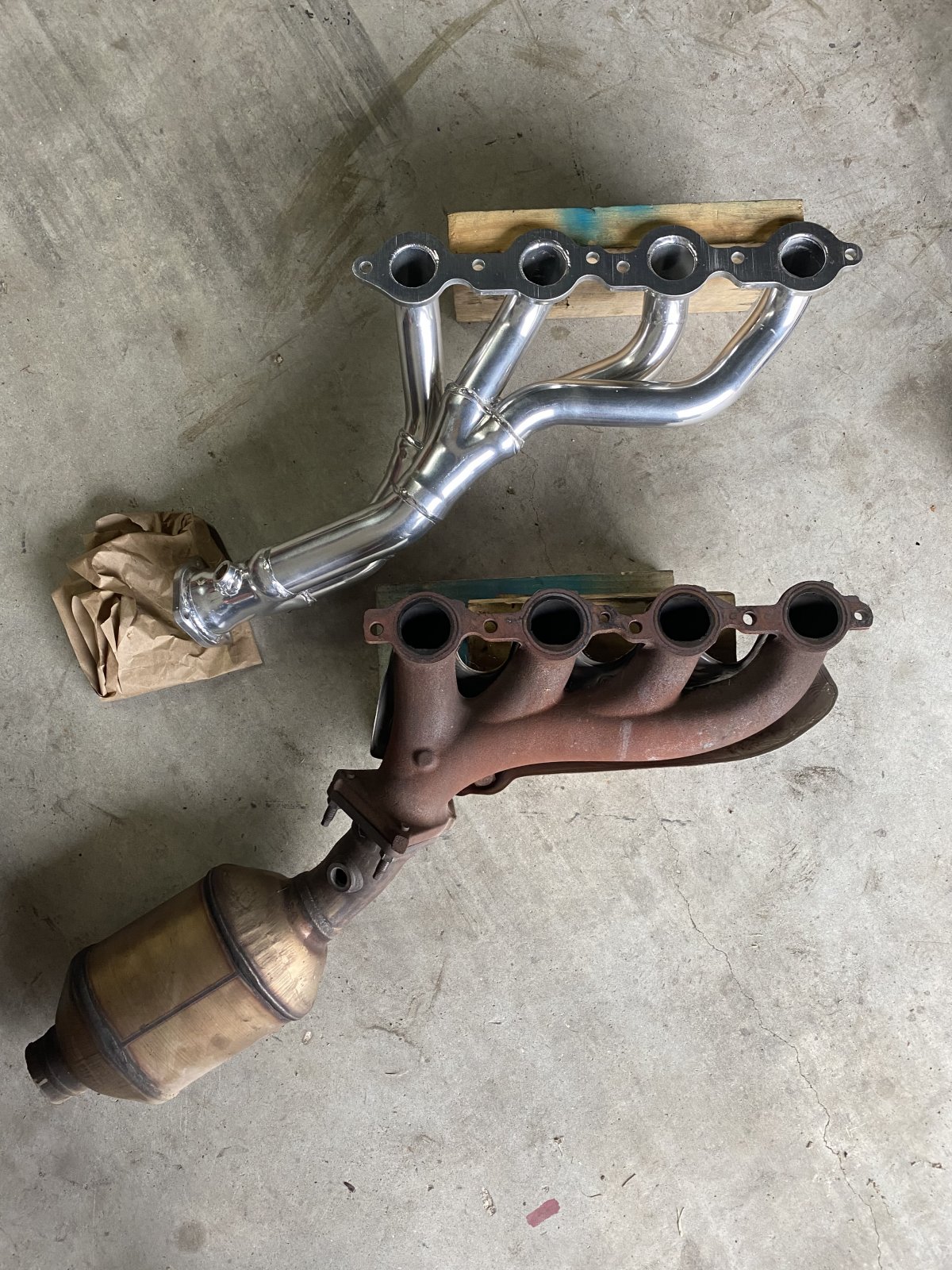

Comparing the Doug Thorley Tri-Y to the stock manifolds:

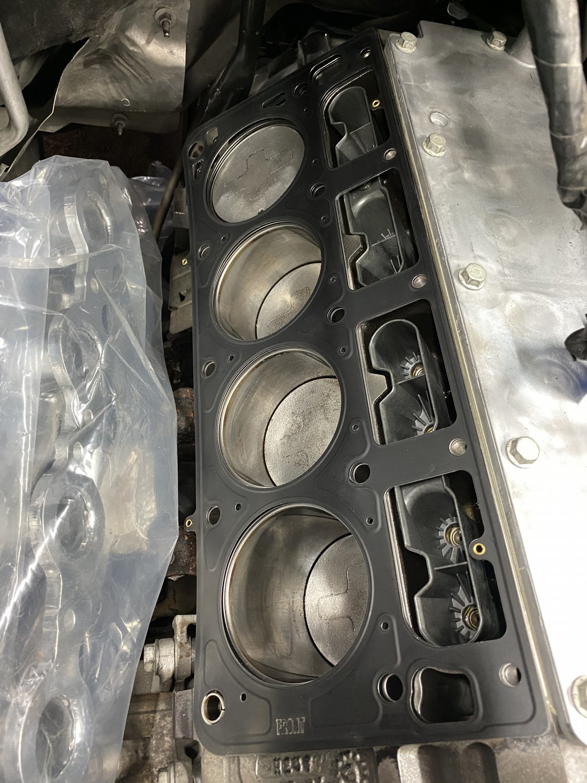

Wrapped the headers to protect them from scratches and slid them in to rest on the engine mounts while I continued on with the new OEM "LS7" lifters, new OEM lifter trays and Cometic .045" head gaskets:

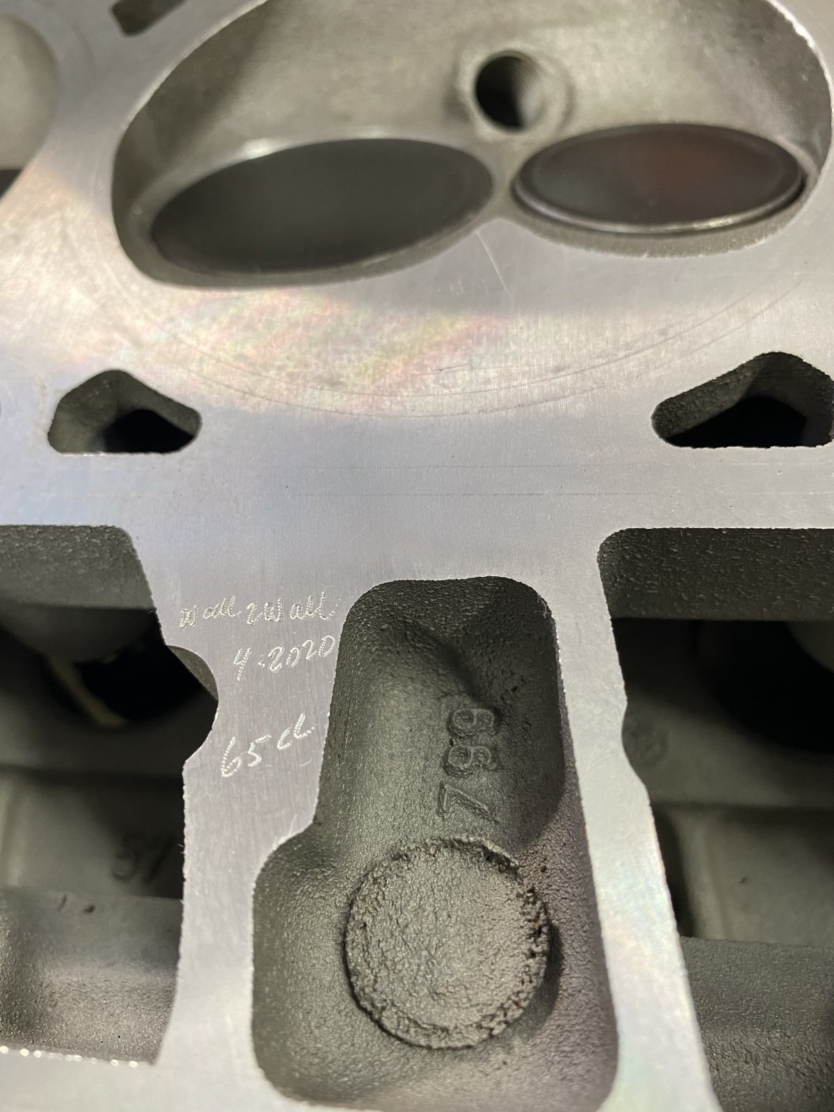

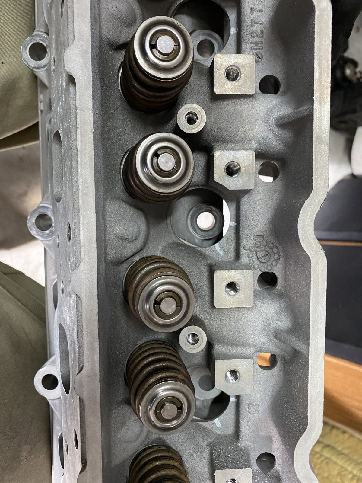

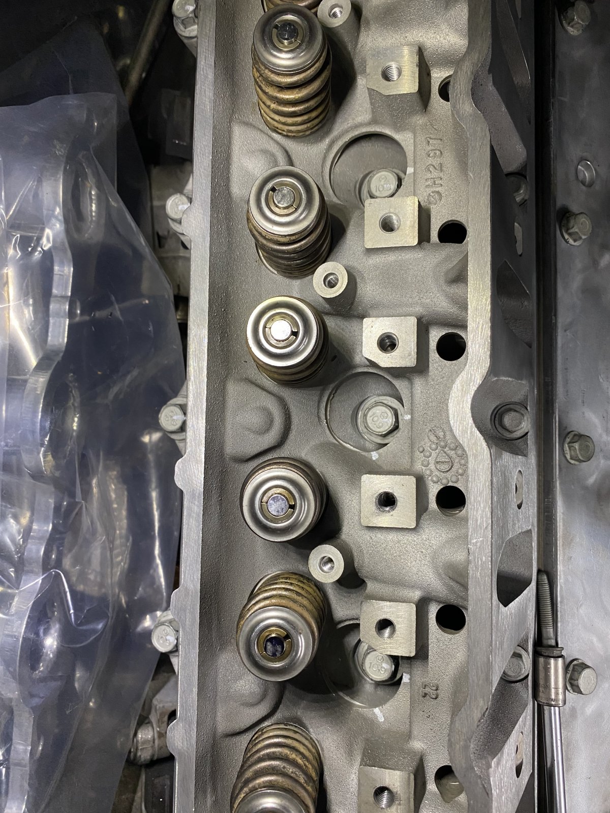

Head work performed by Wall2Wall:

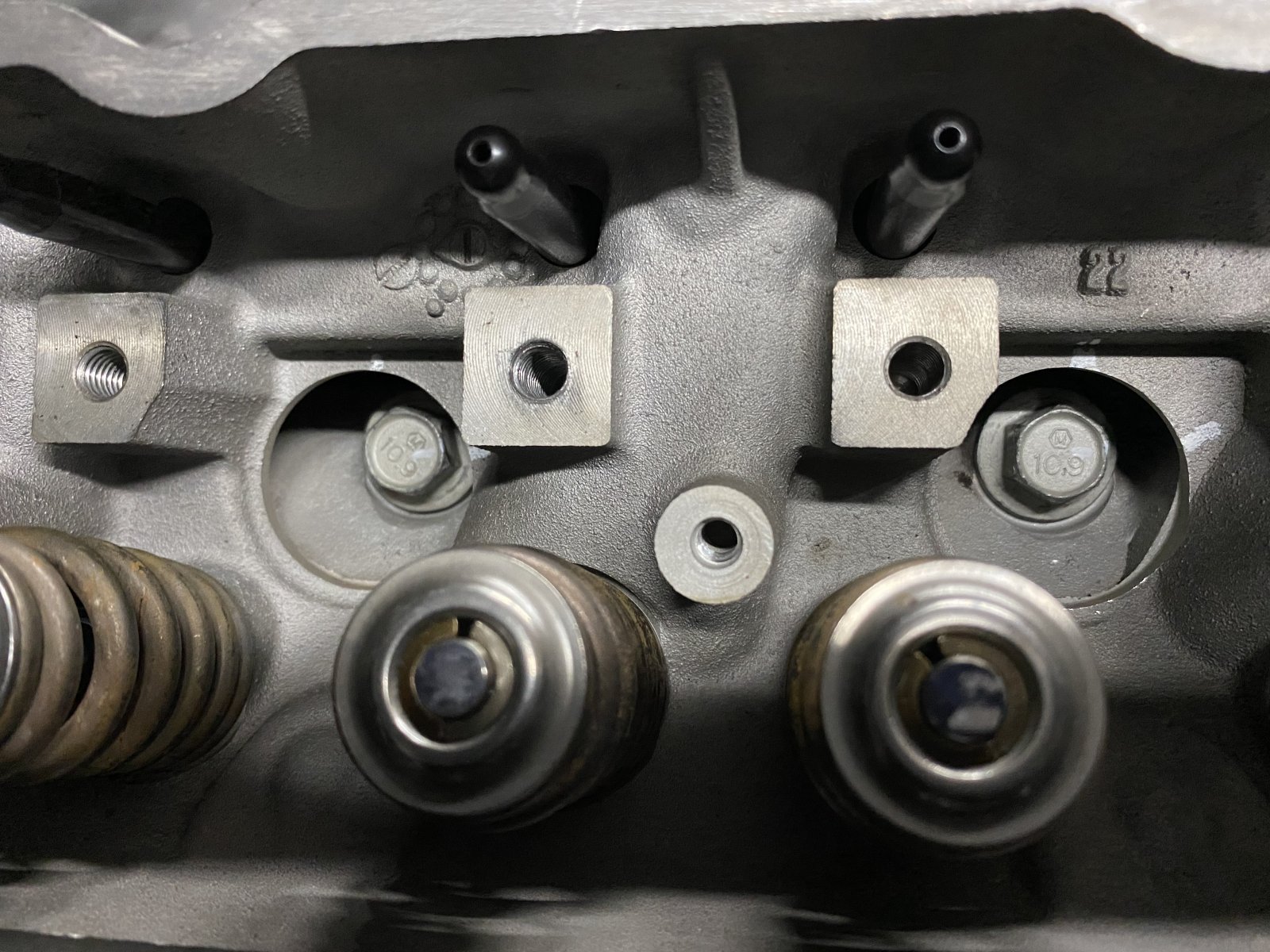

Marked each bolt hole with a "0" mark and 70° mark:
Then installed the heads, torquing the bolts to their initial value of 22 ft. lbs, following the specified sequence. I marked the bolt heads 90° counter clockwise from the "0" mark on the cylinder head, then tightened them all in proper sequence until those marks aligned, achieving the first torque-to-yield spec. The black on the valve stems is just ink from when I was checking the wipe pattern when measuring for pushrods:
Then turned them all, in sequence, 70° further to their final TTY spec then slid in those fat pushrods:

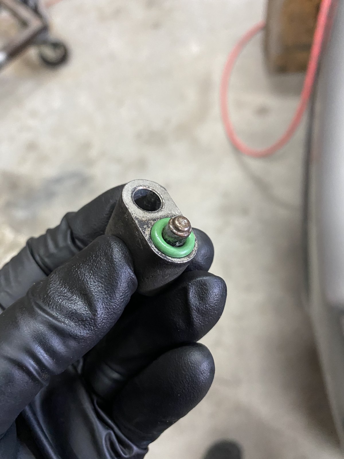

Old, crushed steam port gasket:
New gasket found at Napa. I grabbed eight of these in case I find a four-port steam tube one day:

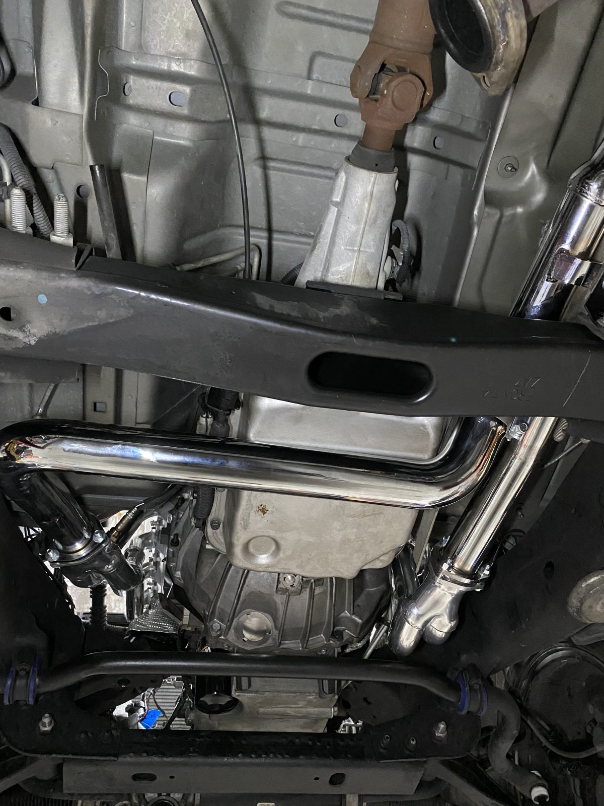

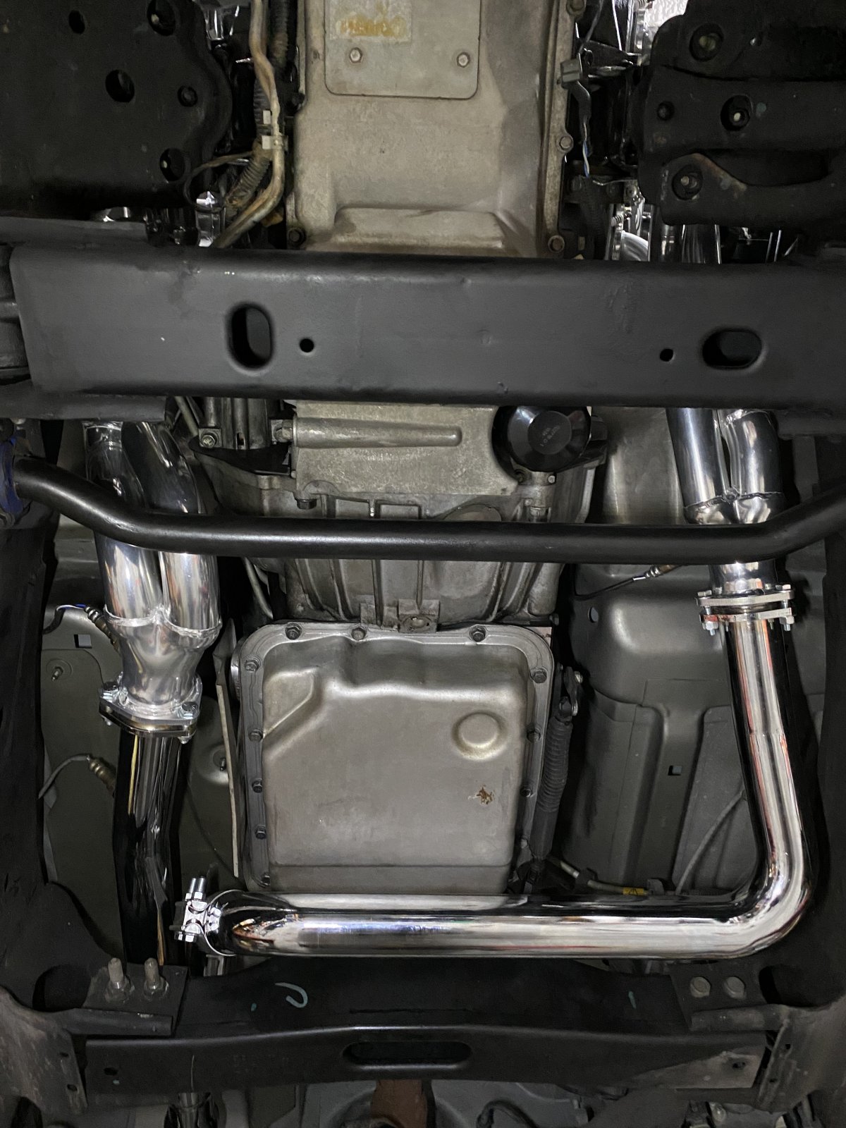

Heads on, steam port block-offs and tube installed, headers and front accessories installed:
Headers and Y-pipe underneath:
...And from the back:

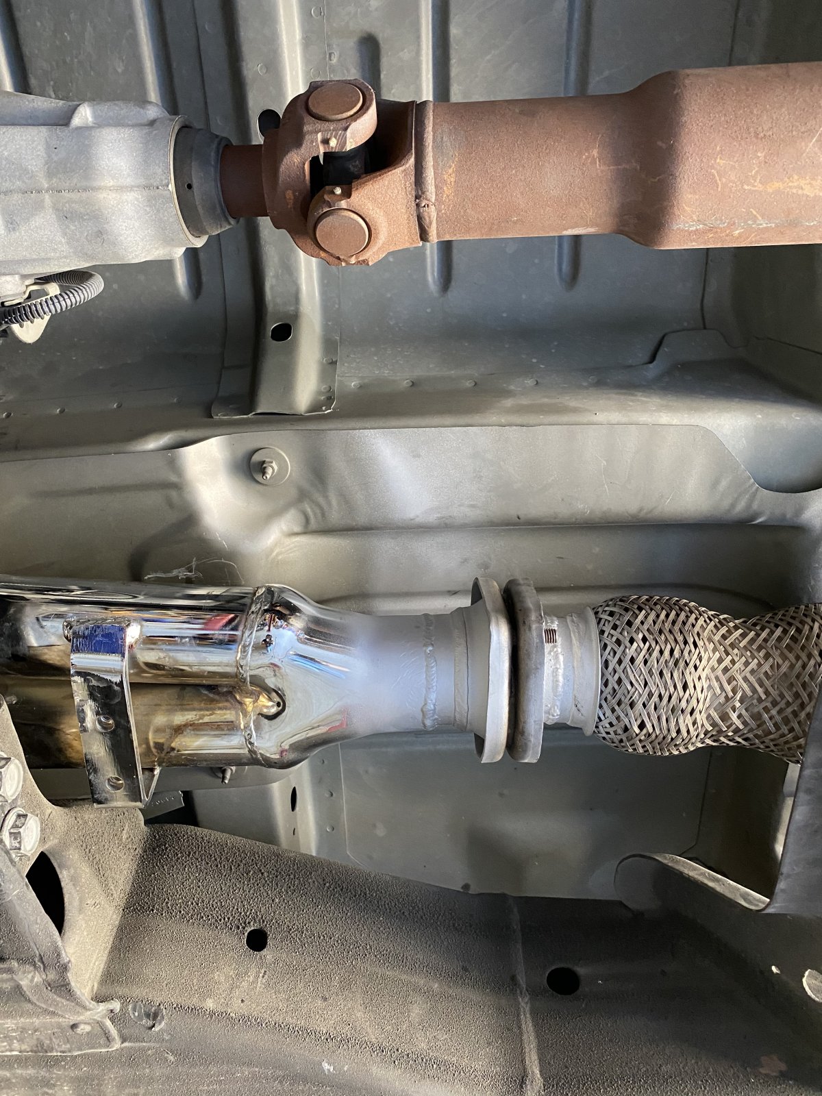

I had a tune scheduled for 1630. Tuner lives an hour away so I had to get that exhaust finished up cuz I'd have a headache driving it that far with the racket it makes.

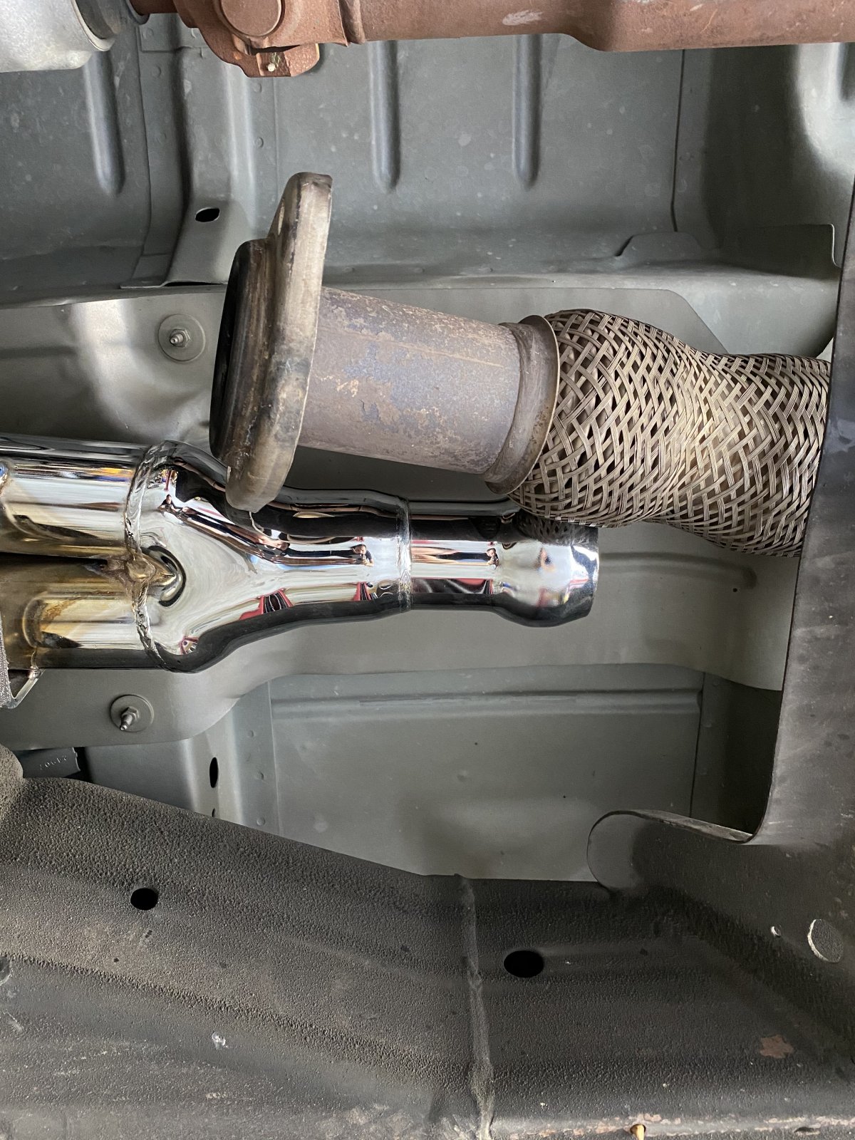

Doug Thorley Y-pipe has the ball-and-socket connection, my Tahoe has the flared flange:
Used a grease pencil to mark the collector where I wanted to cut it, before the tapered-down part:
img_2205-jpg.250009
Cut off the ball-and-socket from the collector and the flange from the factory Y-pipe and beveled the edges of each since it was a butt weld:
img_2206-jpg.250010

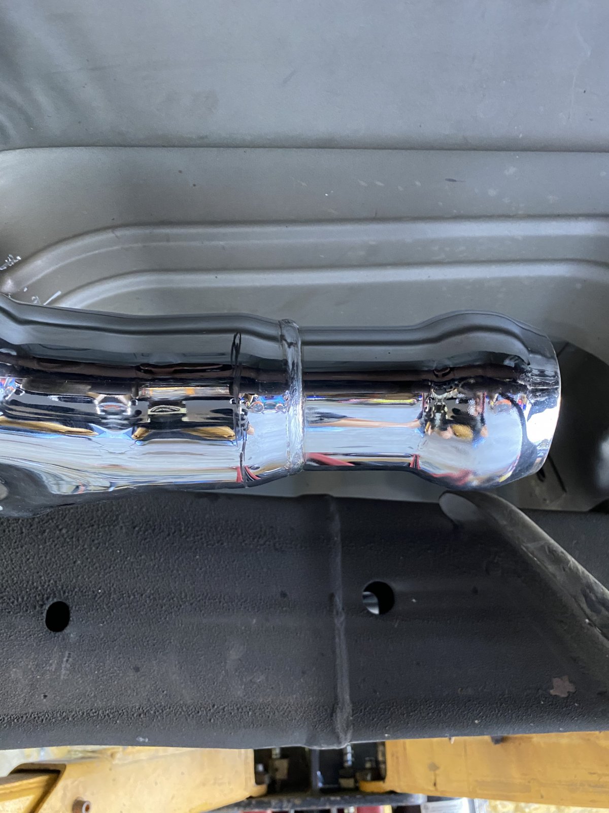

Finished. Cleaned the welds and sprayed with high-temp primer and paint. I also sectioned out a couple inches between the flange and flex joint:
img_2207-jpg.250011
It's still much too loud for my liking, but at least it's now coming out the tailpipe instead of under the floorboard. I have an electric cutout on the way so I'll be chopping up the exhaust again. I may install a second flow-through muffler in series with the current one to quiet it down or maybe reinstall a factory muffler. With no cats, I'm sure a stock muffler would still have a meatier sound to it.

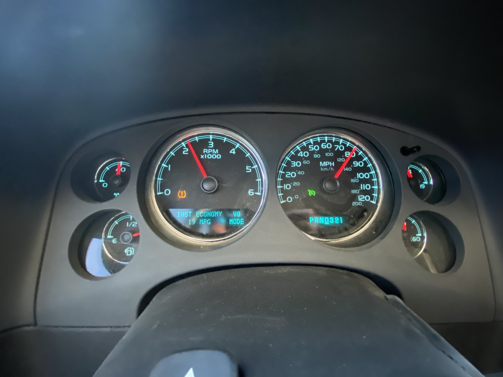

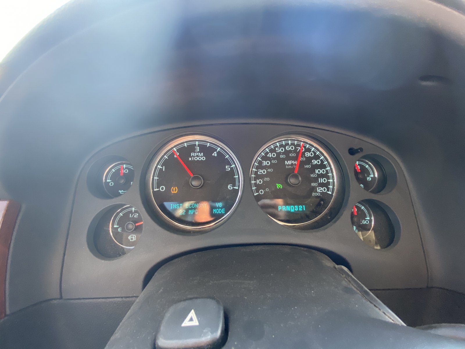

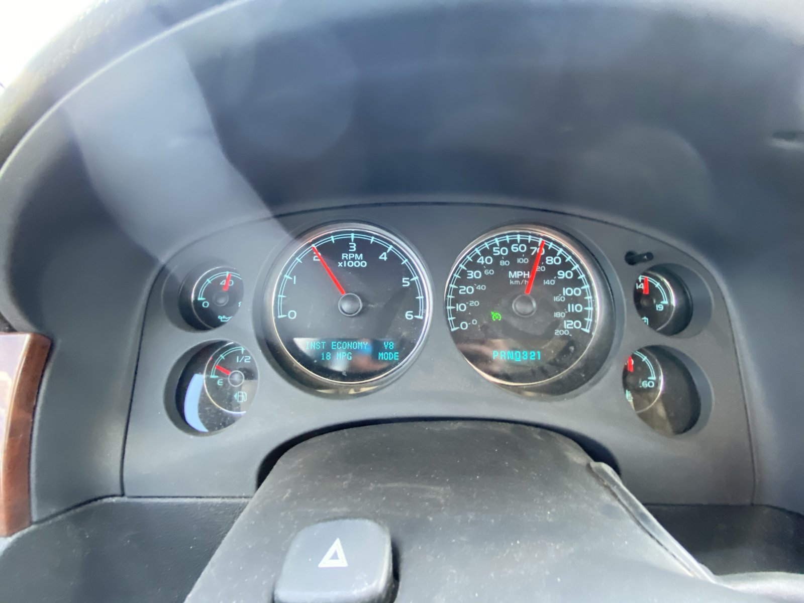

Took it on it's first actual drive an hour away to the tuner. Temp stayed at 210 and oil pressure did as expected. Even sat in traffic due to a disabled semi on the incline of the Mississippi River Bridge. I filled up with a fresh tank of Chevron 93 about 15 miles away from the tuner and checked the surge tank to see if it was still bubbling (still purging air, not leaking head gasket!).
On the long stretch of flat, straight highway near my house, I set the cruise at 70 and recorded my gauge readings, including the MPG:
img_2208-jpg.250012

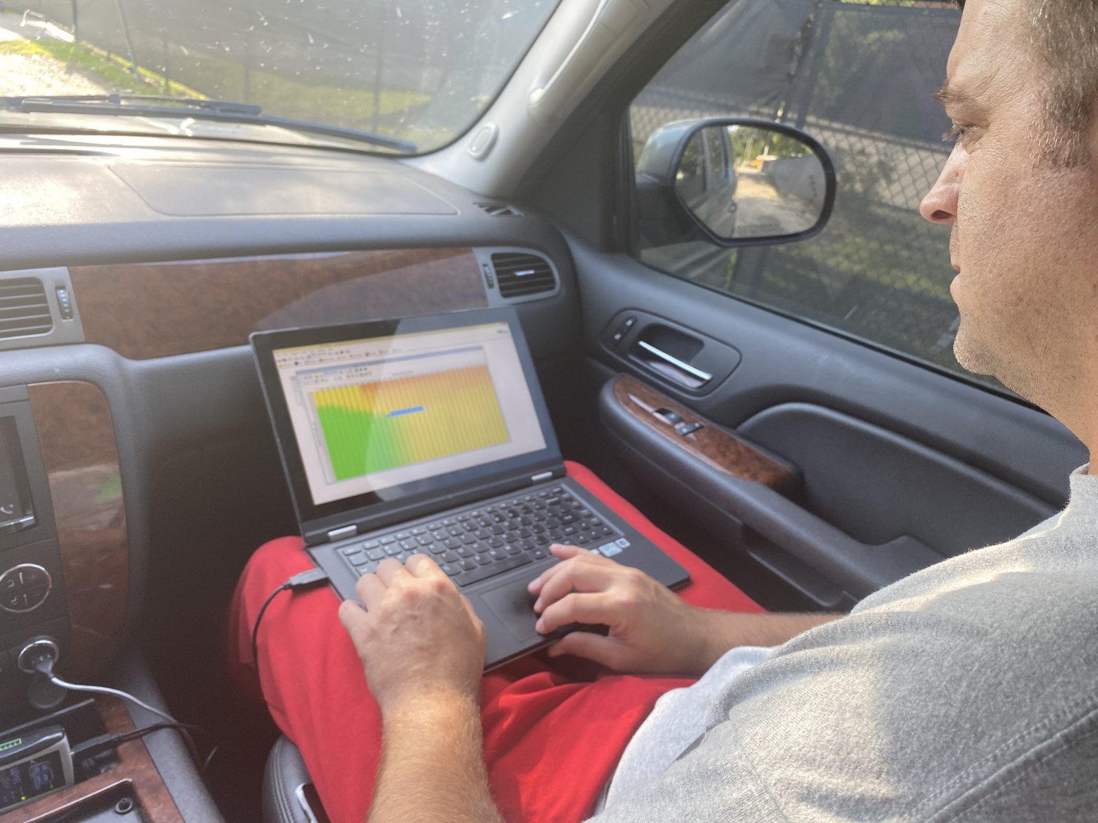

Tuner doin his thang:
img_2210-jpg.250013
On the way home, on that same stretch of highway at same cruising speed:
img_2211-jpg.250014
...And at 80:
img_2212-jpg.250015
It's not the fresher fuel since it's always gotten around 18 on that stretch (that's always been my test circuit for this). I shot a text to the tuner to ask if there's anything he did that would explain this (something intentional like lean cruise?) or if there's just that much more power/efficiency at that RPM with the mods. It's his day off so I don't expect to hear back for a while. Either way, good numbers :thumbsup:
