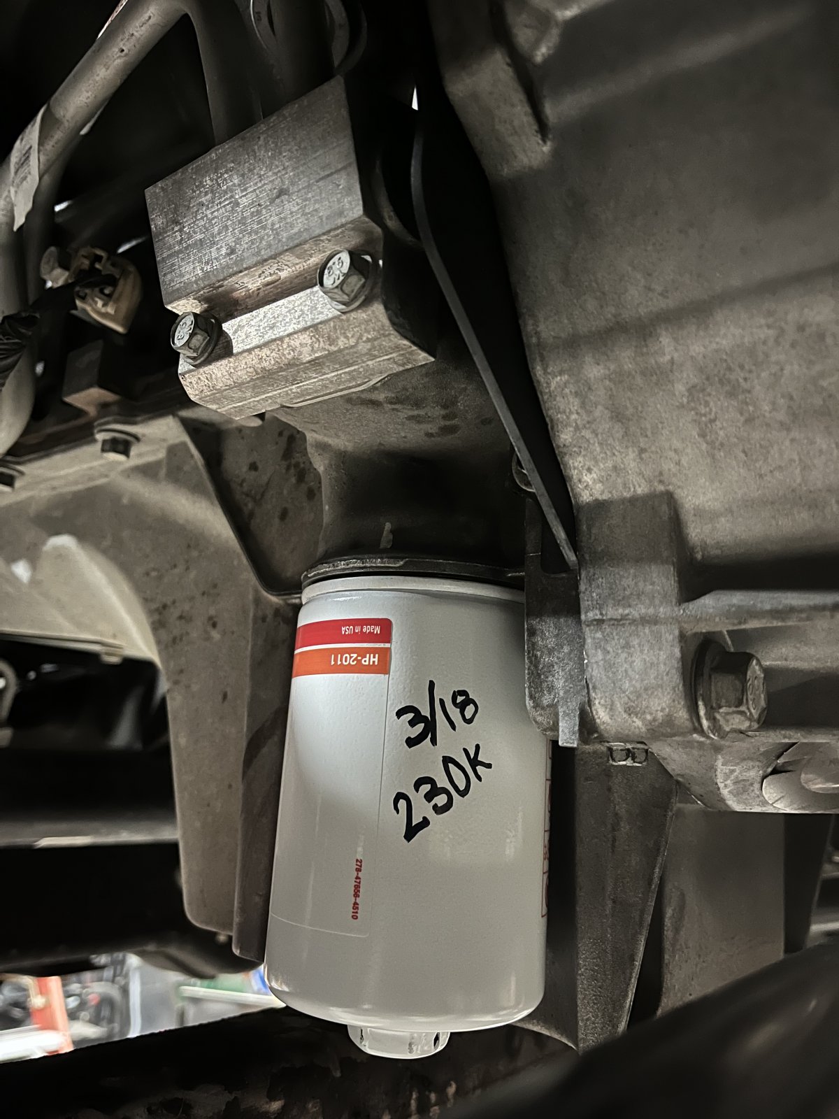

5K service (oil change and tire rotation) last night. Catch can had the expected 2 oz. Drain plug magnet had about the same iron on it as last time. Engine might be eating itself and the clock is ticking. It's been a hard 30K miles.
230K badge of honor:
