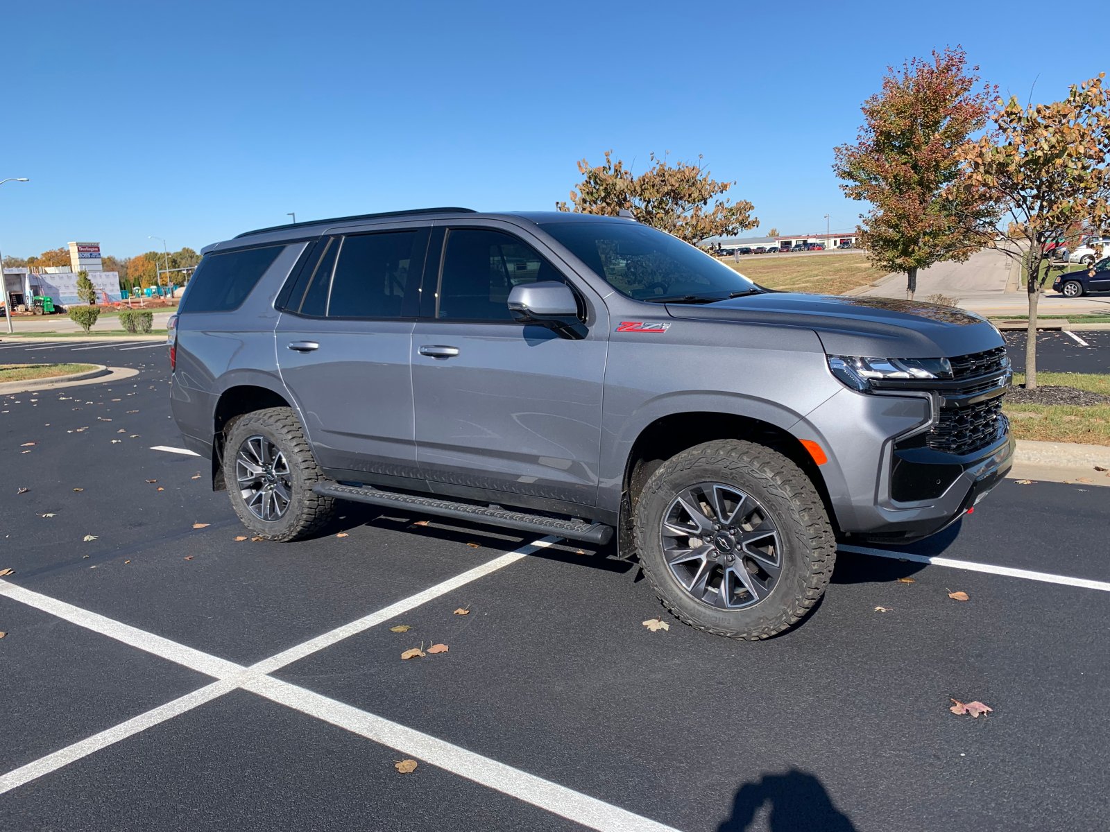

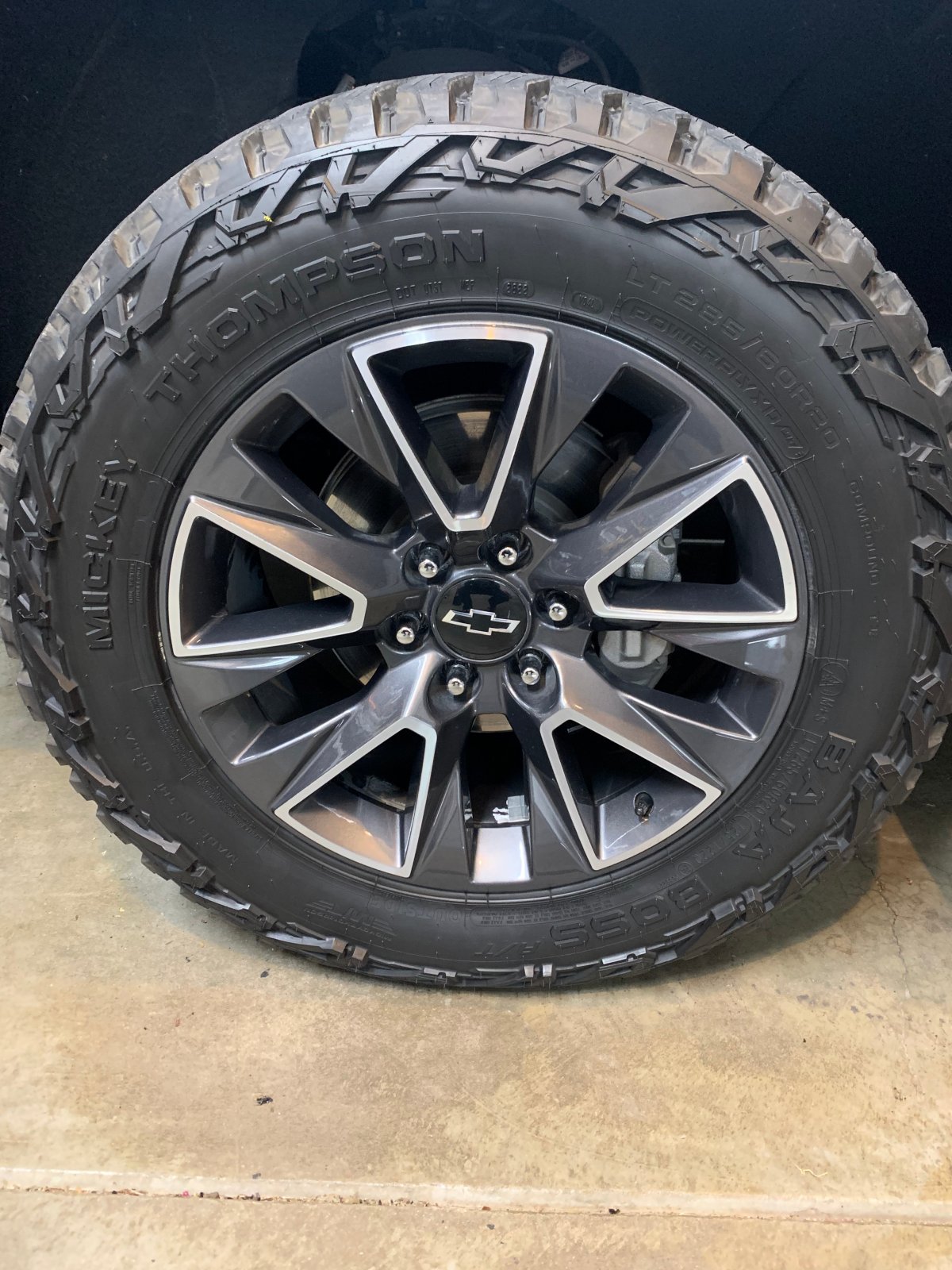

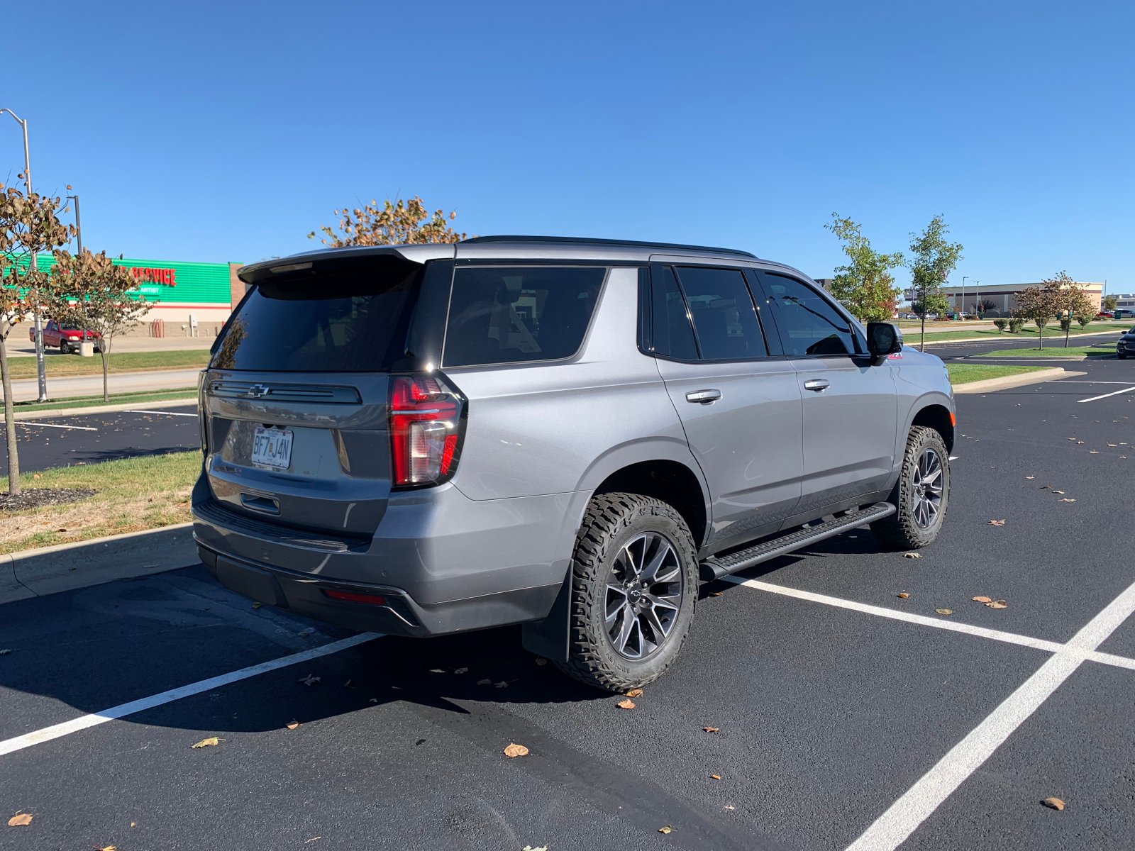

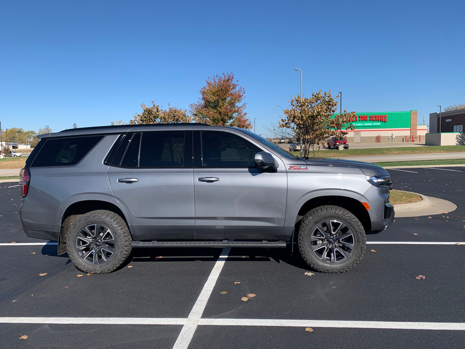

The stock Goodyears were past the point of no return and wore the outside edge, even after two alignments. With the onset of rain and snow season, decided to get new tires after 43k.
Went with Mickey Thompson Baja Boss A/T 285/60R20. They are three peak rated and look stunning. They also ride better than the stock Goodyears, both tires at 37psi. A slight hum at speed, but barely noticeable.

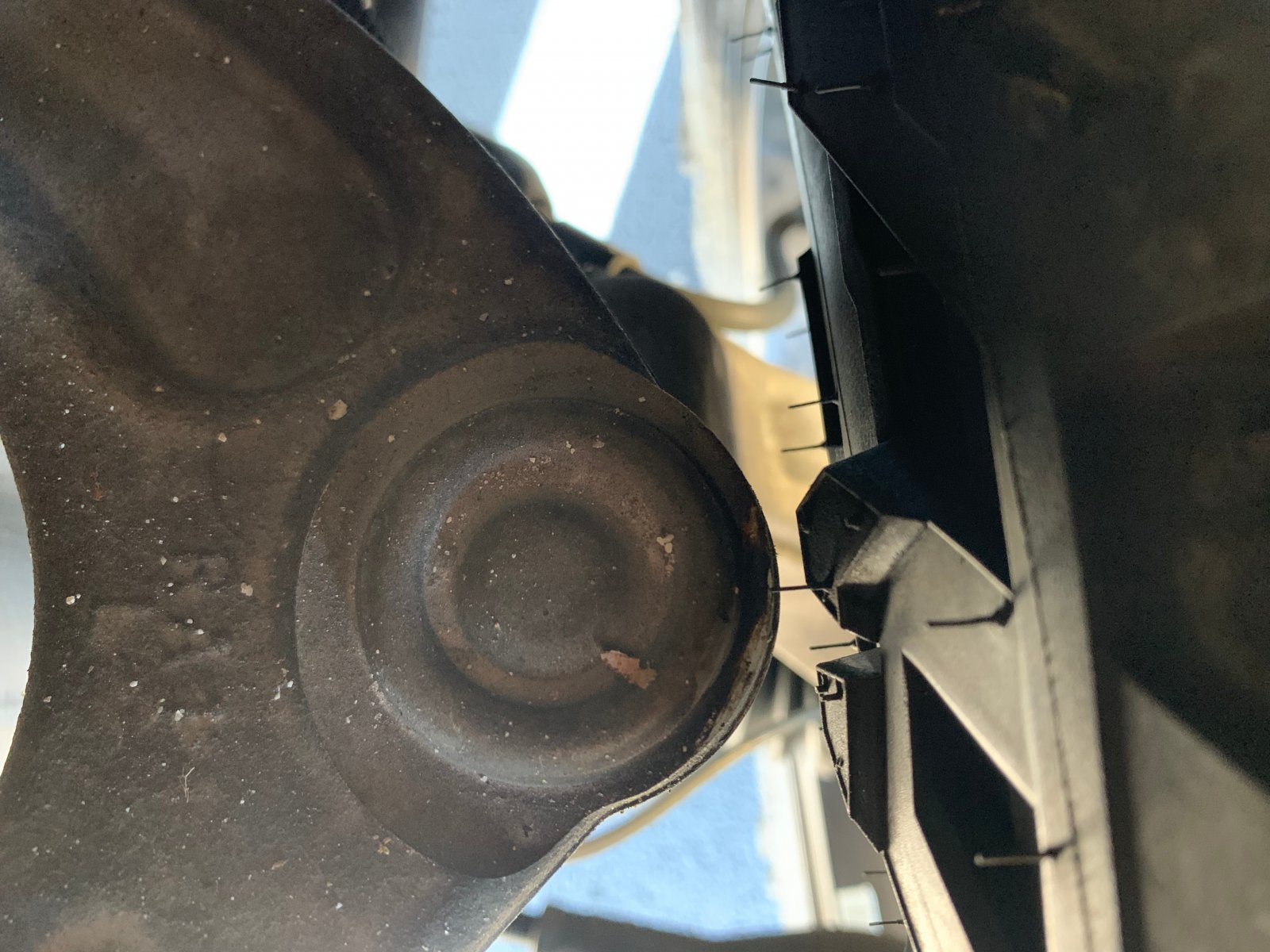

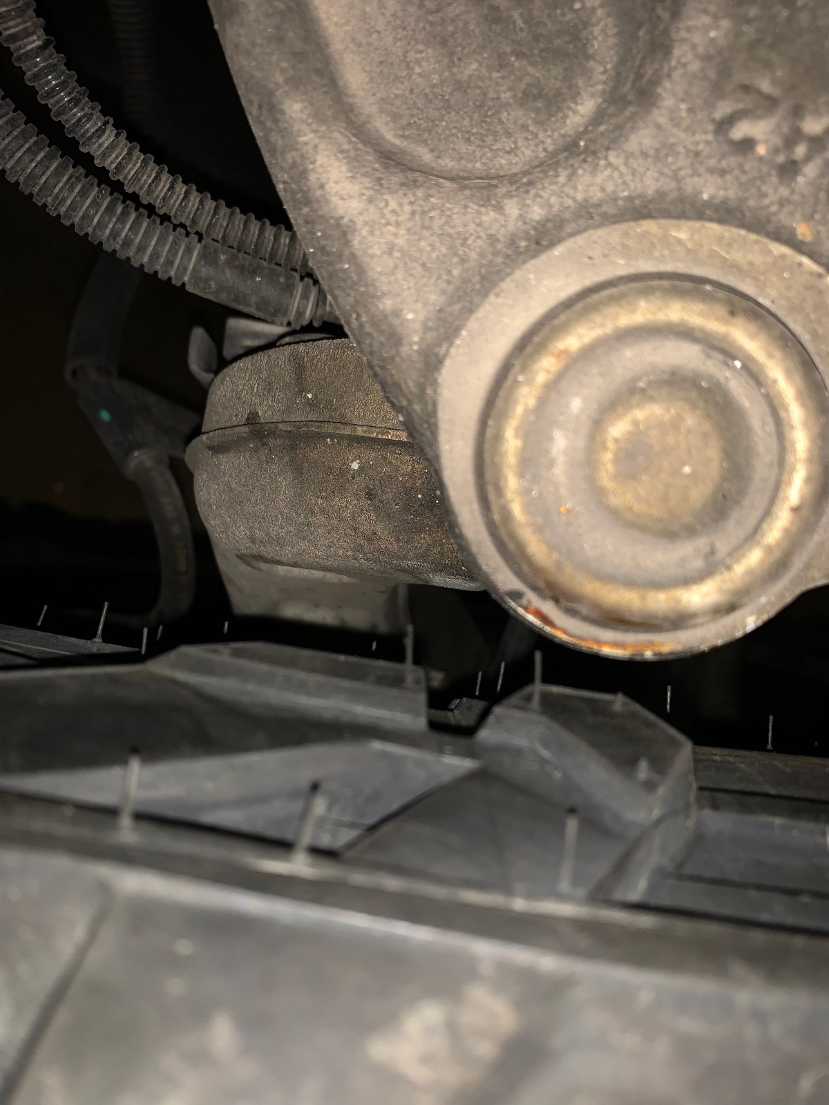

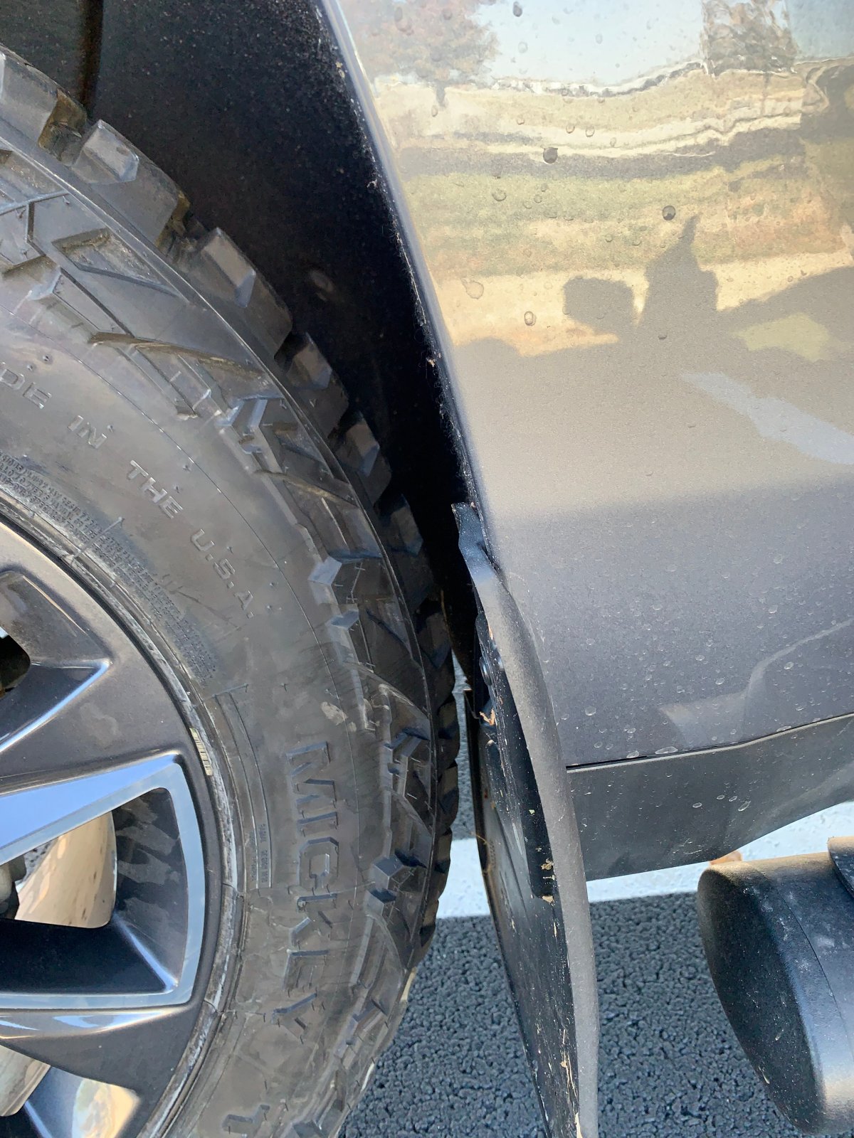

I will also say they BARELY FIT. No rubbing, even with bumps and driveway aprons in forward and reverse. Stock wheels with stock offset. I would like to install 1/4-3/8" spacers, but I'm afraid they would rub at that point. The Z71 Tahoe is lifted with EdgyMods links as it has air suspension, probably lifted less than an 1" F + R as much more than that and the ride started suffering greatly with the air bags under more pressure.
Measurements now from ground to fender lip:
38-7/8" to 39" F, 39-1/4" Rear
(got about 3/8" lift from the tires)

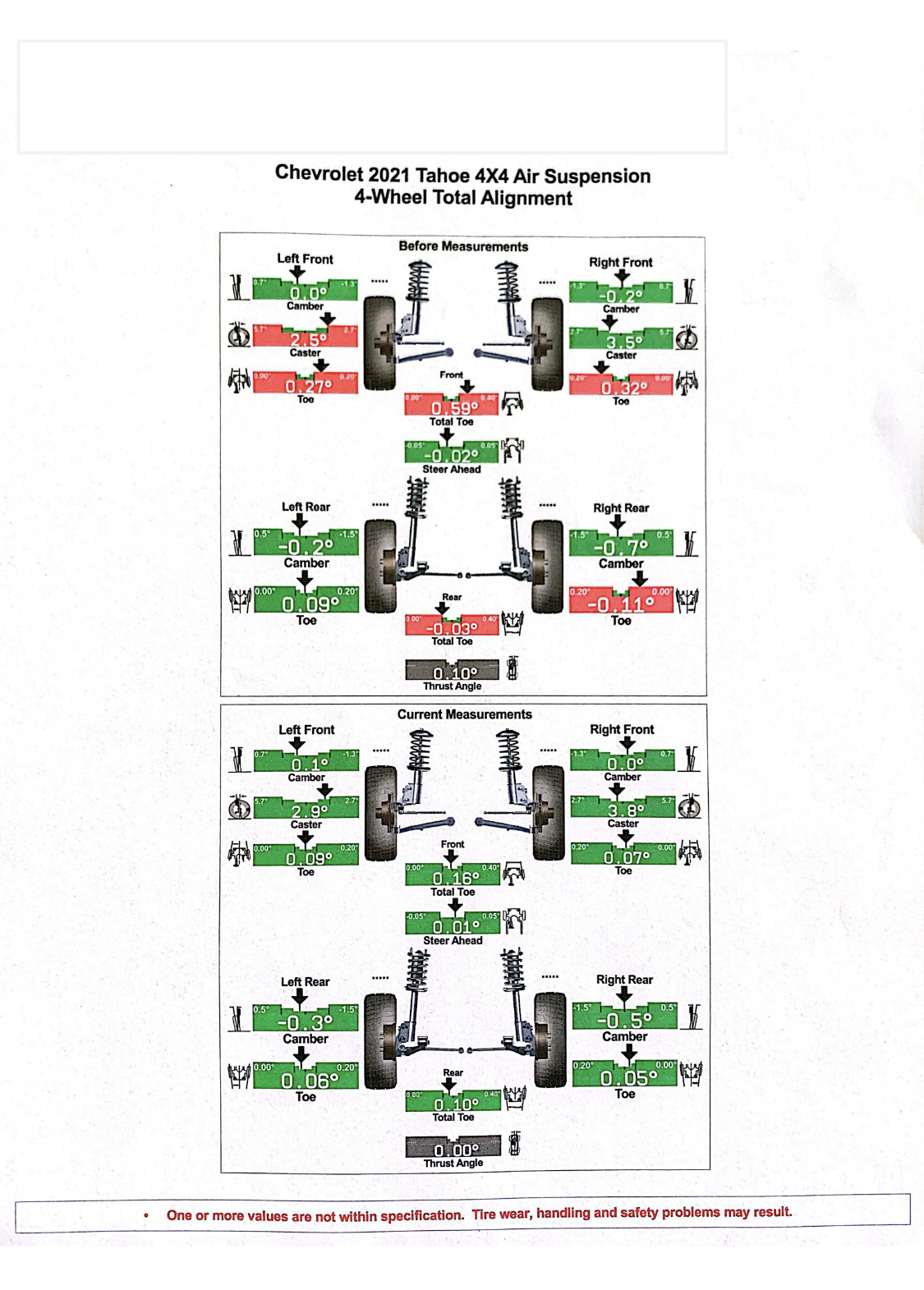

43k. Had it aligned twice. First time toe & caster off. Second time toe was off on front and right rear. I think the alignment machine at the first place was not quite right, so I used a different place the second time (ultimately the place I got the tires from).
Before the tires were installed, they checked using a drive-in alignment machine. Faster but not as precise as an alignment rack. It showed my alignment was spot on.
So I hope these tires will wear much better. Some tires, especially oem, just wear funny.
The only bothersome thing was we could never get the tahoe in “Alignment Mode” no matter what we did, even following the manual. We just let it settle in to normal ride height and aligned it there.
I also have a “lifetime alignment” agreement if needed for two free alignments a year.

That's quite a spread from left to right on the caster. On previous generation, that much would be out of spec. It would certainly make the ride and driving feel off. Next time around or if you have concerns, let the dealer do it. They're not anymore expensive.
