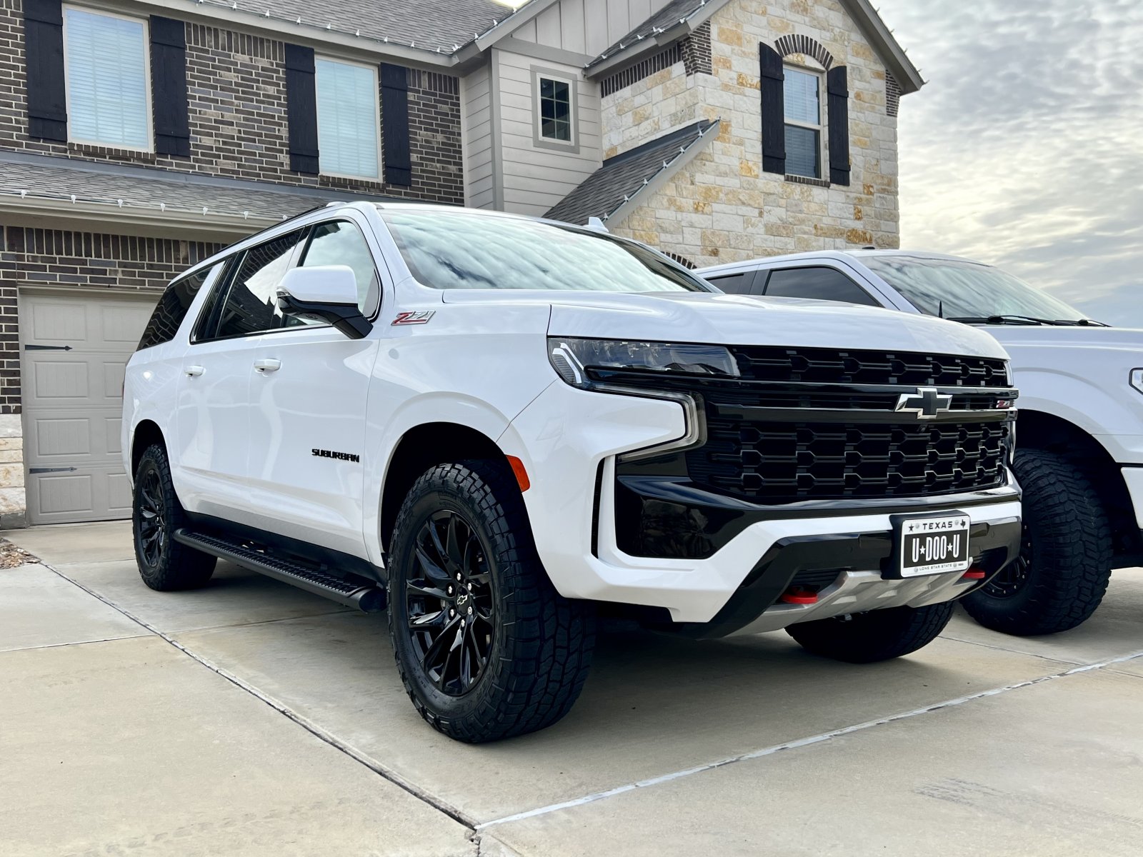

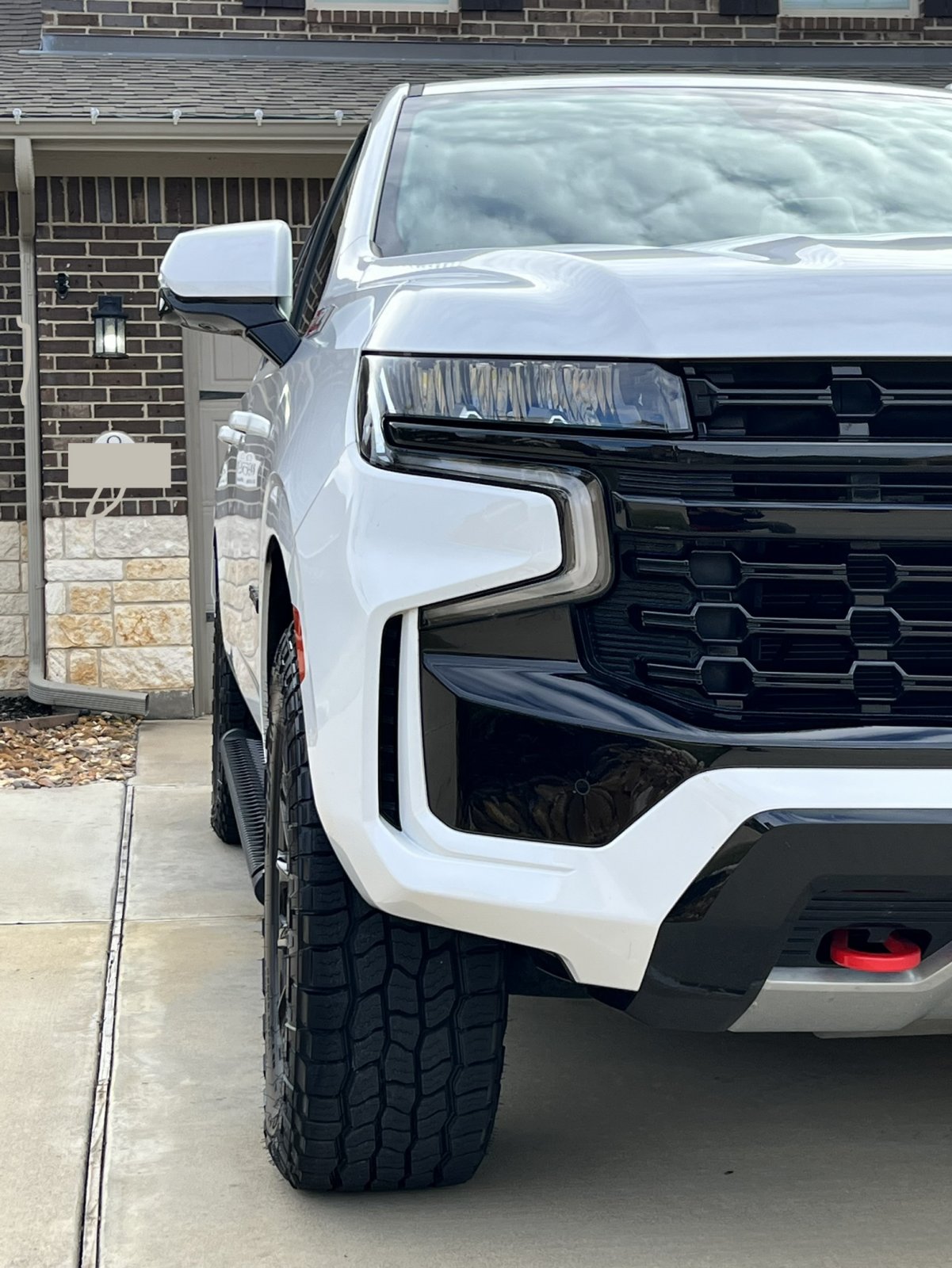

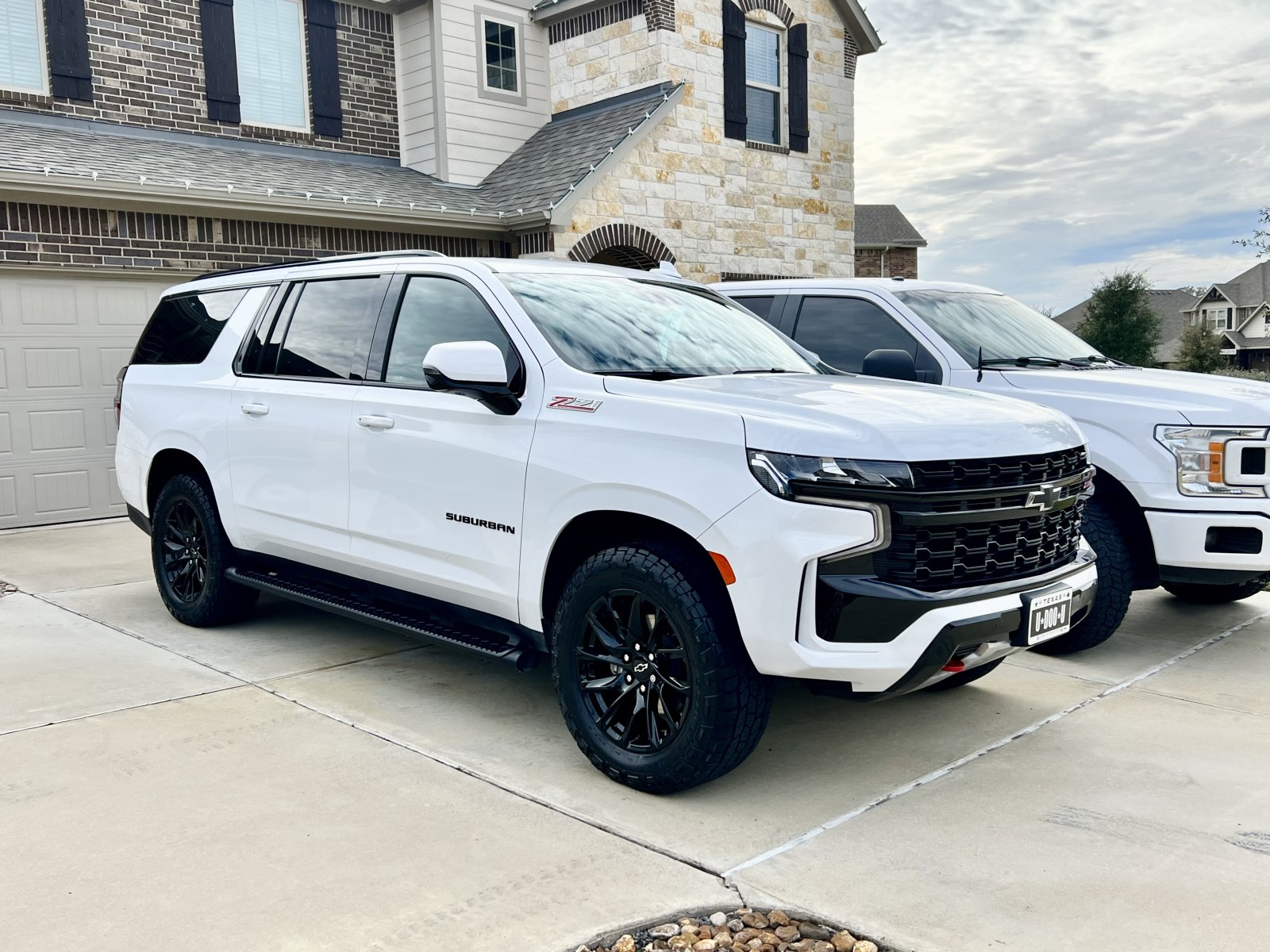

Stock suspension Z71 Suburban with 285/60R20 Cooper Discoverer AT3 XLT.
These are one size wider than the stock tires.
I couldn’t find any information if they would fit without rubbing. I’m here to say they fit great - no rubbing anywhere.
(I also have the 4 take off tires & wheels in the back of this photo - weighing down the rear a little)

60 sidewall being a ratio of the tread width means you've got a taller sidewall/tire overall as well, roughly 0.5" taller. I've been eyeballing some 34s so this is encouraging. Just a sneeze away from a 35 but it's close enough.

D-mn that looks good. I am going with these same tires when the stockers are done. Although I am looking at 305/55R20, a little taller but still a 33". There is a thread with a Satin Steel AT4 with 33/12.5R20 Nittos with no rubbing.

Actually, the 285/60/20 is taller than the 305/55/20. The 305 is a smidge wider though.
