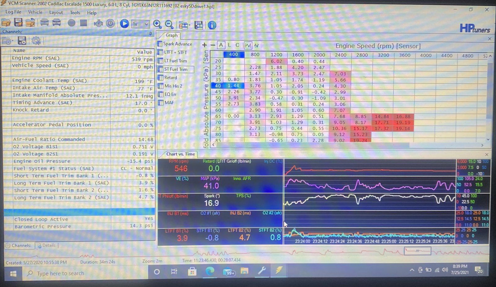

I guess I was having a brain fart because seeing the timing advance on decel is normal. It’s been a while since I’ve been playing with my software but I was seeing the same as you. Sometimes hitting 32° on decel without DFCO playing a factor. I should do another log and add DFCO to the list of things to monitor. I usually only pull up the tables on just the stuff that is important for the thing I’m tuning for. It can get busy with a bunch of info you don’t need.
On my Esky the DFCO minimum injector pulse width is 0.760ms. So yeah, maybe yours is that 1.2ms that we saw.
From my data log here you can see the timing almost having an equal and opposite reaction as MAP.
I’d still like to target DFCO and watch exactly what it does and how it effects things.

In number 37 above, that clip has DFCO status and a sequence of pretty close to WOT and the off the gas. DFCO cuts in, strangely a full thousand RPM after I cut the throttle. The shortest injector pulse width I see on the Tech 2 is like 1.2 and it get back to idle widths pretty quickly.
The one thing that seems like it might could throw my observations off gets back to that Tech 2 sample rate. It could be that the injector pulse width get down sub millisecond and I might never see it on the Tech 2 display, as those periods may have been skipped in the sample rate obfuscation. With new equipment monitoring the tune, it might be very apparent that they actually are getting down where you thought they should,
Looking at that segment of that clip, like starting 5:40 in, the advance drops to low single digits during the DFCO enabled period, we just might not be seeing the injector fuel cut.
