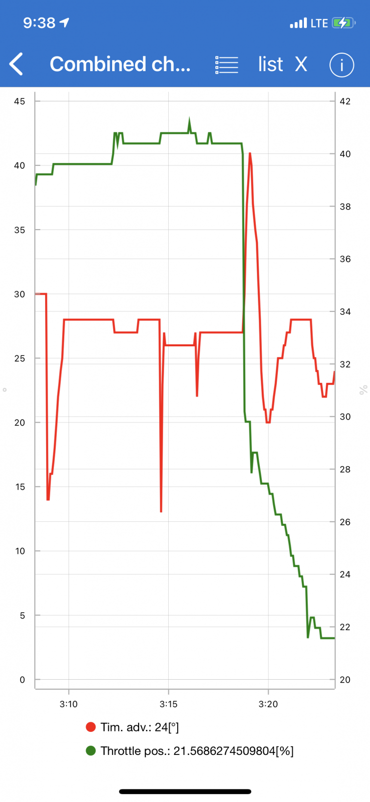

This sounds totally wrong. When getting off the throttle your injector pulse width should drop to .5 milliseconds and timing should drop to - advance. This is called DFCO (deceleration fuel cut off) and I can’t see why you would be seeing high advancements on decel. I wonder is someone got in there and played with the tune and didn’t know what they were doing with DFCO.
No, stock tune. DFCO is not on (according to my Tech 2). I assumed it was just the anti unburned fuel committee at work, but that is how it is working. Maybe I can figure a way to record the advance reaction on my cheapo ODB scanner and post it.
All I could figure out how to do with my cheapo ODB app on my phone was do a screen capture of the traces. The TPS trace is green and the advance red. When I pull off the throttle, the advance jumps before settling back down. I have no idea why. I will try and get this stuff on the Tech 2 where I can capture DFCO status, etc. But driving and recording the Tech 2 screen gets kind of busy. :)

Wow, that really has me scratching my head as to why timing would jump advance to 40° during decel. I can see why you’d be having KR on 87 octane though. Thanks for sharing, I’m gonna dig into a couple tunes tonight at work to see if mine does that too. Only thing that makes sense is you would increase timing to eliminate decel popping.
I am going to hopefully have enough time tomorrow on some more open and less dense roads to see if I can get the DFCO function to kick in. I suspect I am just not getting high enough in the rpm band before let off to get it to enable. If I can get it to work, I will see if I can capture the difference on the scanner app.
