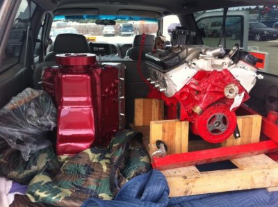

You'll need to do some work on those Vortecs to use that cam ... will be a good overall engine once tuned properly. :D

Retorq, I was thinking some port-polish on the heads and some new springs. Do you have anything else in mind. My main concern is getting it to pass smog. Any other California guys running a big cam and getting it to pass? If so, how big is it?

Well I'm kinda stuck here in California. Believe it or not, there are several counties in California that don't require smog inspection. Mine is not one of them. My trans is currently built fairly stout however I'm thinking that it wont last too long with the new power and all the towing I do. As soon as a NV4500 finds its way into my shop,the swap will begin. Here is a shot of the TWO ZZ4's and a pic of the Tahoe from an outing this weekend.
