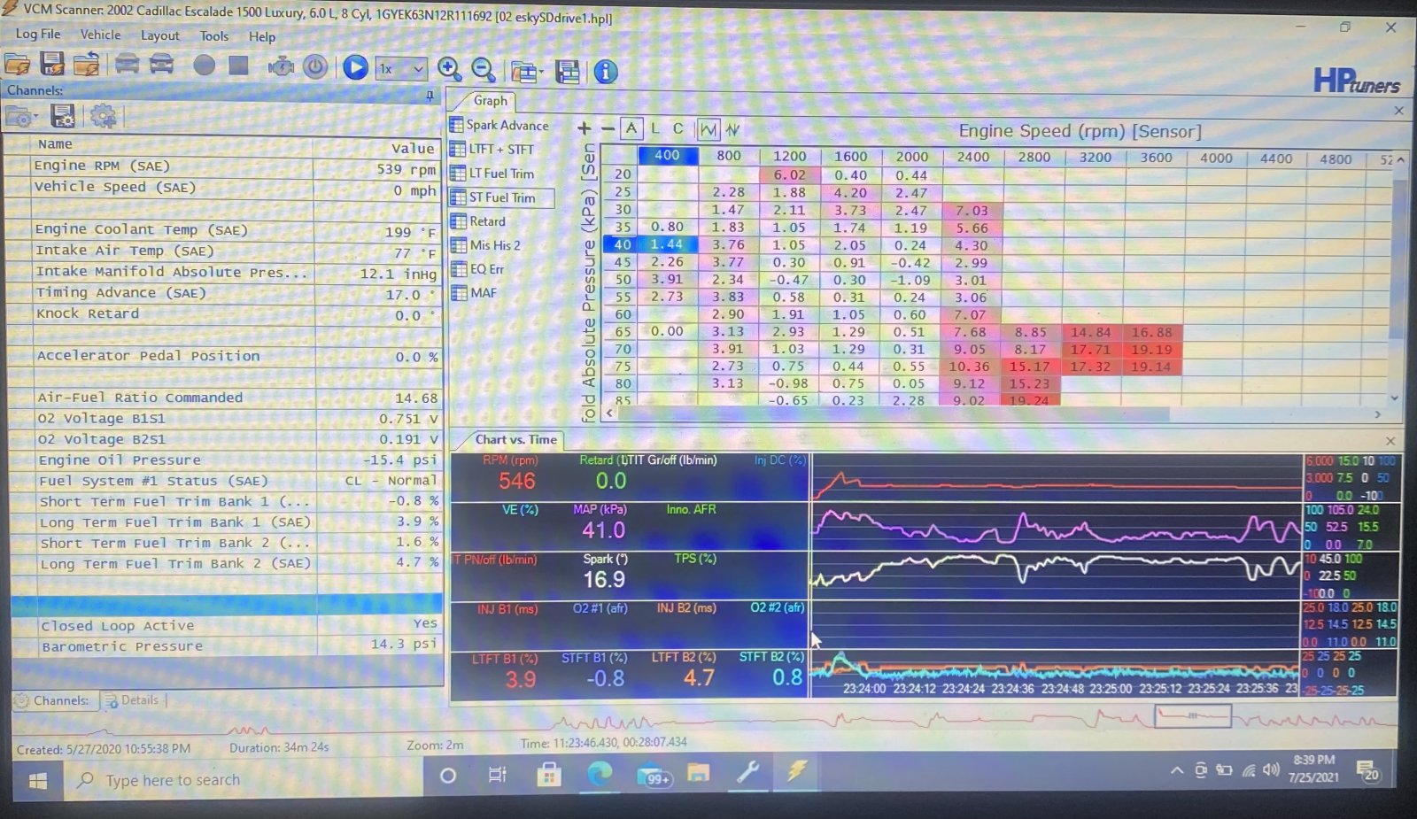

I’ve found the tech2 to be a little laggy myself. But it still shows good info especially during playback. Maybe the 1.2ms is as low as that will go in that programming during DFCO. I remember seeing .5ms on another vehicle that was where I pulled that number from.
seeing the timing drop to single and even negative numbers seems to be more during shifts which is all in the torque management. Some good info there. I didn’t get a chance to review my data logs on HPTuners because I’ve been driving the scoot the past couple days. I’ll try to get that up here to see how that compares to what you have going on.

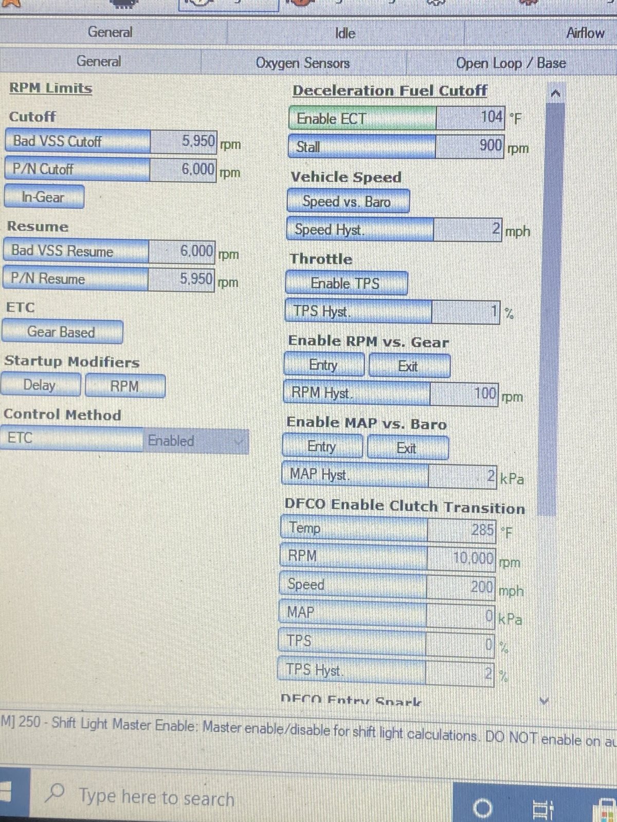

I guess I was having a brain fart because seeing the timing advance on decel is normal. It’s been a while since I’ve been playing with my software but I was seeing the same as you. Sometimes hitting 32° on decel without DFCO playing a factor. I should do another log and add DFCO to the list of things to monitor. I usually only pull up the tables on just the stuff that is important for the thing I’m tuning for. It can get busy with a bunch of info you don’t need.

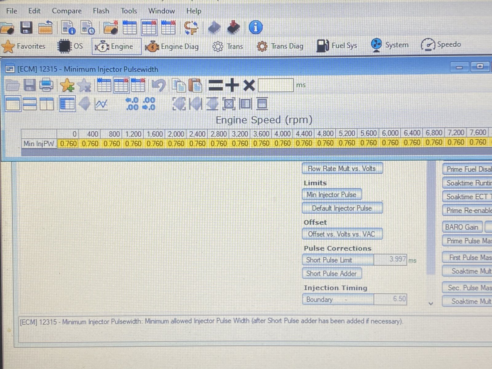

On my Esky the DFCO minimum injector pulse width is 0.760ms. So yeah, maybe yours is that 1.2ms that we saw.
From my data log here you can see the timing almost having an equal and opposite reaction as MAP.
I’d still like to target DFCO and watch exactly what it does and how it effects things.

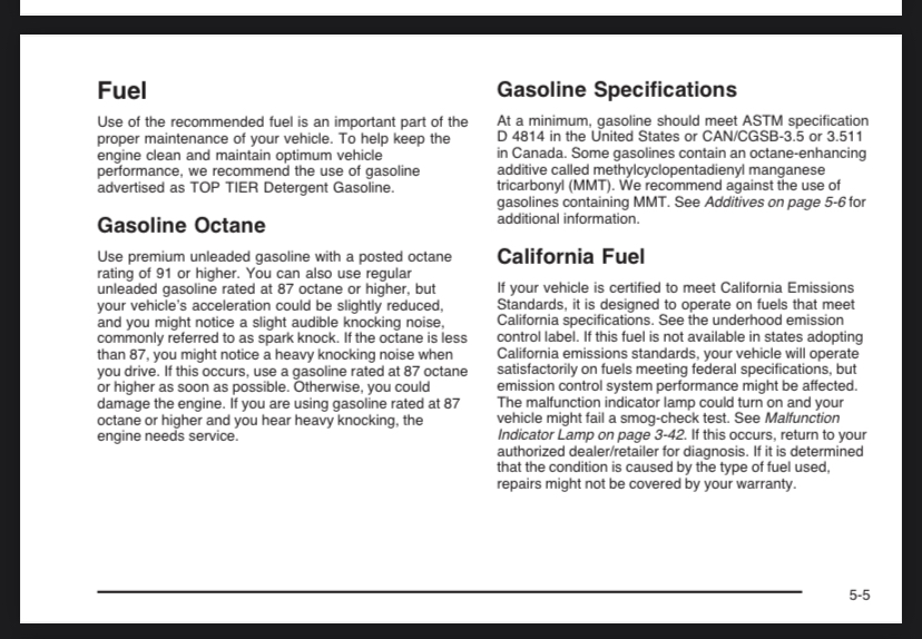

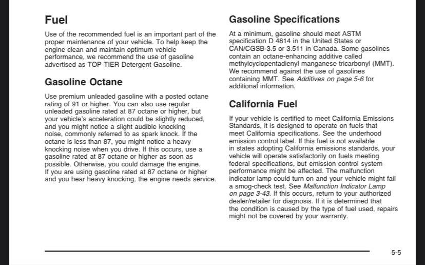

So will it run on 87, sure. So will my chainsaw but not very long. The Cadillac has a better tune which gives it a higher horsepower rating but the Escalade, Yukon Denali and LTZ Tahoe all have a fuel recommendation of 91+.
