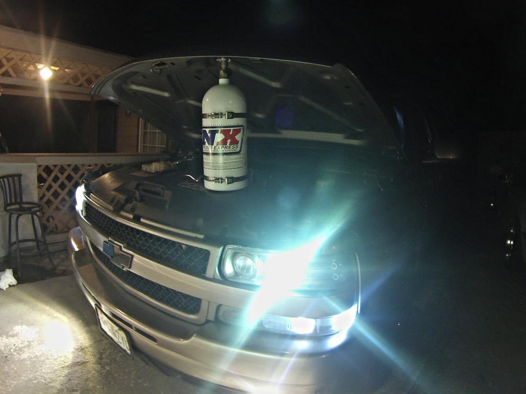

bought this nitrous express kit for my tahoe...going to be doing a 75 shot at a truck event at the local track next week...after the event i will get my retune done and increase the nitrous to a 100 then a 150 shot..this kit is very high quality soo looking forward to some real fun times with it and some good results at the track
dnt mind the light glare jaja i was working on my lights

Interested to see how it helps you. Also the placement of the bottle inside.

well my friends tahoe with a trailblazer stall and intake manifold with tune and a 150 shot ran a 15.4 at 5800ft elevation a stock tahoe over here runs mid 19s

trans has a vette servo, 3200 stall and a 40k tru cool transmission cooler soo it should hold up a bit..plus i will be getting a window switch so i wont be spraying during shifts or anytime under 3000 rpm and will be triggered with a WOT switch...will do all the precautions to keep it running safe lol

Pics of mount location? How'd you do?
will get some pics for you tomarrow! my best pass without nitrous was a 16.8
installed colder plugs and did only a 75 and my best run was a 15.3 @ 92 and this is in 5800 ft elevation...broke 1.5 seconds with a 75 shot...can honestly say i am very impressed
