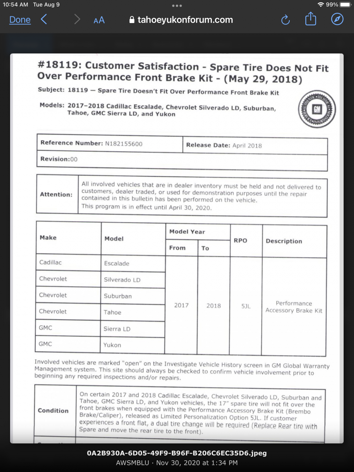

I have the Big Brake package on my 2015 Denali. Word of warning. No one told me this when I ordered them or after having them installed. Your spare tire will not fit Over the Brembos . GM answer, (I found out the hard way! ) is to do a 2 tire change if the flat is in the front. So they even put out a service notice. Swap out the rear tire 1st with spare and take back tire to replace the front flat. I tried putting a 20in spare underneath but won’t fit as it’s molded for an 18. 20in is the smallest rim to fit over them. If I had known this not sure if I would have gotten them. Just a word of warning!
Same with the Jeep GC SRT. I never had a flat on mine but if I had one on the front I would have had to do the same thing.

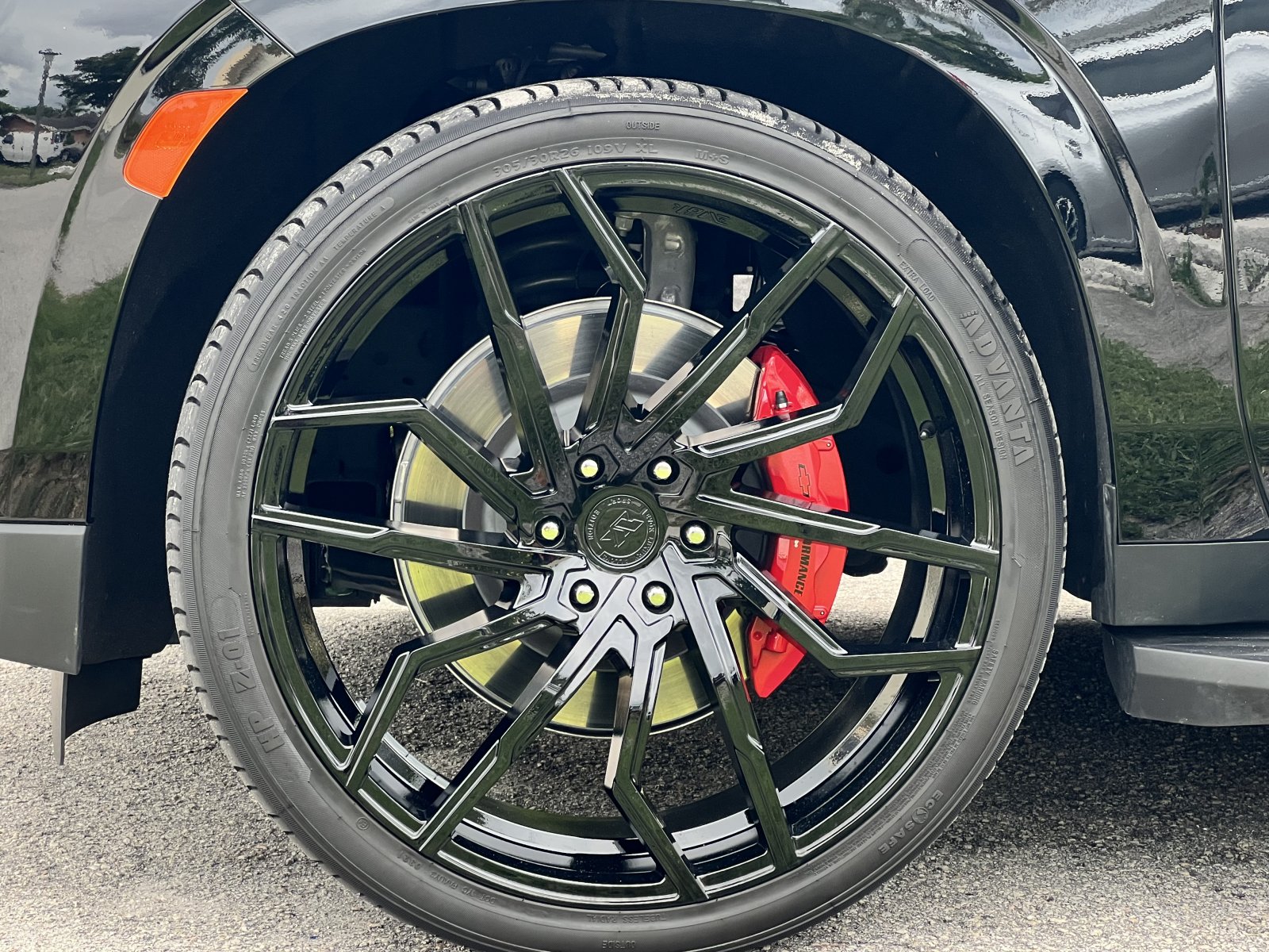

I definitely recommend the Brembo upgrade. Much smoother and doesn't feel like its struggling to stop the vehicle in any means. They look great and gives the vehicle a whole new look. There is a tad bit more brake dust but nothing to complain about. Worth every penny!

Please be aware that your spare tire won't fit over the brembos I found out the hard way. GM even has a service bulletin it read as to do a 2 tire change if the front tire gets flat . Do the rear 1st take the rear tire and change the front . You have been warned

I definitely recommend the Brembo upgrade. Much smoother and doesn't feel like its struggling to stop the vehicle in any means. They look great and gives the vehicle a whole new look. There is a tad bit more brake dust but nothing to complain about. Worth every penny!View attachment 375991
