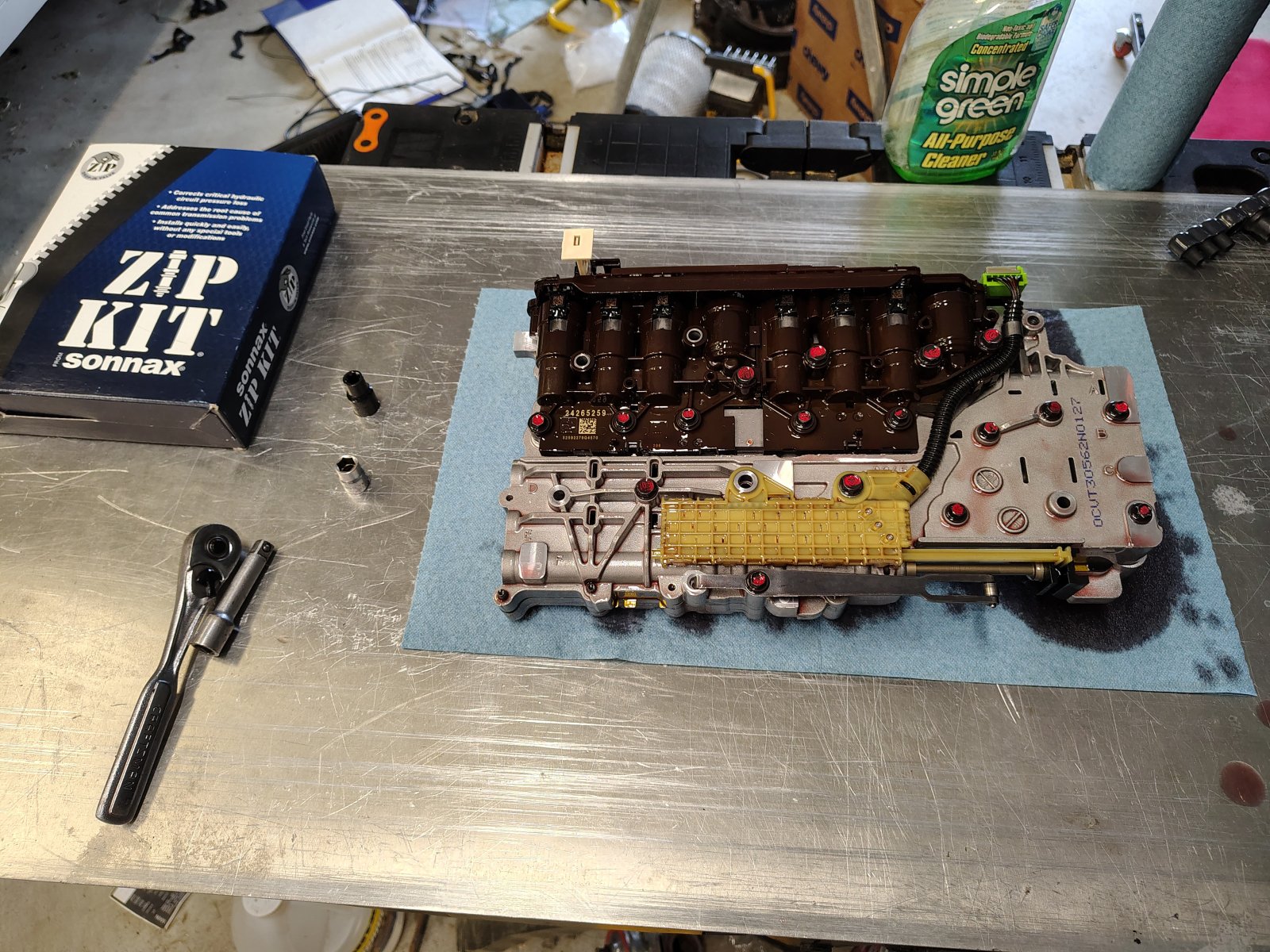

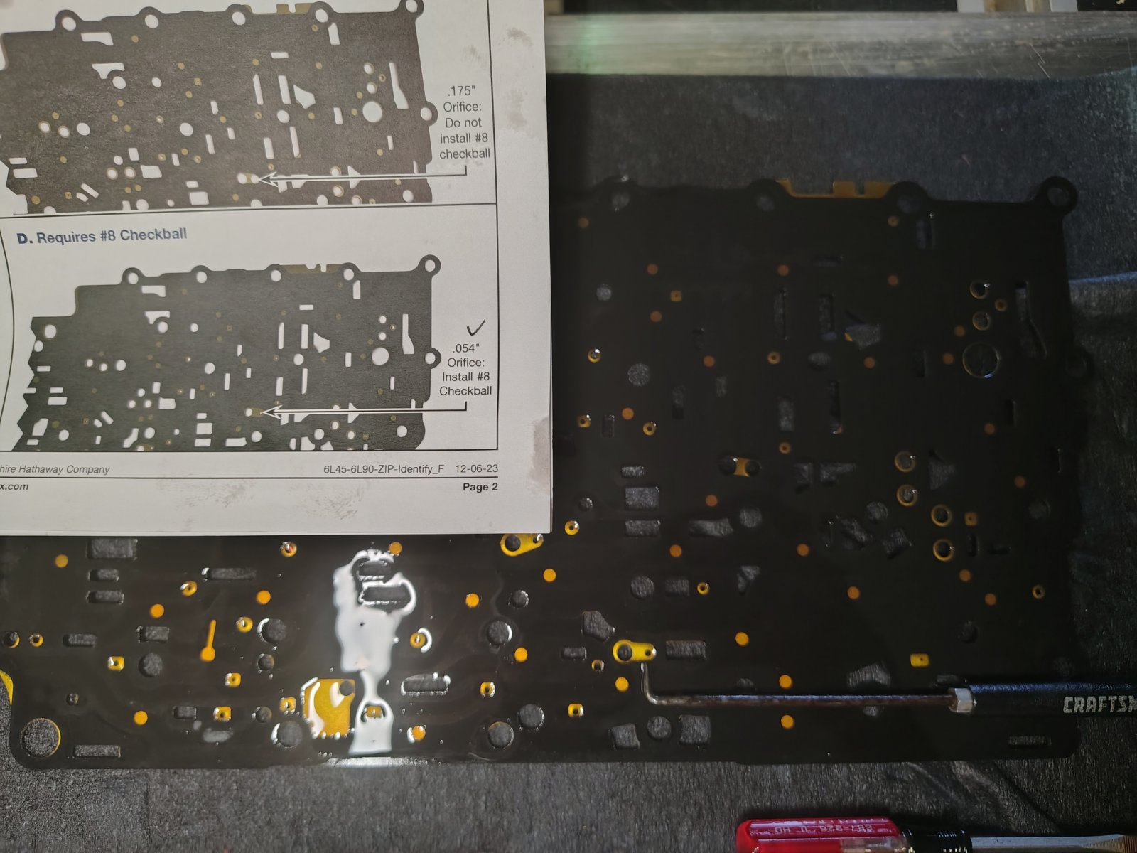

Emailed Sonnax about the use of just the valve body side of the ZIP Kit; the answer is yes as the rest of the parts are intended to compensate for wear in the pump which I don't seem to have after watching the pressures.
Dropped the TECHM + VB complex today and tore it down to inspect all of the spools, retainers, etc. What I found was all great except in one area... I have a late 2nd pattern separator plate but the rebuilder had left out the 8th check ball which is directly against the Sonnax instructions.
I don't know what this circuit does but could be the root of some of the wierdness I've been having.
I kept going with the kit and just need to get an inch-pound torque wrench and some DEX VI tomorrow. I debated reusing the 3mth old stuff which I caught in a clean container but now is not the time to cheap out.
