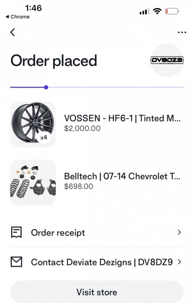

Finally started putting together a plan for the performance upgrades I’ve wanted and spent many hours researching, asking forum questions and meeting with multiple vendors for the install and parts selection.
The build will consist of the following:
Vossen HF6-1 24” wheels with a gunmetal grey finish.
Belltech 753 kit for a 2/3 drop/ keeping the z55 suspension
TSP Cam Swap Package- AFM/DOD and VVT Delete. I asked for a cam that would play nice with the supercharger that’s going to be installed at the same time.
-TSP L92 Truck Cam 216/228, .600/600,
113 LSA (25-TSP216228-113)
7.400" (25-7400-1)
TSP.660" Dual Spring Kit w/ Integrated
One-Piece Seat & Seal, Titanium Retainers, PAC Springs #199-TSPPACPOL660SPRINGKIT.

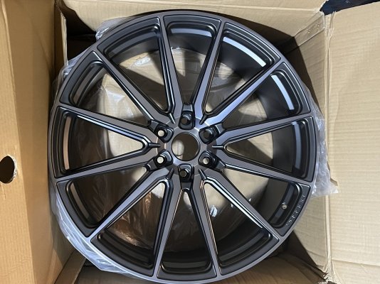

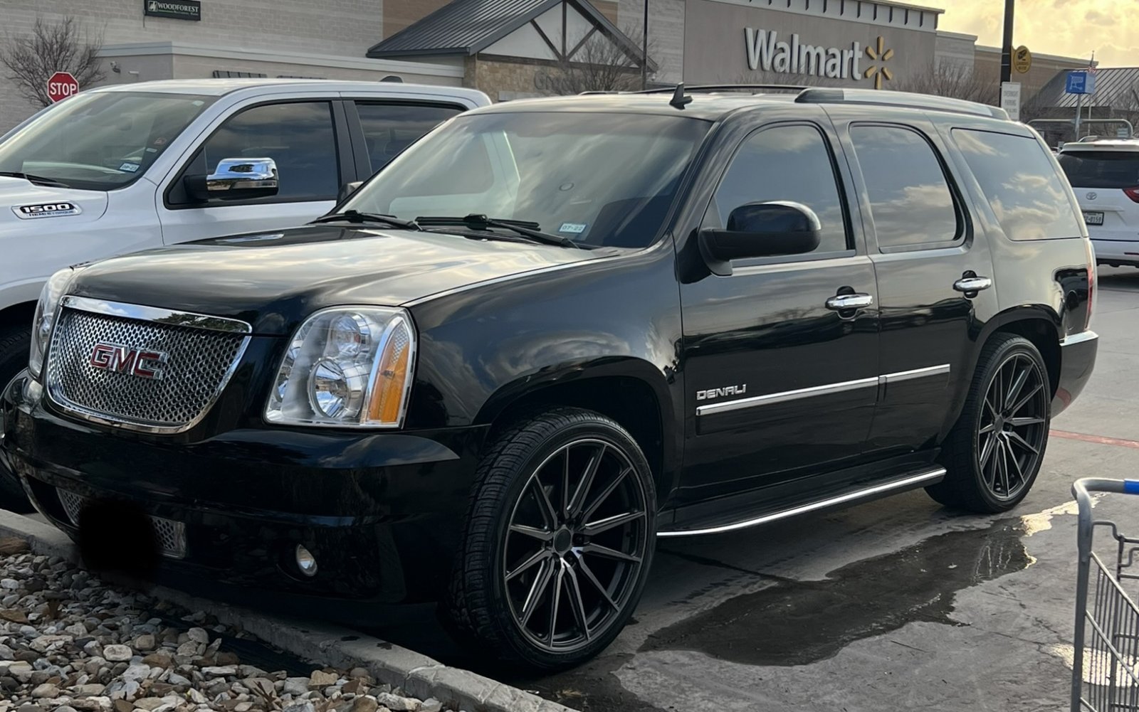

A lil closer- just need a missing awol wheel to make a set :oops:

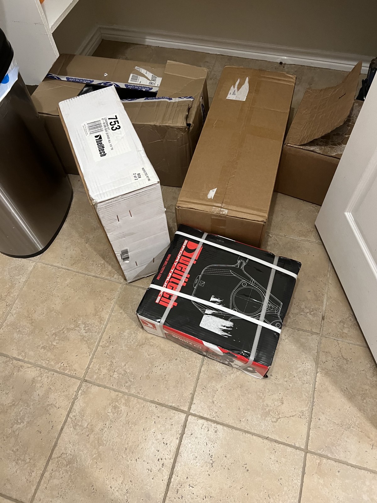

Project finally started.
Dropped off my Denali to have the Belltech 2/3 drop kit 753 and some oem GM Z55 suspension parts replaced.
2x acdelco 580-434 struts along with new GM strut mounts (entire front coilover assemblies were done about 18 months ago) front & rear upper control arms and trailing arms using all oem GM products.

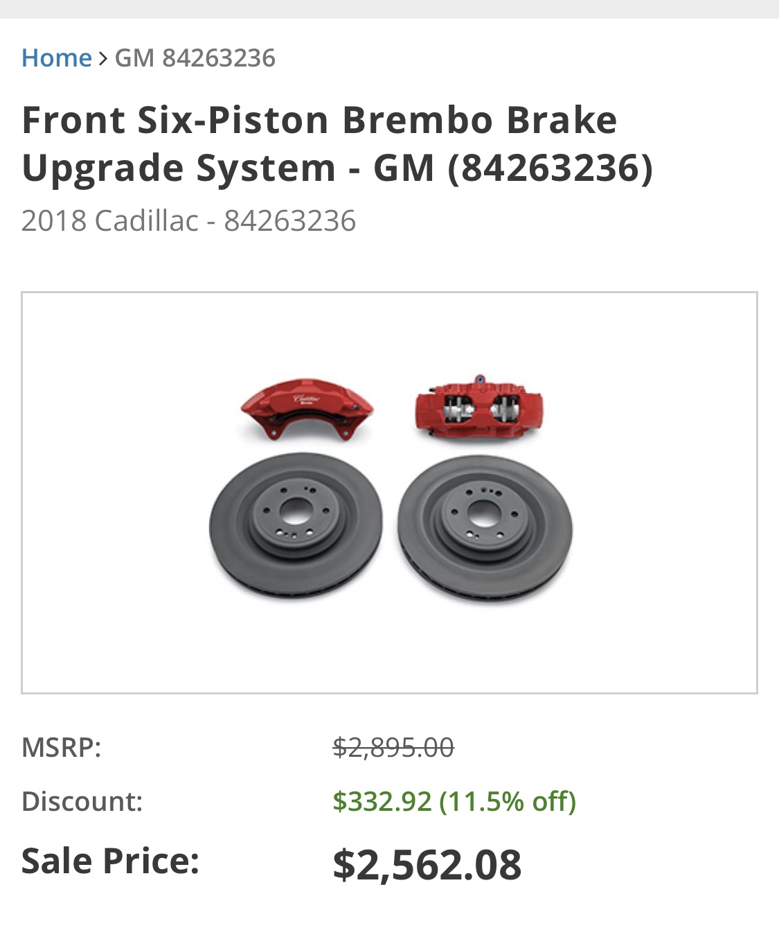

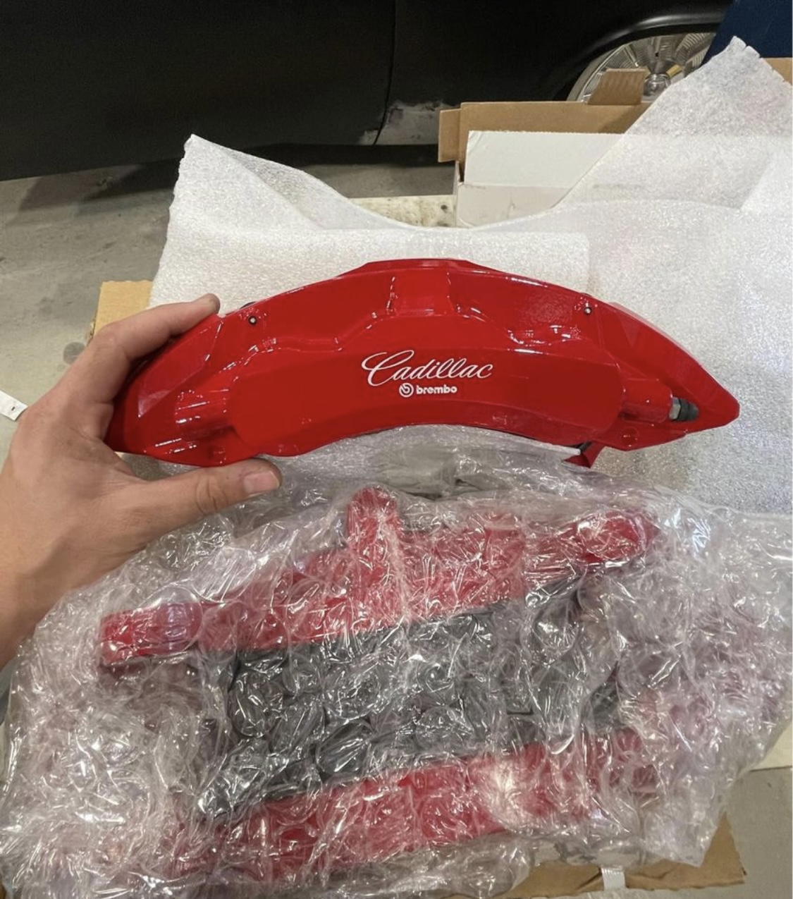

When I took a look at the new Vossen’s and how much the rotors and brakes show thru now, Im thinking how good red calipers would look and decided to look for any deals on the Brembo GM Big Brake Kit by chance. Well be careful what you ask for right?
Found a killer deal on a brand new Brembo GM 6 piston/16” rotors upgrade kit (front end) that I’m pulling the trigger on today.
It’s branded Cadillac so I’ll need to have the logo removed or changed to GMC but for what I paid.. I’m good with that.

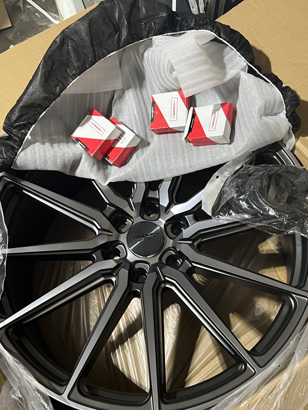

The missing/AWOL wheel showed up today along with my center caps thankfully. Now I’m waiting on TSP.
What color lug nuts did you go with? Did they actually have gunmetal or were they either black or chrome?
I couldn’t find anyone who made a center cap for my wheels or gunmetal lug nuts for the size/style I needed.

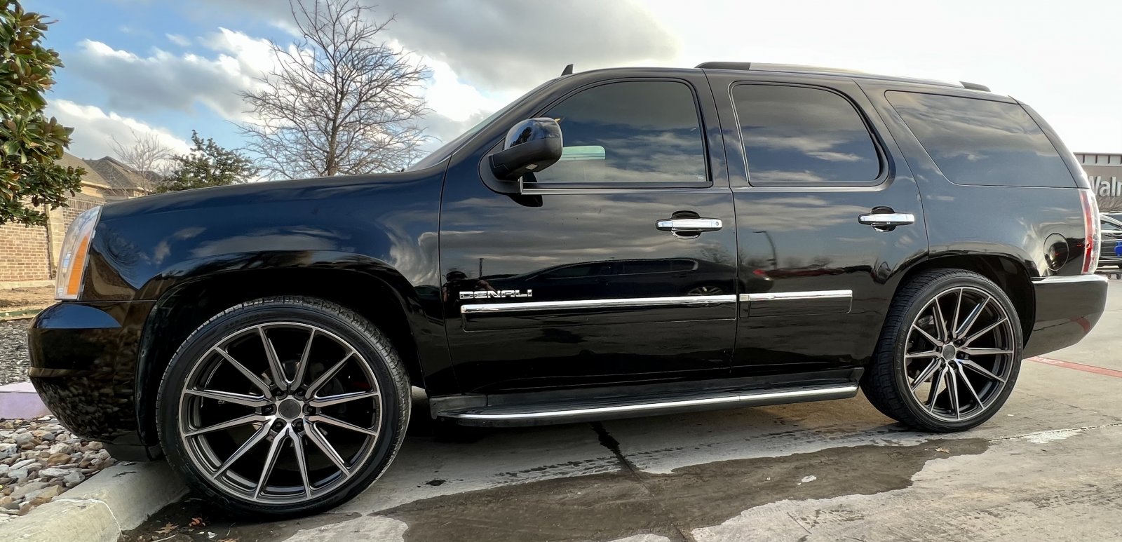

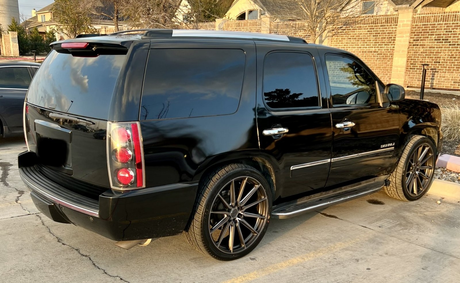

I haven’t been good about updating progress .. that’s on me sorry.

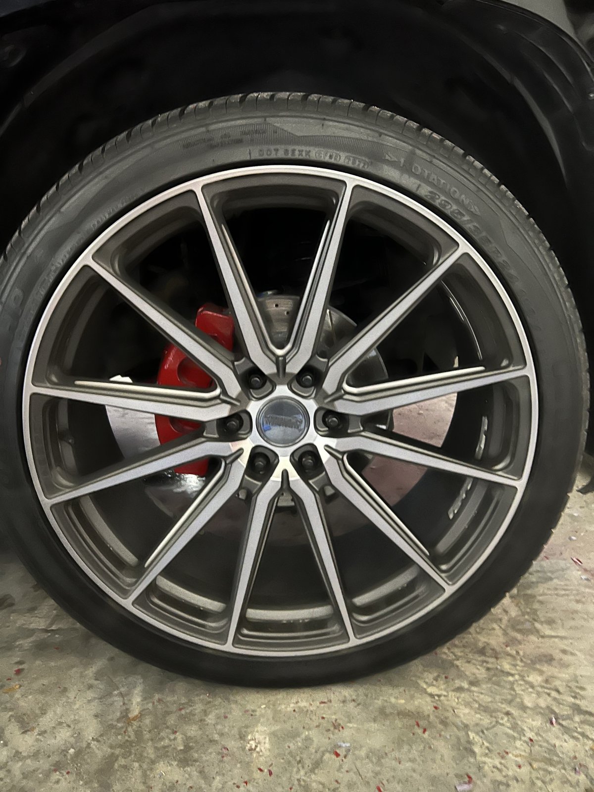

So here’s a bit of an update post on the suspension drop package, wheels, tires and a why the pause ramble.
Belltech 753 2/3 drop kit installed along with a few replacement suspension parts, completing my total z55 refresh I started in 2021. Goal was keeping the best ride quality possible.
24” Vossen HF6-1 Wheels:
(139.7x6)
I had these wrapped in Nexen Roadian HP 295/35/r24 tires. I’m very happy with the ride quality of the Nexens and feel no loss of ride quality coming from my 20 oem Bridgestone tires I’ve always run and been happy with.
(Discount Tire price match @$229.94 from Walmart per tire for me.)
I went back and forth over between Toyo Proxies (which to me are the best option out there for a 295/35/r24 tire on our SUV’s)to something of a better quality than the the basic cheapo Chinese Lexani etc tires and I’m good with the result and ride quality. (No hate just a personal preference, I can’t skimp and settle for a rough riding tire)

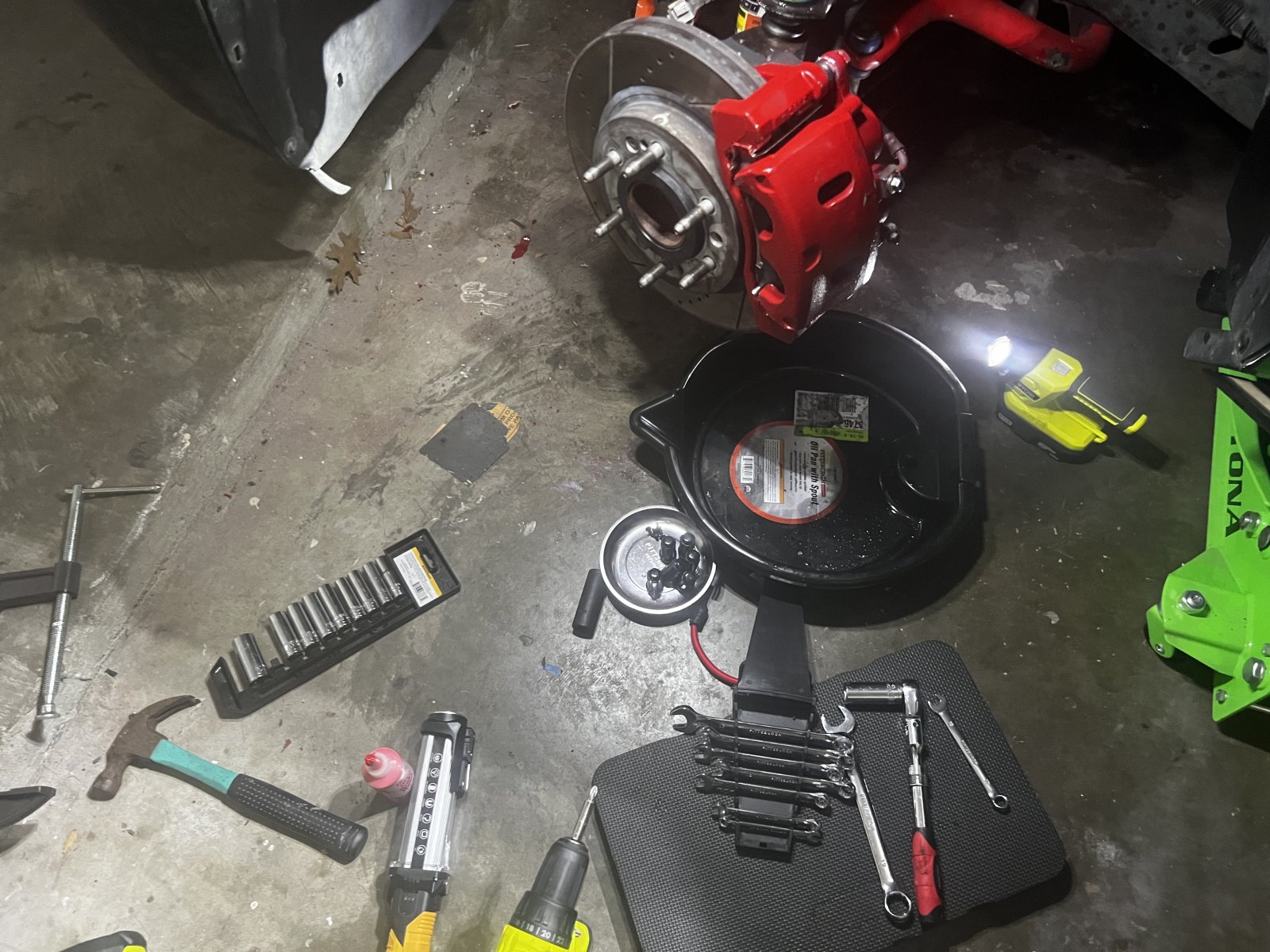

Big Brake Kit- Pause for now
I had actually scored a crazy good deal on the GM Brembo big brake kit new for under 1500.00 but I decided against it at the last second knowing what all else I have on my list.
I just painted all 4 rotors red for now using VHT caliper primer, paint and clear. I’m really happy with the looks and how it turned out but Will absolutely revisit and complete some type of big brake kit upgrade in the future I believe.
That’s it for now and I’ll do my best to add better pics soon. Just wanted to circle back and update while I was thinking about it.
