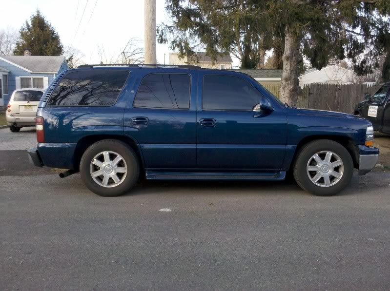

you guys are killing me. this is the only sneak peak you get as i didn't want to post pics until i'm done.
sitting on 265/65/18's. according to tony's measurements, the ass should settle down about 1 1/2 or more inches plus i don't have a spare either. the ride is better then stock imo.

Yes you wont get 1.5 inches but 1/2 should get more.
on that truck with no spare on that tire 33.5 is what you should be at.

rear hardware kit
djm tb springs
rear hardware kit??
with no spare you should be at 33.5
rear hardware kit
djm tb spring
djm shocks.
it's the kit you set me up with last week.
i'm around 33.5. measured yesterday when i was done and the drivers side was 33 1/4 and the passenger side was 33 7/8.
