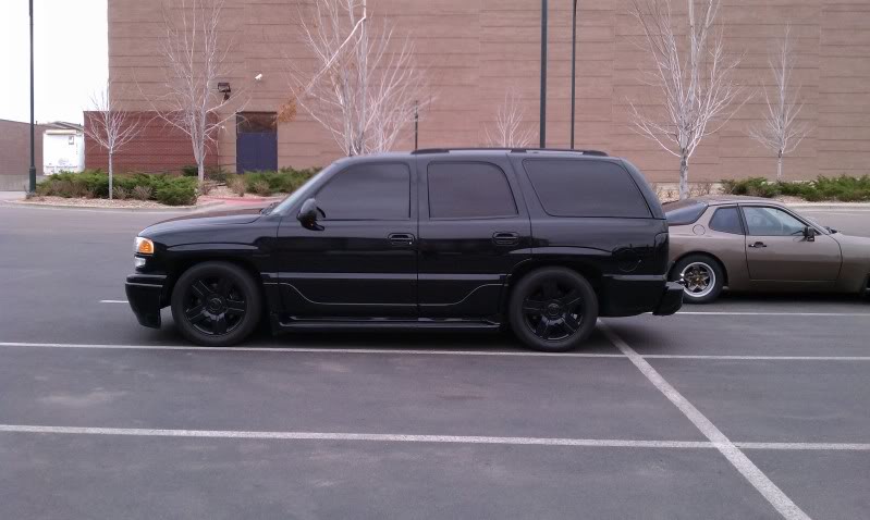

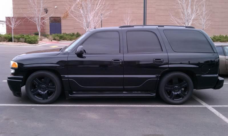

any better shots yet max? still rolling the 30" tires?
Coils still have to settle too, hoping for 25psi in the bags and 31" so it sits on the new tires nice. Wheels may be coming sooner than later if I get my hustle on this month. Truck is pretty dirty but this is all you get until I paint some shit

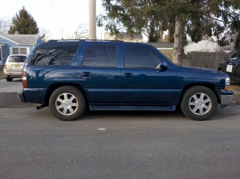

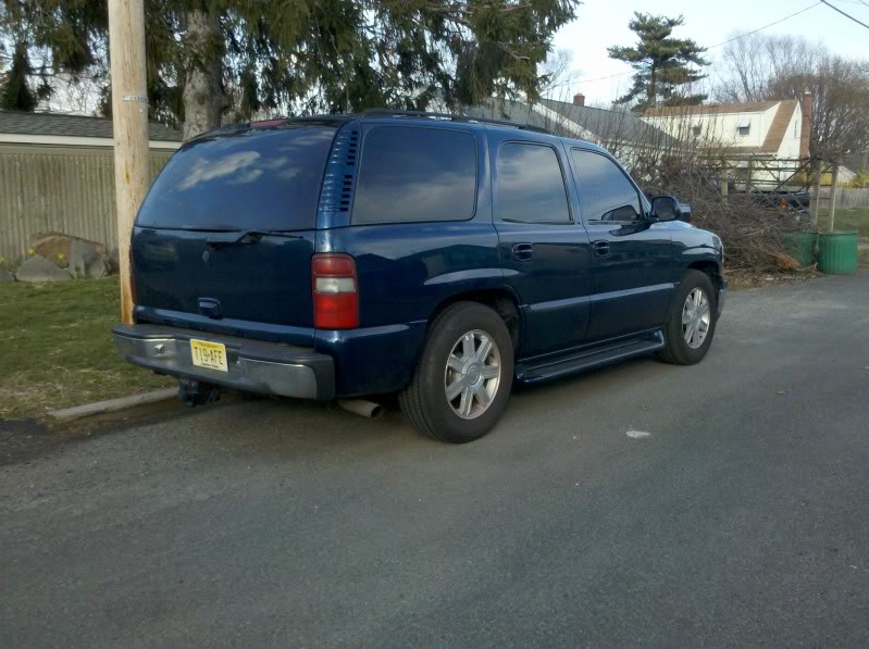

i'm thinking our drops are about the same amount then give or take a half inch? if youre at 32" fm on the drivers side on 30" tires and i'm at 33" fm on the drivers side on 32" tires then is should be the same. :think:
this right tony?
your's just looks so much lower then mine tho still.
these pics were taken on saturday but it has dropped some since.
NORCAL SS
SUV SUSPENSION GURU
Jun 9, 2009
8,744
610
the new belltech tb springs sits about 3/4 to 1 inch lower about.
with no air he was at 31 inches on 30 inch tires (I think thats what he said)
you are at 33 inches on 32 inch tires.
his tires are 2 inches shorter so that would be 1 inch drop in fenderwell height (20 inch tall tire vs a 30 inch tall tire truck wont lift up 10 inches but 1/2 the acutal difference)
on his tires you would be at 32 inches from ground to fenderlip.
