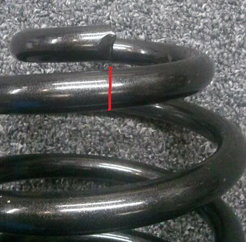

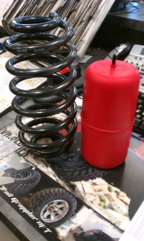

ive been cutting these same belltech springs for months now here is a pic of the one set ive done
heres were you cut it
level off top

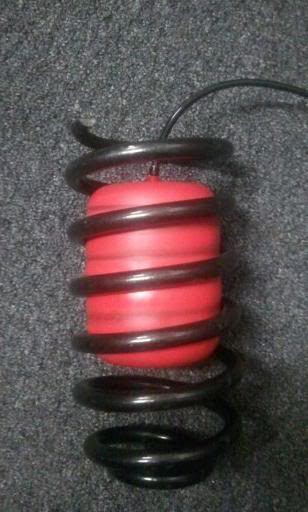

and the helper bag inside you will get about a 6-6.5 inch drop. Your bag is MUCH to tall
When the truck comes down there is less then 6 inches of space and in turn your helper bags will bind and cause ride to be worse.
also the street performance belltechs with this set up ride much better. the 5100 bilsteins are jarring.
now on the cutting of the coils ive cut 2.5 loops off you will need the 18.5 extended shocks.

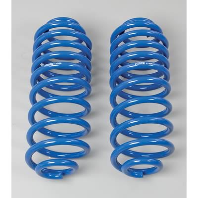

These little guys?
Those 60748 work inside? I'm gonna be on the 12th set of coils on this goddamn thing soon. Takes a bit more to run quick up here at 5280' unless you have boost so 100 or 150 shot should do the trick once I throw an 80e with a stall in this *****.
