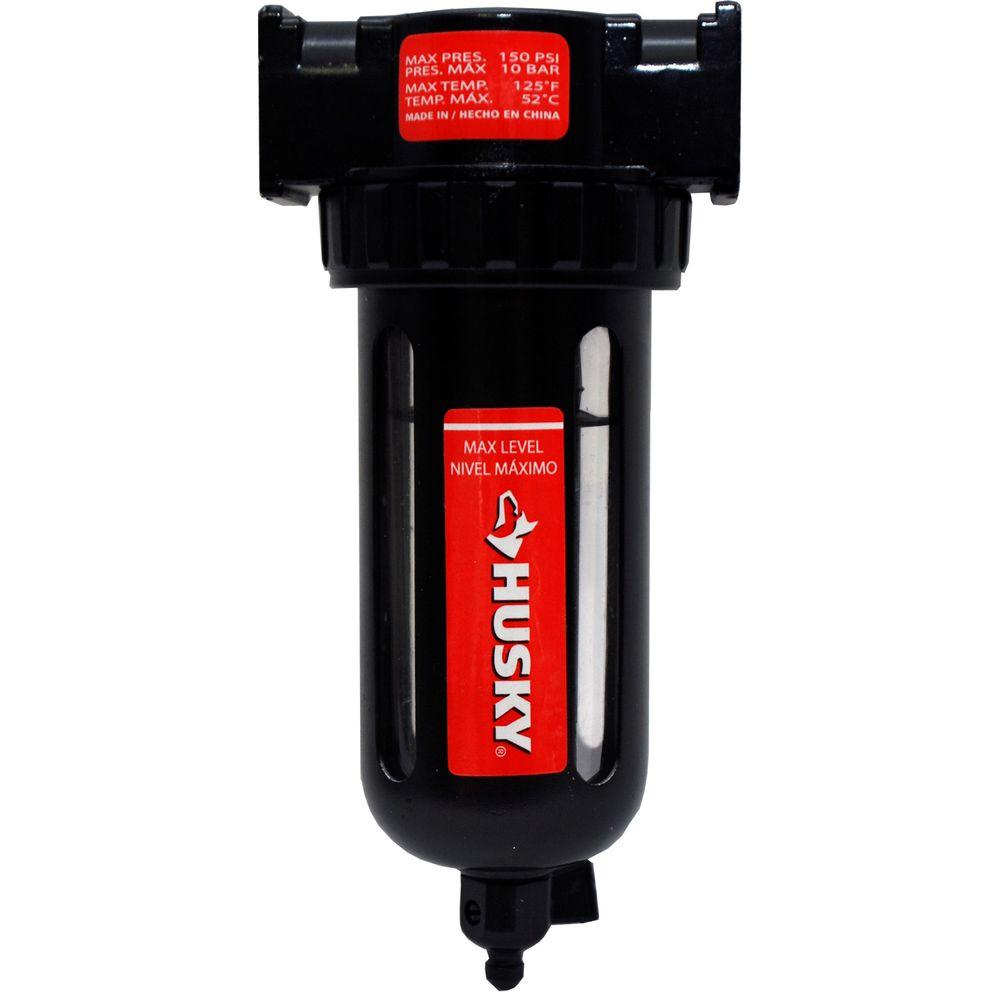

I just made my own using the following compressed air filter:
https://www.lowes.ca/air-tool-accessories/kobalt-38-in-air-filter_g1186695.html
In about 1000 miles I collected a couple of ounces of oil (about 1.5" in the bottom of the home made catch can.
However, the plastic innards partially melted from the heat. I'll try to mount it farther away from the engine block. This is really too bad because this $40 in air filter seems to have done as good a job as the $100+ catch cans. I may just have to bite the bullet and get one if heat continues to be a problem.

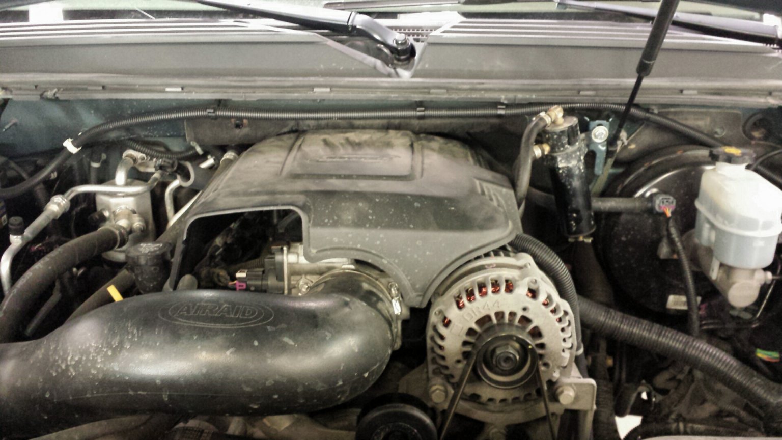

I used a Husky compressed air filter from Home Depot. Only one I could find that was all black (mine didn't have the stickers).
Mounted to the driver side of the alternator bracket and has done great since. Where did you mount yours? I've experienced no heat damage at all.
Larryjb
Jul 21, 2016
1,168
1,089
It was sitting just behind what looks like a battery 12V+ junction on the drivers side, so it was just above the valve cover and exhaust manifold. Your location probably keeps it cooler because of the radiator fan.
I just took another look at yours. Mine is just behind where you located yours. I guess those few inches make a difference.
NGAneer
Jan 21, 2014
1,785
1,023
NWGA
Very likely. When still, the heat from the exhaust would be concentrated on the sides of the engine above the manifolds. When in motion, the heat from the manifolds being blown backwards would keep it away from the front of the engine. The material the filter is made out of will make a difference too, different plastics melt at different temps.
