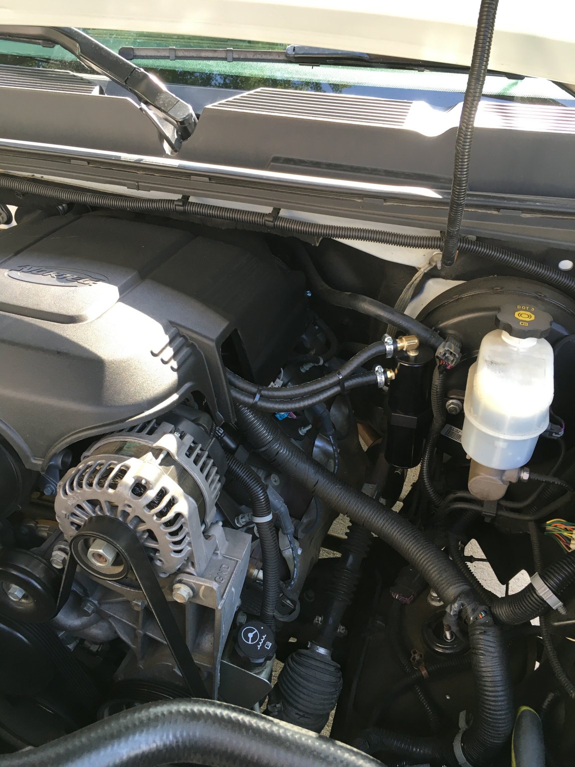

My Spectre CAI does have a CARB sticker but I'm still wondering if they would even know a catch can was plumbed into the PCV. At least on mine, you can't see where the hoses go unless you pull the cover off the engine.

Most of them don't even know what a catch can is. lol

I'm with @Red Rocket. It would be hard to tell where the catch can went without lifting the engine cover, if they even noticed the catch can. I tried to make mine look as oem/factory as possible. Also why I'll be going with a airaid Jr. to keep with the factory look.
