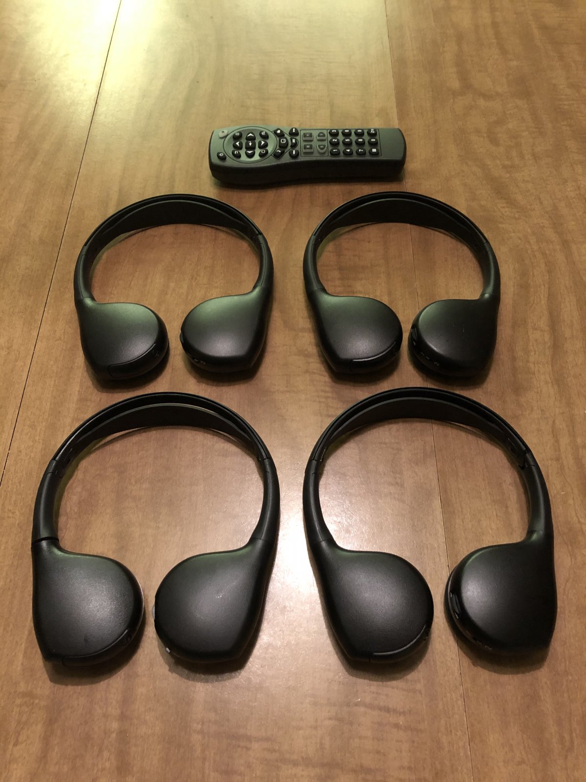

First package of goodies arrived today. $50 on Ebay. All work perfectly!

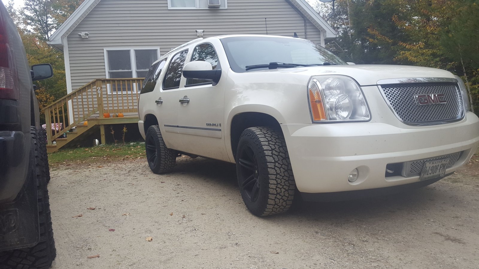

Very nice suburban. My wife's 09 Yukon Denali came with 22s. I purchased a set of 18” wheels and tires. Went with the falken wildpeaks. Awesome tires, esp in the snow. I'm on roads too rough for 22s here in Maine. Will be selling the 22s this spring.

Have any pics of the truck with the 18” wheels?

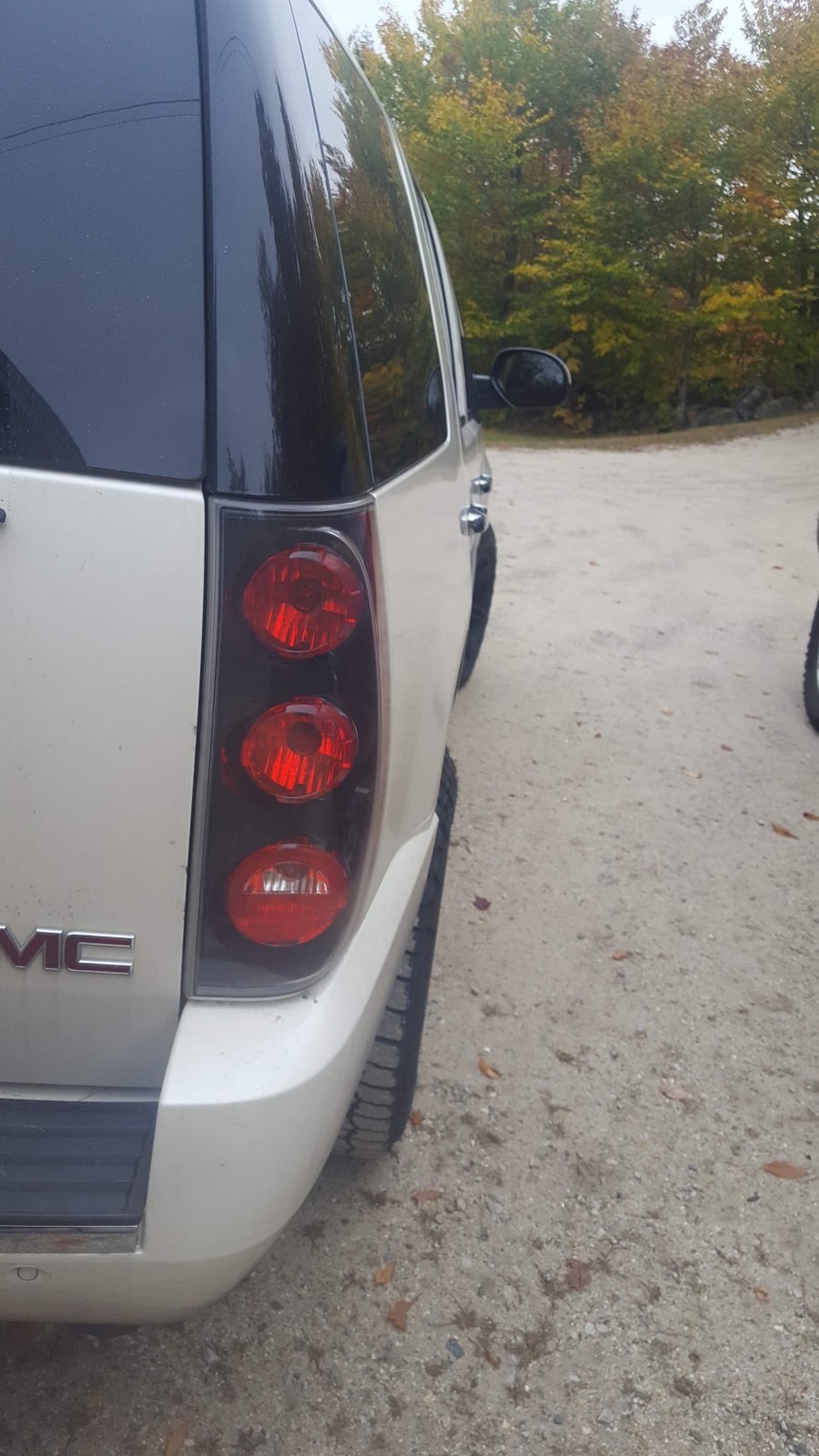

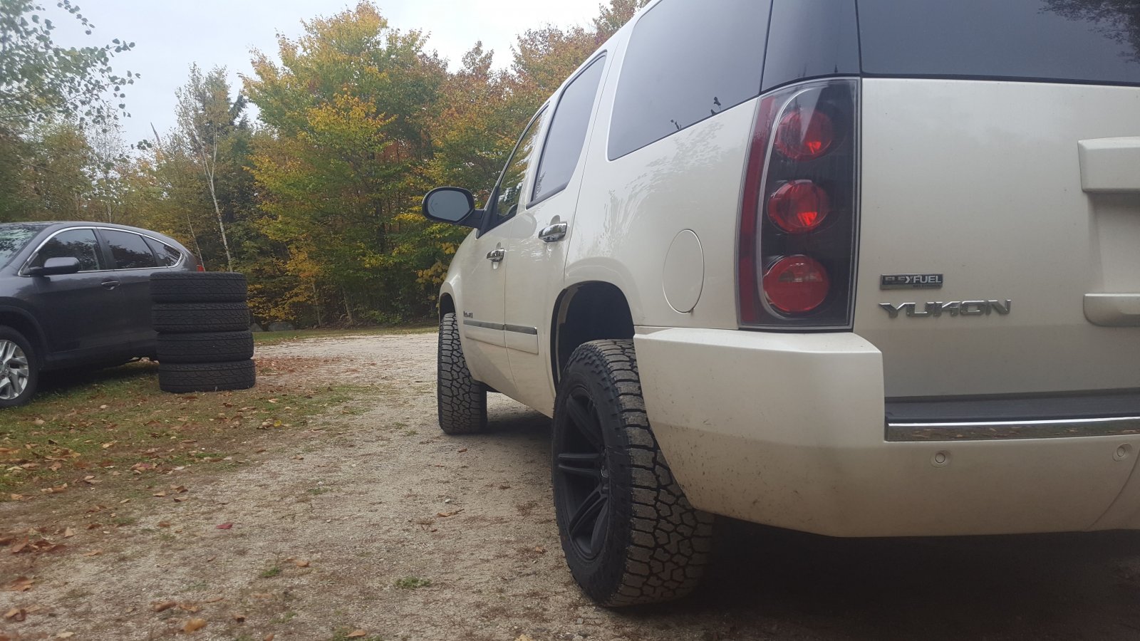

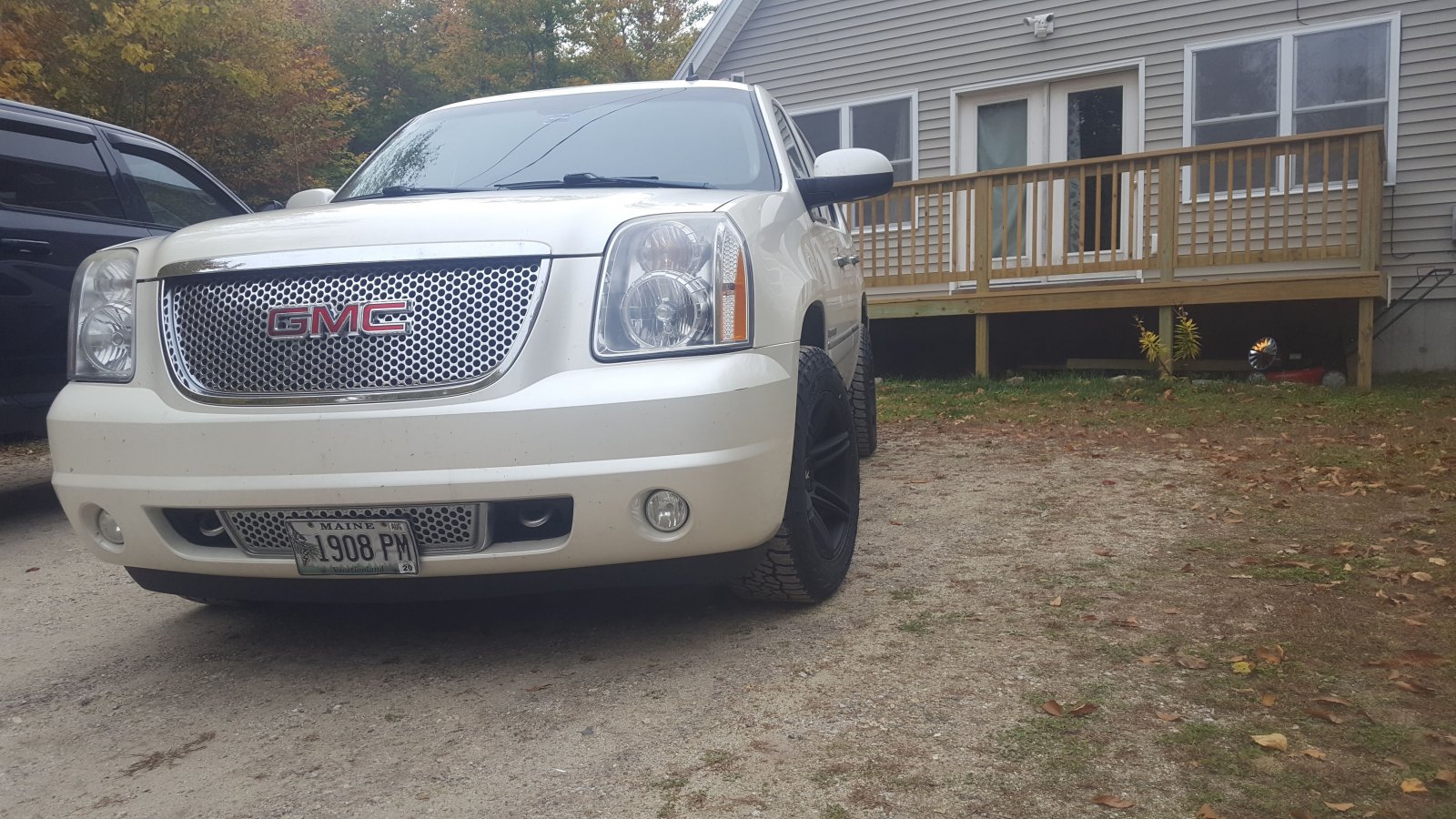

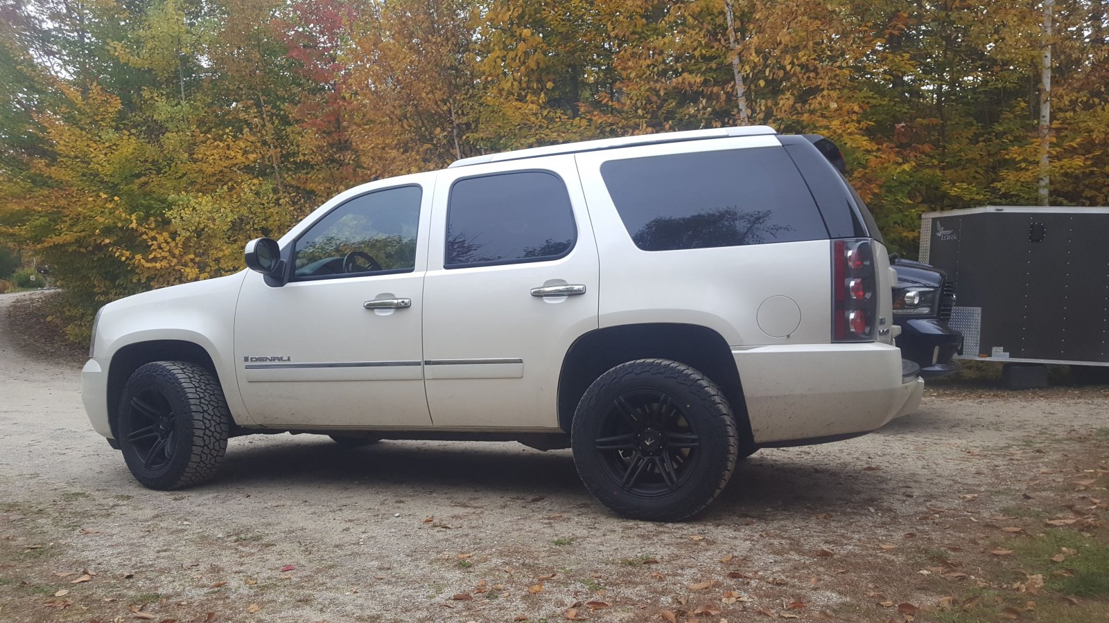

Not the best pics. I can get you more though.
Imo they are perfect for this truck. Ride is much improved and they sit perfect. I like my tires pushing outside the fender just a little bit. If I remember correctly the wheels are a 0 offset and are 18x9.5. so with the lower offset and wider wheels they are out further than the stock size. Tires I went with 265 instead of 275. They have not rubbed once at all either.
