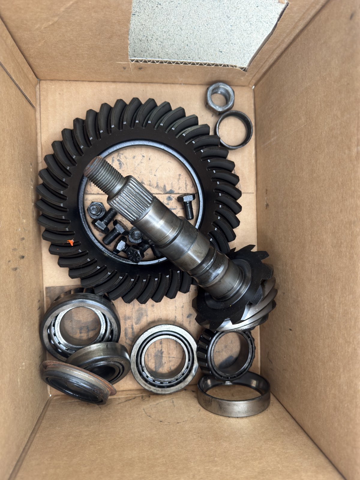

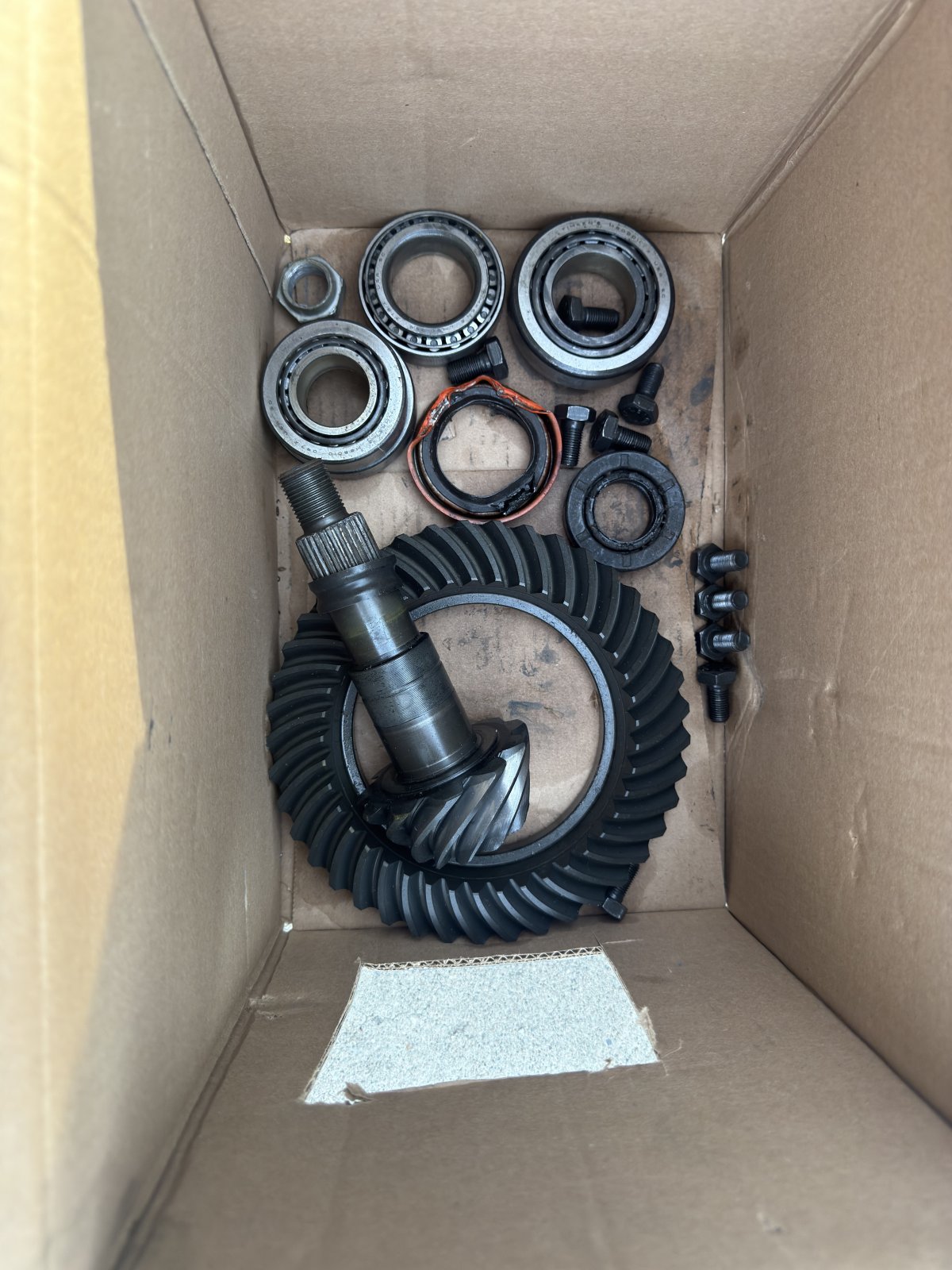

My father just got his Silverado front and rear end re-geared from 3:42 to 4:10 and he gave me his old parts. My suburban has the 3:08 gears. Does anyone know if the gears he gave me are compatible with my truck?
What year are both trucks and what engine do they both have?

My father just got his Silverado front and rear end re-geared from 3.42:1 to 4.10:1 and he gave me his old parts.
My suburban has 3.08:1. Does anyone know if the gears he gave me are compatible with my truck?
If you're strictly speaking of the ring & pinion, answering swathdiver's question will help get you your answer.
Another way would be to snap pics of the Silverado's pumpkin and compare them to your pumpkin,
comparing by size shape & number of bolts (10 or 12 or 14) will pretty much give you your answer.
For best results a tcm tune will be required, but your engine & transmission will definitely appreciate 3.42, in the short & long term.

He has a 2006 Silverado with the 4.8l. Mine is 2015 suburban with the 5.3
If the axles in each are original to the vehicles, no, they are not compatible.
The Silverado would have a Saginaw 8.6" 10-Bolt differential. The Suburban would have a Salisbury 9.5" 12-Bolt differential.
Obviously the ring gear is much larger in the Suburban and they use different carriers as well.
Now, if both trucks are 4x4s, the front 8.25" clamshell differentials are essentially the same and their ring and pinion gears ought to swap over. Doveryay, no proveryay!

Well dang. At least the front will work and I’ll just have to buy the back. Thanks for the insight! I really appreciate it!
