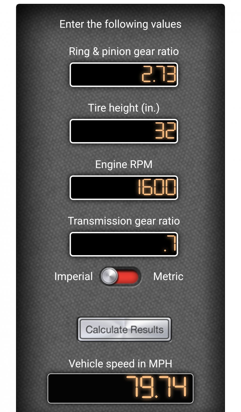

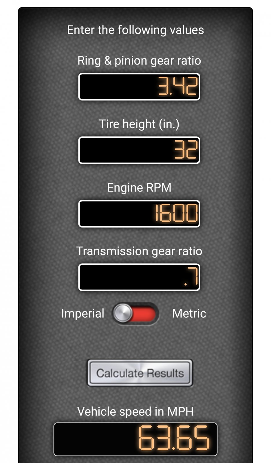

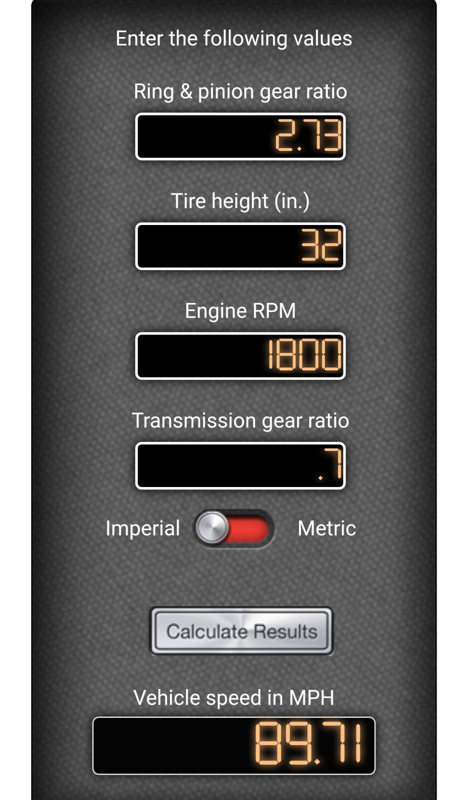

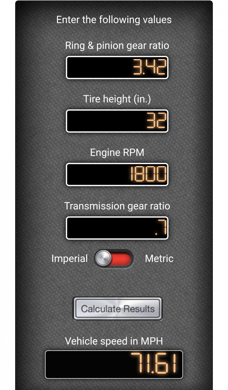

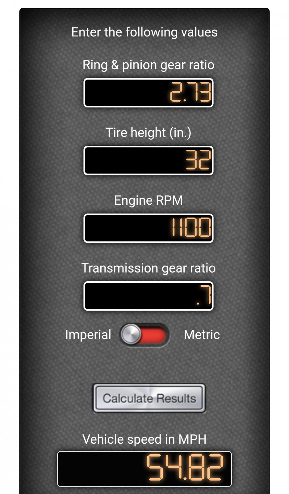

Also a 2 73 will kill your mileage. Most likely unless you are running 75+ you wont be turning the rpms that you would need to stay in overdrive with light enough throttle to get better mpg. (Lugging the engine)
So how fast do you drive?
Mudsport96
Jun 6, 2020
1,420
2,330
40.923,-89.488. Illinois
Some examples of my rpms at speed vs a 273 gear.
