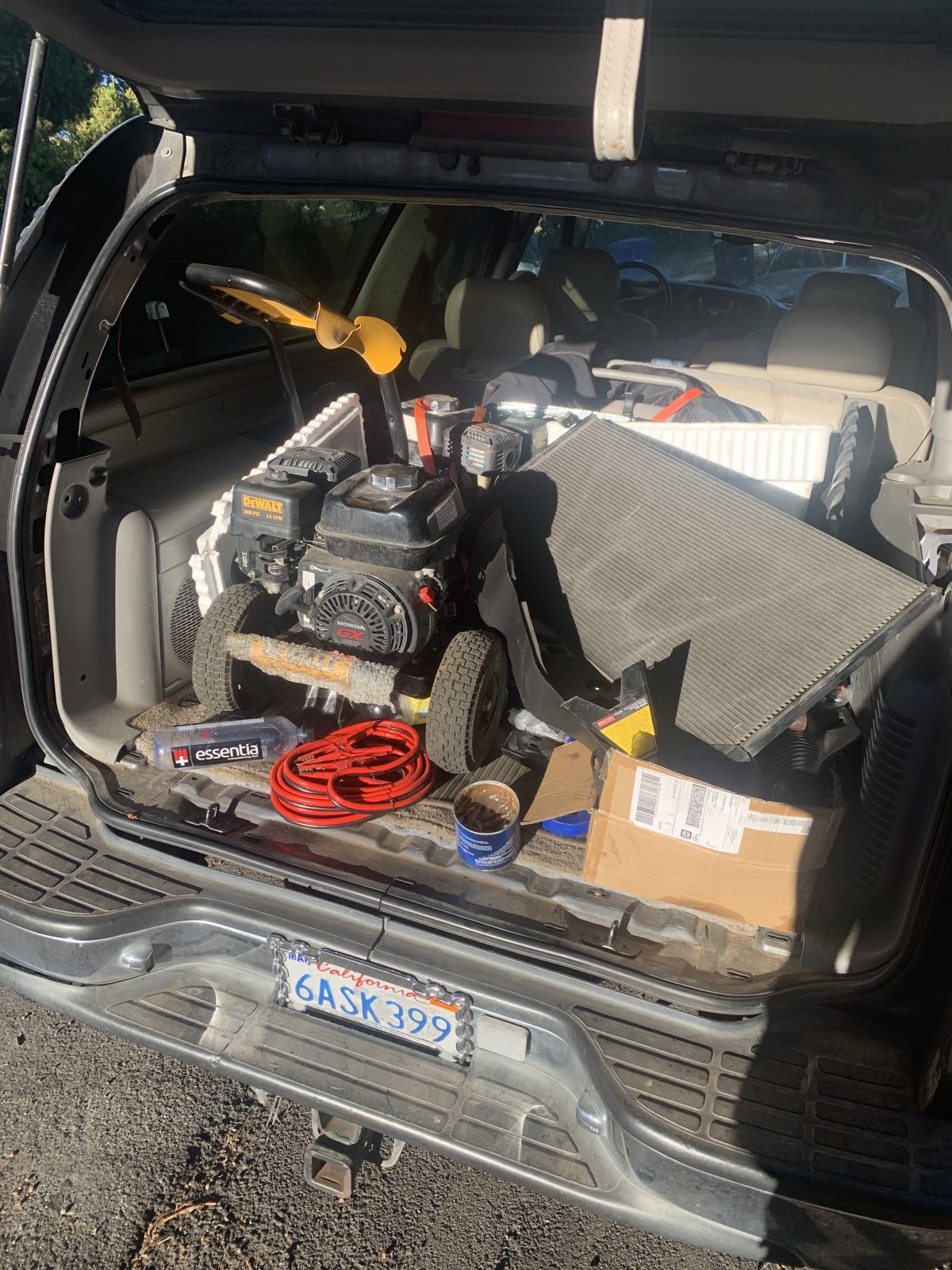

I think the junk is one of the biggest factors 99% of the time I don’t need the 3rd row I have tons of junk in the back like pressure washers n stuff , efans?

Those saying about “just get a economy car” I have to use my truck for work Atleast a couple days a week I’m adding a onboard air system so I can continue to use it as a service truck a lot of the time when the fork lift is in use I have to tow a trailer across the yard (huge work area) or do something that only a truck will do like carry commercial grade pressure washers even if the weight isn’t a issue the size is. I’m at a point to where I Atleast moderately improve mileage or I’m burning a hole in my pocket even on E ($4.19 a gallon) I’m running 85 octane pump gas same gas station every fill up. I’m considering a smog exempt Dodge Dart that I’d do something stupid to like a k swap to save those Pennies. About my tires they won’t hold 60 psi (for long) but the tire shop can’t locate a leak and they’re cheap as can be from the previous owner I’m hovering above 13 mpg and it’s killing me even granny driving.

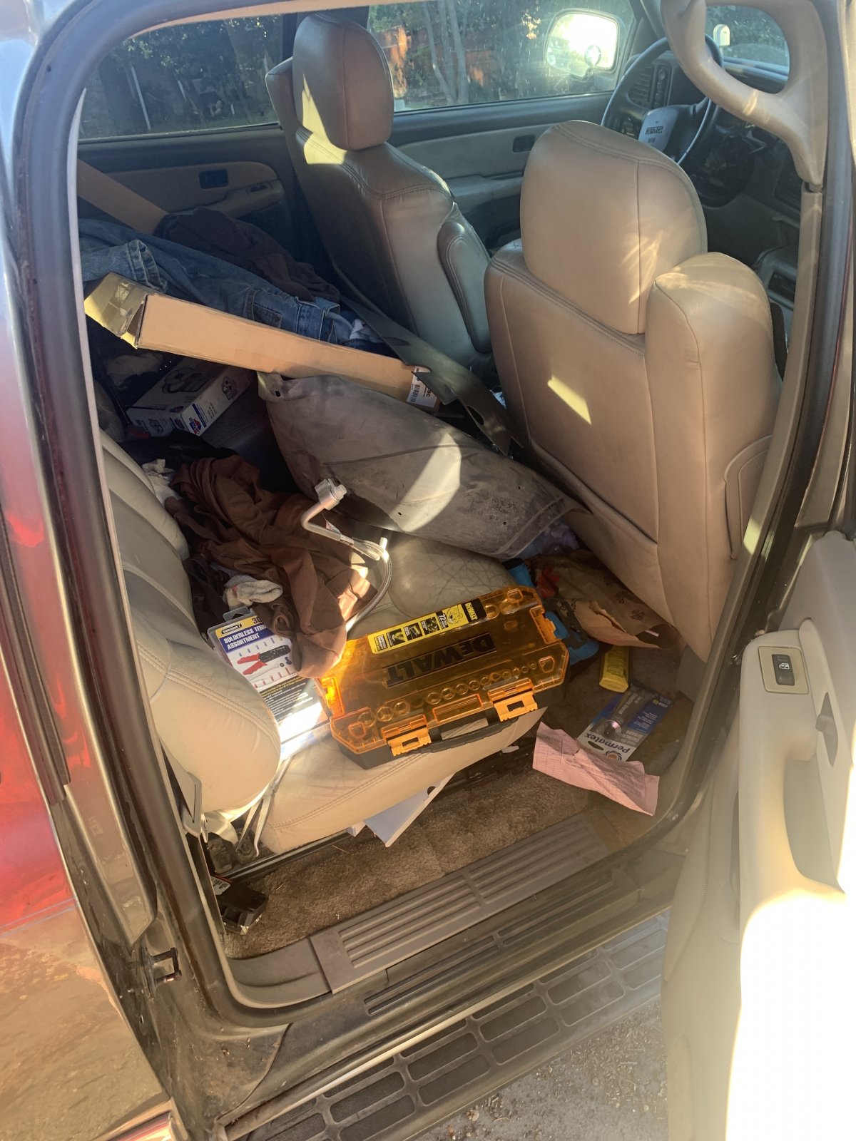

I really gotta take out the extra junk calling me out here!

It’s probably the hundreds of pounds of extra junk in the whip because of work or f all

I would bend over to get 18mpg even if I had to rip out the 4th out of the second row the entire 3rd row 90% of my junk and re gear. That’s a 5+ mpg gain if I’m driving city 18 combined Would be game changing with just how much I drive for work. Check other replies just to grasp how much extra junk I have.

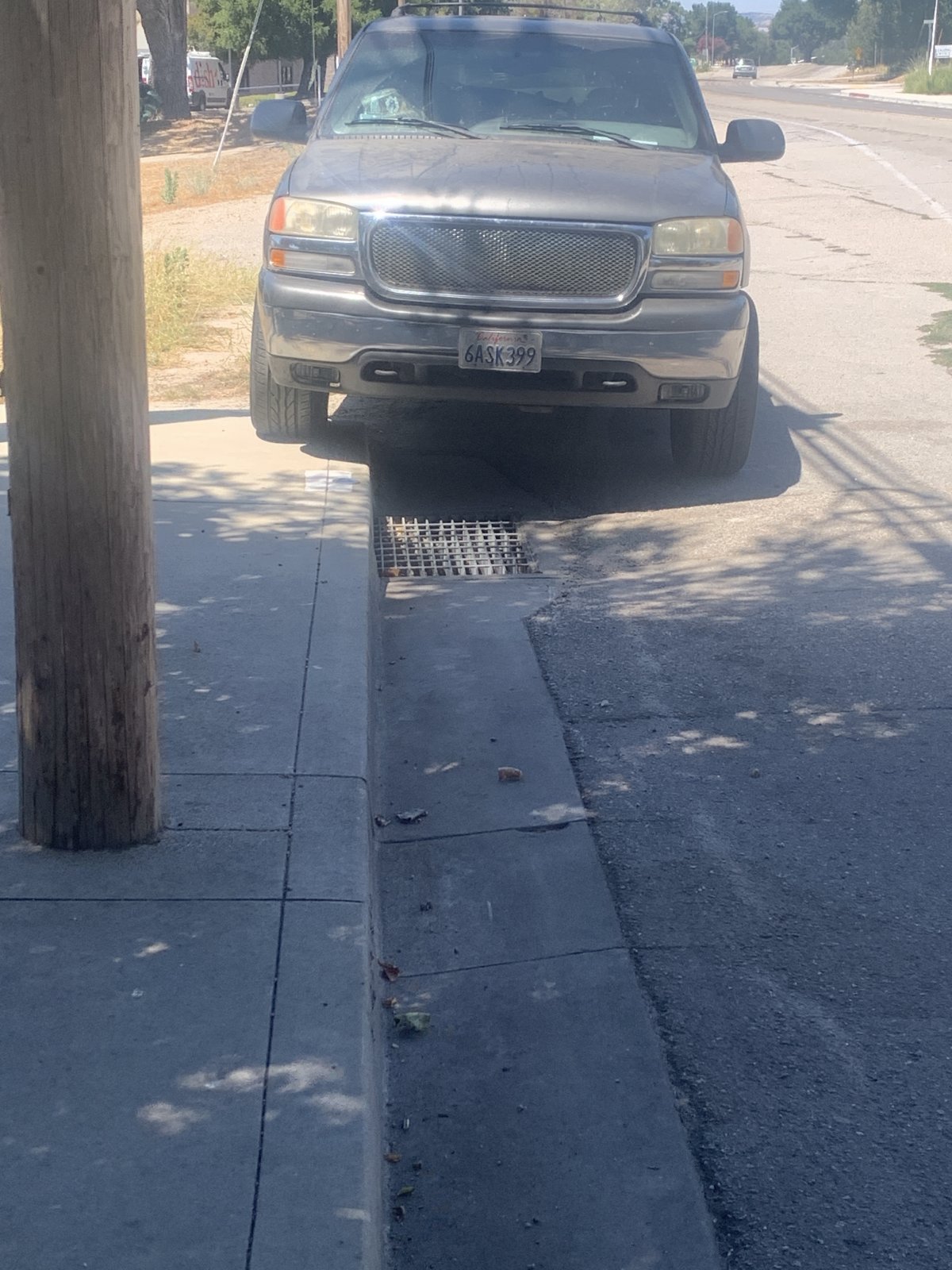

No one's said to lower it and toss heads/exhaust on it hehe

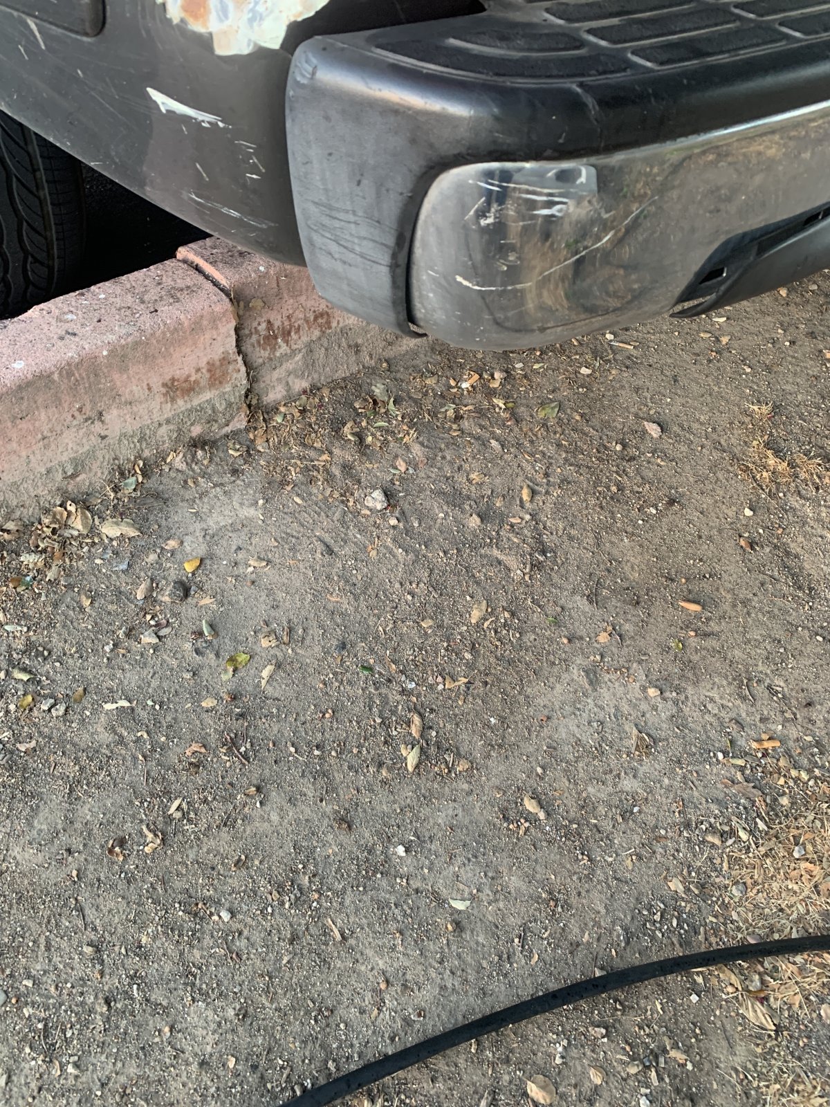

I would scrape everywhere with how bad the roads are, if I wanna park at my siblings house , some days at work if I don’t park like a jeep I either get hit my cars been hit 3 Times because of the ****** California drivers PARKED or my boss complains that I’m taking 2 car lengths worth of space. the 3rd image was the 1st hit and run. I was leaving work went to put junk in my trunk saw it went on security camera and a white Honda HIT MY SHIT like there’s literally 3 lanes worth of space next to my shit and they hit and run me they didn’t have a front liscense plate. We did see their front bumper get ****** up , police were called and they said “no plate no case” AND THEN AFTER THAT SOMEONE MADE THE PREVIOUS OWNERS DENT WORSE AND RAN but that was at night so the security camera didn’t catch their plate of course, 3RD ******* TIME: a Toyota SUV Decided to HIT MY FKNG FRONT BUMPER AND FLIP THE FASTEST U TURN AND RAN don’t drive in Atascadero California guys. you can kinda see it in the first pic my bumper is dangling after new mounting hardware because it doesn’t line up anymore. You see the white line? That’s the closest the road gets to my car at work AND THEY ******* HIT ME 3 TIMES.
