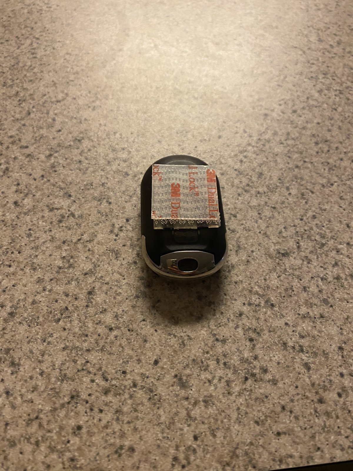

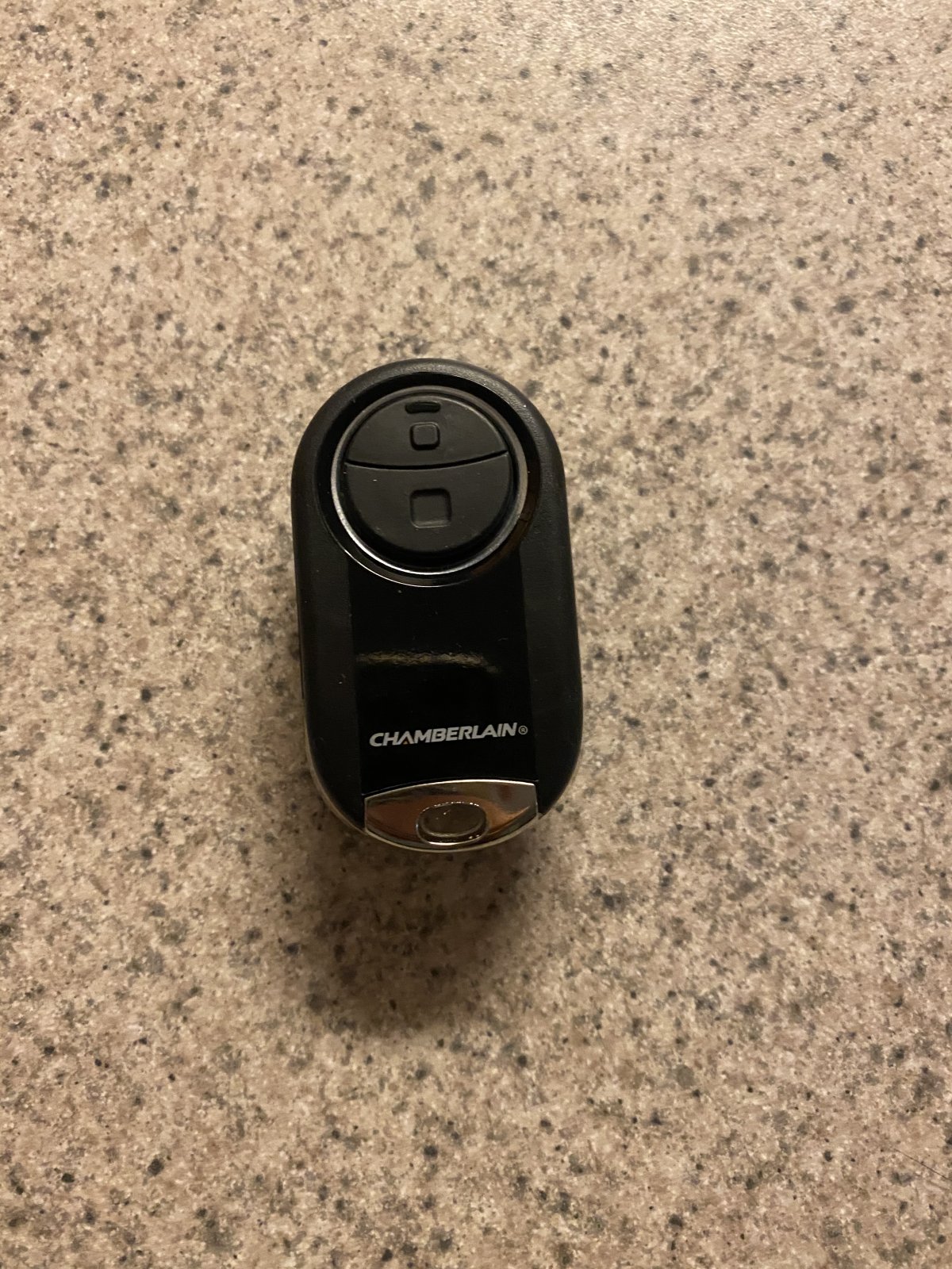

I would never have a portable opener in view, that’s why I opted for the hidden button. They also make mini remotes you can put on your keychain or put a small piece of HD 3M Velcro on the back and hide them under the dash, console, etc. Keeping your doors lock is always #1 to protecting your stuff.
