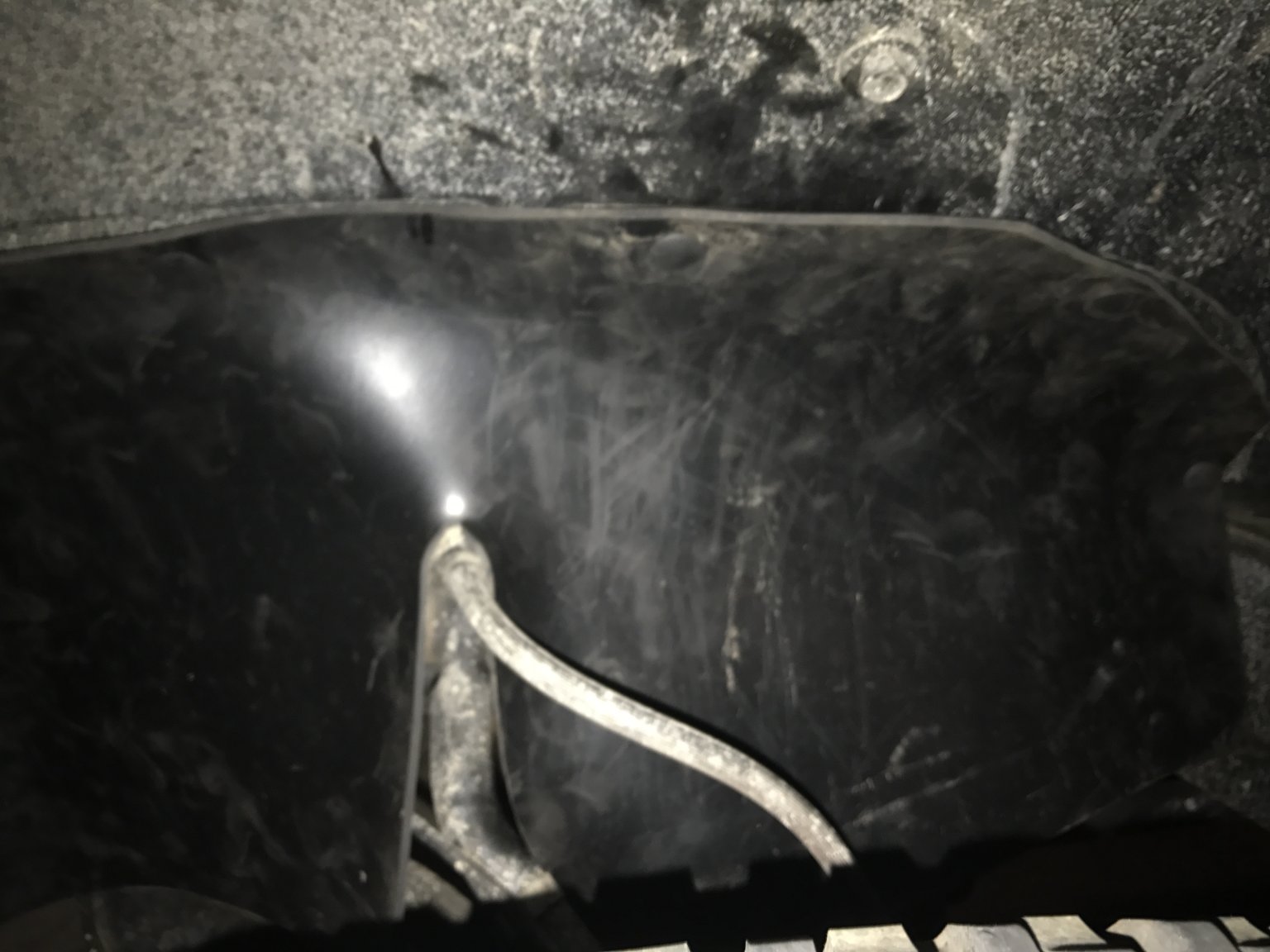

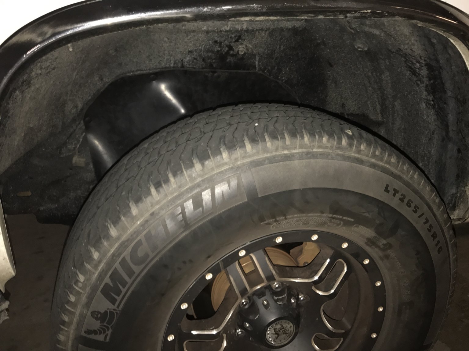

Yes. I made some from HDPE sheet. I don't have a body lift though, mine cover the gaps from a suspension lift between the chassis and body in the front wheel wells.

you can find a 12x24" sheet that I trimmed and cut a slit for the brake lines. Easy and low cost. If there is not a camera flash on the rubber, it disappears into the wheel well and looks great. Who knows how long it will last. Pick up some grommets and push them in.
