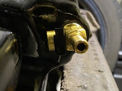

Installed the Fumoto Oil drain valve 12mm-1.75 threads tonight. It will definitely make changing the oil a little less messy and easier. I got the F107N (N stands for the added nipple) with a locking clip. One downside is I couldn’t thread it so the valve lever is visible, but doesn’t matter...still is super easy to open the valve, shut it, and lock it. Some pictures...
They make a cap for the nipple, but forgot to order it. Will be adding that soon!

i wouldnt mind the valve being hidden/protected... simply add a piece of hose and no mess

Been using the Fumoto since 2016. Not a single issue and makes oil changes so muc easier and cleaner. I would not be happy if someone brought one in to me if I were a Indy. It does take a lot longer to drain.

Yeah...I thought about the residue as well. Perhaps after a couple oil change intervals I’ll unscrew it to see what kind of buildup there is.
