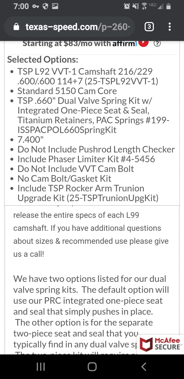

I just ordered a TSP VVT cam for my L9H with the normal core since the 8620 core was out of stock. It's going to be at least a month until I install it though, I'm waiting on ARH Headers and some other small parts.

What are the specs that you ordered on your cam???
Here's the specs:

thanks.. that would be too big for me.. you will need a good tune

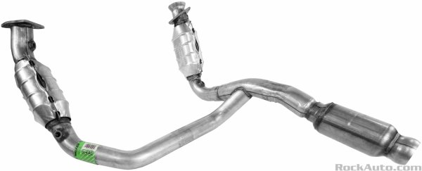

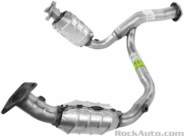

Have to get onto the exhaust. The stock 5.3 exhaust Y after the cat's is a huge bottle neck (see below pictures) I know that a set of long tubes is really the way to go but been there done that too many times. See the difference where the head pipes merge ?
5.3
6.2
I was thinking of getting a 6.2 exhaust and a cat back system to let this L9H breathe a bit better.

That Comp cam # 156-401-13 is on back order 4-6 week wait.
5.3
6.2
Magnaflow cats and Y-Pipe is a thing of beauty and flows great. Was good for seven horsepower on my truck.
