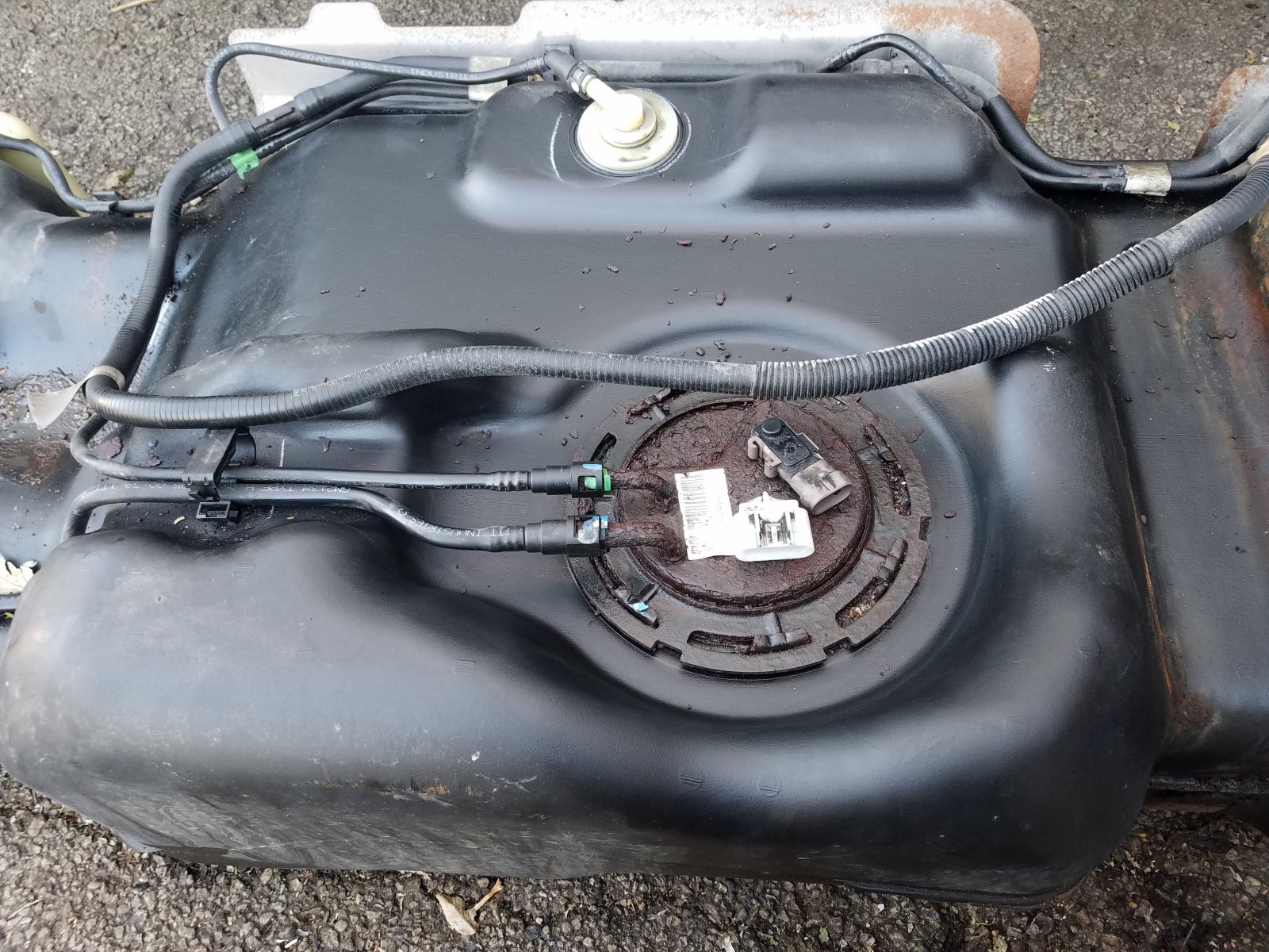

My '04 LT's tank is plastic. Did the fuel pump a few months back, just the pump, using the old lock ring. Tank metal ring was good, too, but we don't have a lot of rust in these here parts. (You can take that two ways...)
Pic is with new fuel pump installed. YMMV Rust is from where it touches the frame.

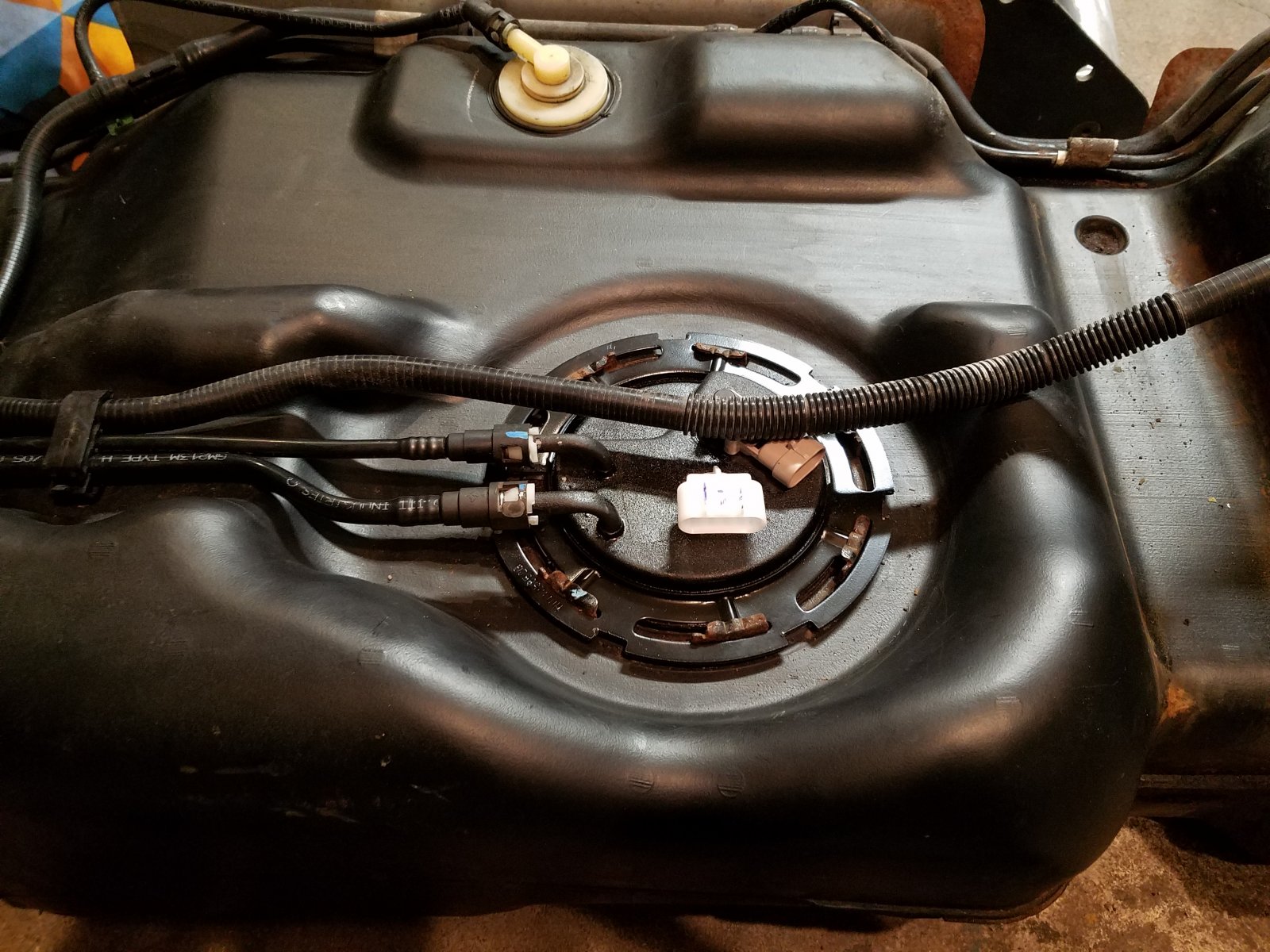

Yup. Plastic. Just make sure you don't knock a bunch of rust into it during replacement. I live in salt/rust central. My pump didn't even die. The lines rusted out and it was shooting fuel under the truck. Lol. I used a new lock ring and sprayed the head of the new pump with bedliner. Sprayed the straps, too. Here is before and after.
