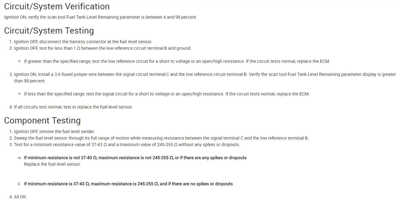

You could back probe the wire for the fuel sender at the PCM, and monitor the voltage.
I came across a thread on performancetruck.net of a guy that posted what voltages should be for a given fuel tank level. I would post it, but I don't remember how I even came across that post honestly. I vaguely remember the thread was about some changes GM had done for different years on the impedence values for the senders? IIRC?
Moderator
16,620
34,397
People's Republic of Colorado
I'd say pull the two connectors on the PCM and check for cleanliness and pin fitment.
Also see this thread that seems to indicate that there may have been an updated "calibration" for the later models (the thread is for a 2004) but something like that might also apply to yours. If you have a scanner that reads the calibration IDs you may be able to see if a newer one is available.

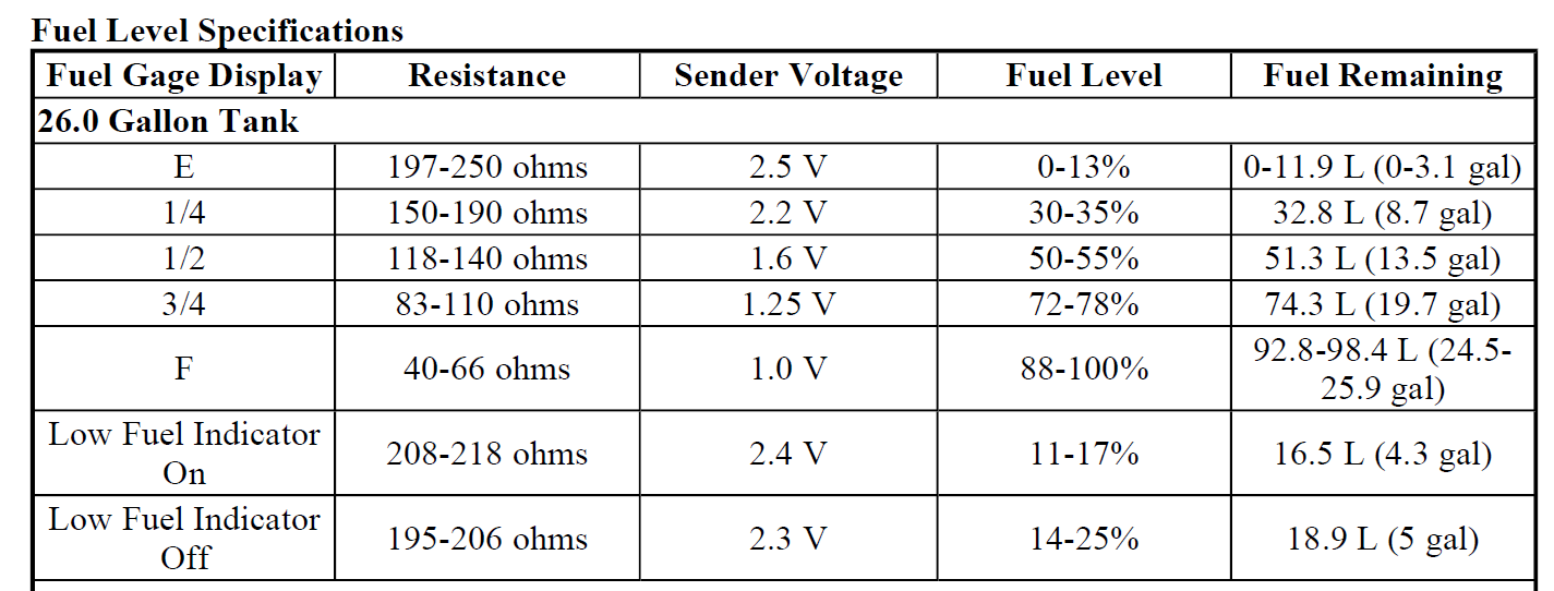

The early GMT800 ('99-'02) was 250Ω full, 40Ω empty. The switch to CAN bus in '03 and on through the GMT900 had the impedance scale reversed to 40Ω full, 250Ω empty.
45,013
James @swathdiver shared this with me a few years ago when I was replacing my pump module and discovered the failed level sensor:
Keep in mind that this is for a GMT900. Just invert the "E", "1/4", "1/2", "3/4", "F" and "Low Fuel Indicator" gradients for your pre-'03 model.
