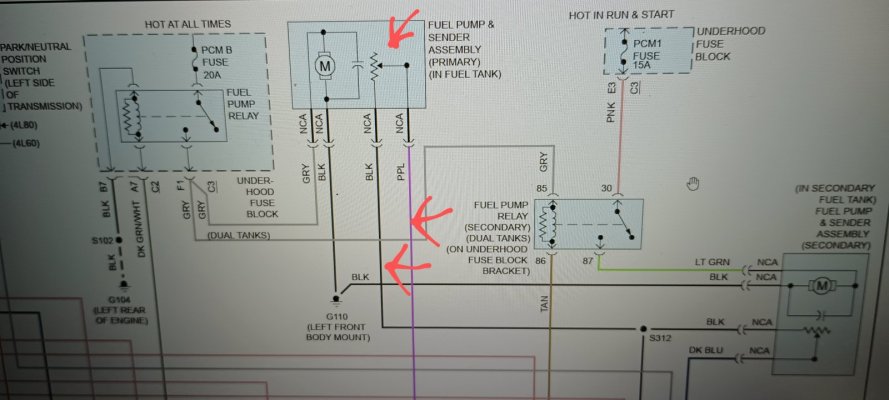

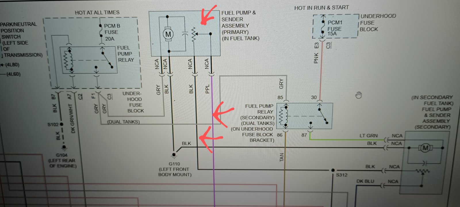

I think I posted my thoughts on one of your previous threads.
Anyways, here's a wiring diagram for an 04 with dual tank setup, although I suspect the single tank should be similar.
The fuel pump/sender has basically a variable resistor on the sender portion. It's just s ground and the purple wire as shown. The purple wire goes directly to the PCM.
You either have a wiring integrity problem or a faulty fuel sender. I know you said you recently replaced the fuel pump, but that doesn't mean the sender is bad. Does the gauge drop any after fuel level drops? I've read on other websites guys have actually posted what the resistance should range based on fuel tank level.

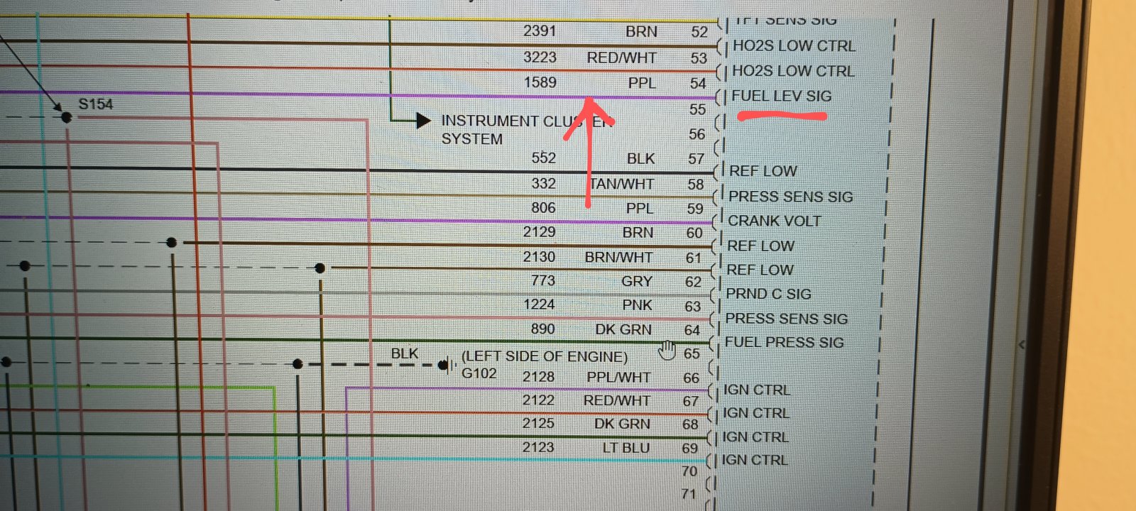

Fuel Level is sent to the gauge via class 2 data from the PCM. Comes directly from the pump to connector C152 under the fuse box, then from there to the PCM. And then it's sent from the PCM via class 2 to the cluster. There is a pin on the cluster connector for the fuel gauge. The cluster connector has been replaced and a better used one was swapped in.

I was messing with my 04 project suburban and I was also doubting my voltages. But that one has the dual tank setup and I had a code for the secondary tank IIRC. That dual tank setup is still kinda of a mystery how it works to me. Unfortunately, I did not check resistance. The truck has sat for several years now. I added fuel and drove it and my fuel guage works again (I was getting a high voltage code.) I think the sender was just stuck.
The only thing I can think of is get yourself another fuel pump assembly (junkyard) and plug it in, play around with the sender/floater and that will tell you if yours inside the tank is bad. I saw Eric on SMA do that on a Corvette was was fixing a few months ago. Or just check resistance and compare them to the published specs on that link that I posted. The comment about getting a scanner that reads fuel level is a good idea. Maybe a friend of a friend has one?
I mentioned recently on another post about the service 4wd message on this same truck. The encoder motor range sensor was bad. I checked resistance while manual turning the wheel and the resistance was erratic.
I hope that helps, but I'm out of ideas.

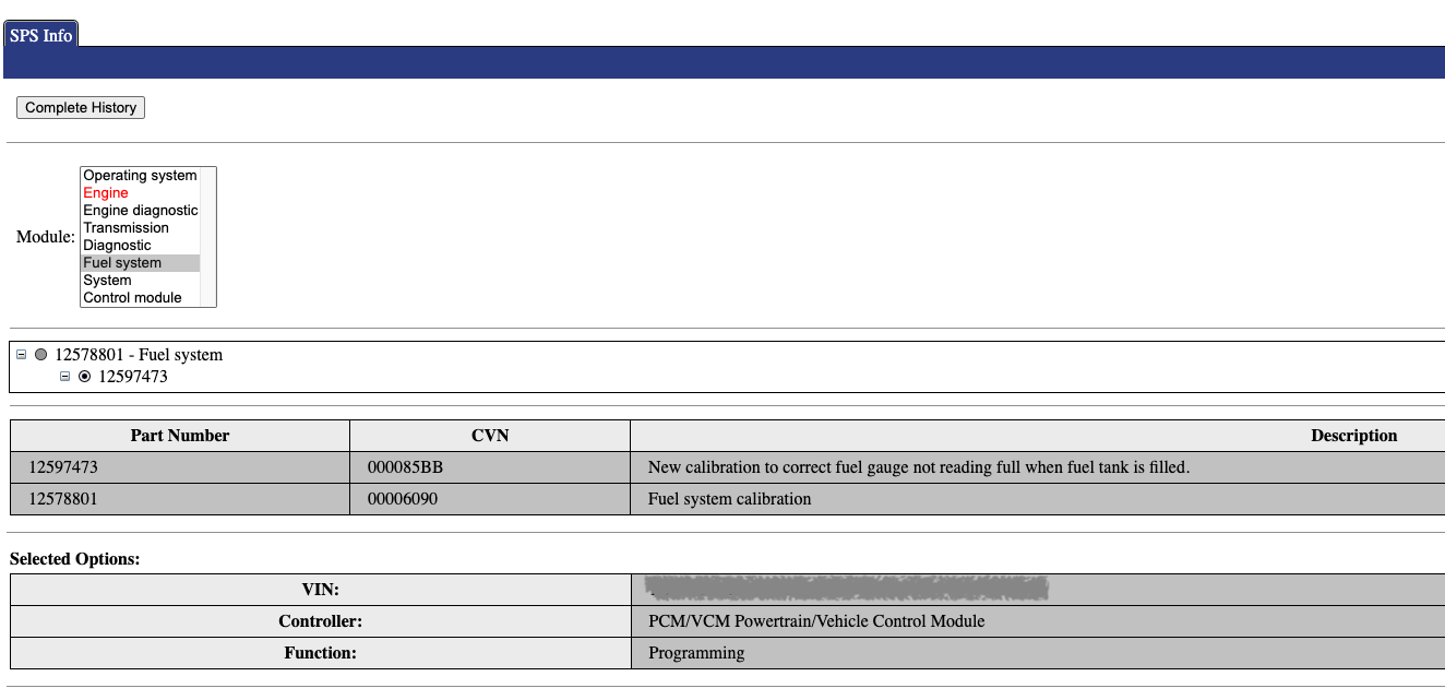

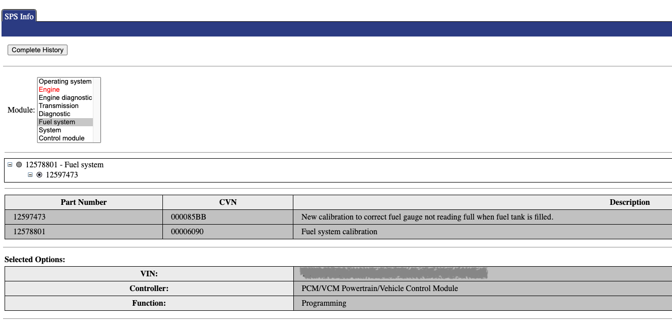

Do you know what OS # you have?
I have a 2004 Flex Tahoe that I put a Delphi FG0810 in. Post install, it would never read full, usually 6/8-7/8. At the time, my OS was basically the universal donor in the tuning world - 12587603. Would bet your's is, too.
Looking at tis2web, there was an update to the fuel calibration, which required an OS upgrade too. Now my gauge reads full. 12606960 is the new OS.

Mine is an FG0811. Mines a 31 gallon tank. And I'm leaning towards it needing flashed because it's just a junkyard PCM from an 04 Suburban with the same rpo codes so it works but I know it needs flashed.
I'm saying the updated fuel calibration fixed my Delphi pump reading less than full.

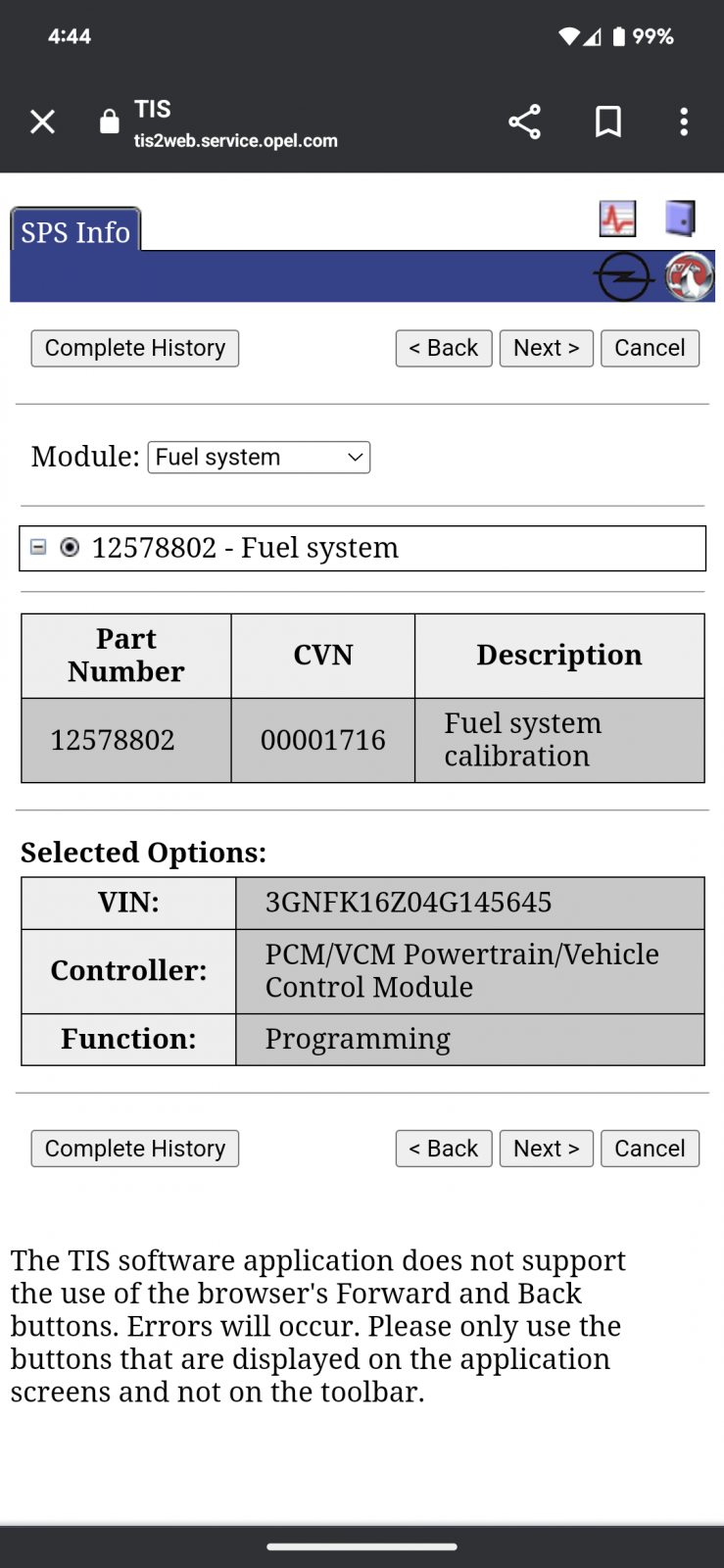

Right I know what your saying. I was just saying the PCM in my truck is not the original one and still wears the original vin of the other truck. Because it needs flashed. And here's what searching my vin on tis2web shows.
That page just shows available updates, you'd need a tech2 or PCM Hammer with VCX Nano to see what is actually flashed to the PCMs.
Yeah I'm looking into one. But either the dealer or a local shop with the proper software can flash the PCM to my truck and apply the updates at the same time.
