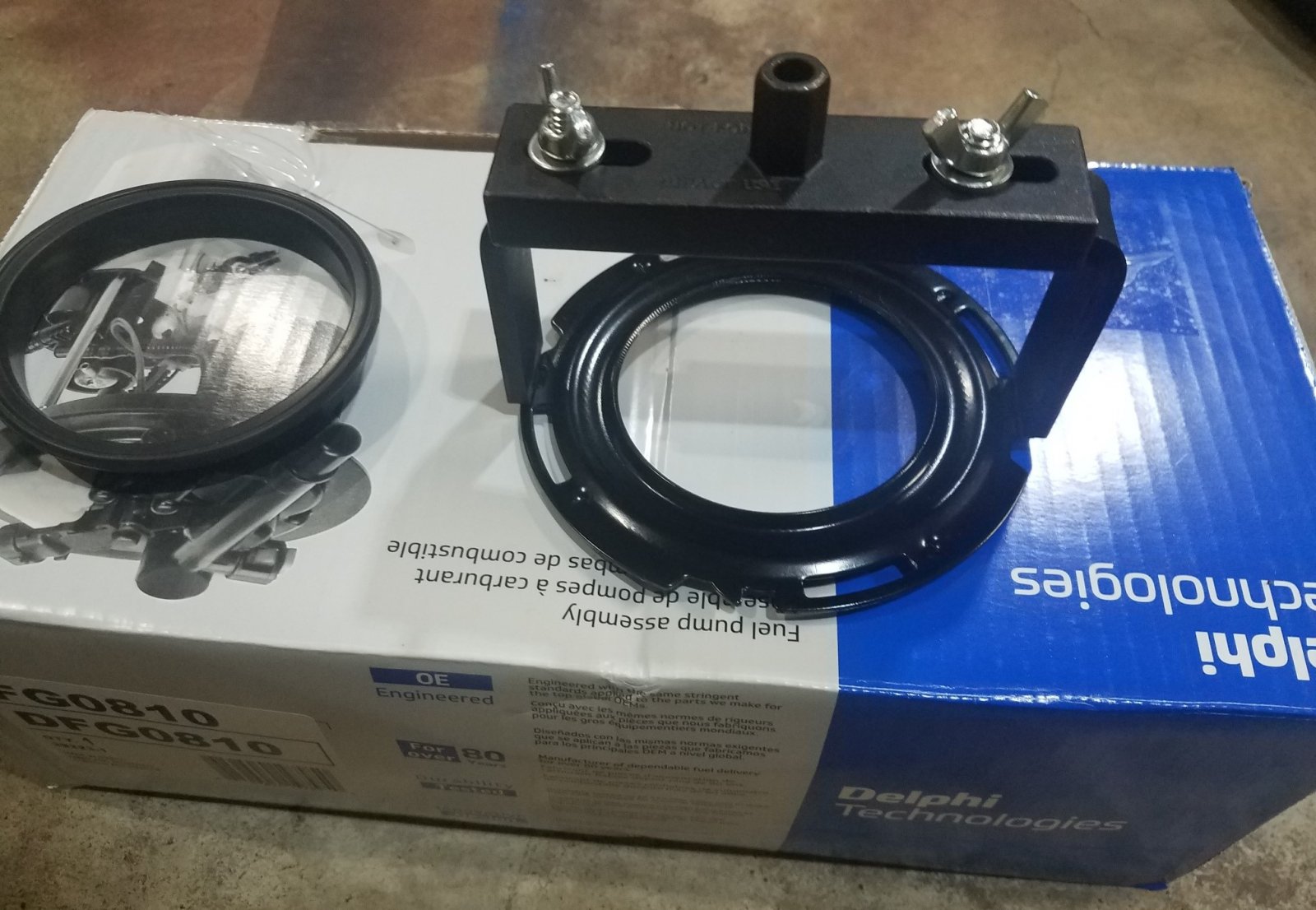

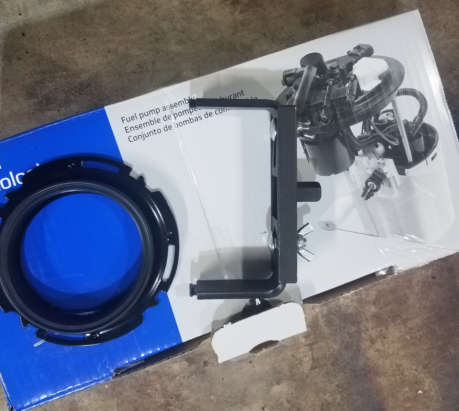

I went with the delphi pump this time. It was delivered yesterday.
